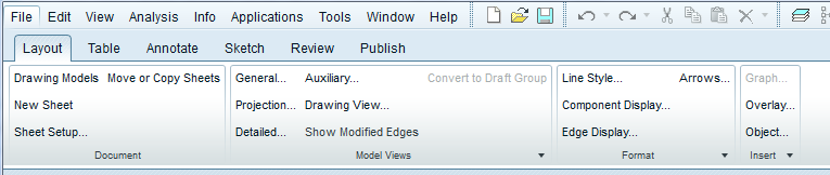

The ribbon tabs are KILLING me. I keep clicking on things and then having to remember, "Oh Gee, I wonder what tab THAT command is under?". Plus, the wasted real estate up at the top of the screen is absurd. Most of these tabs use less than HALF the space allocated for the ribbon, PLUS you still have the menu on the top. what a waste of space. And minimizing the ribbon simply means that the 3 or 4 line status bar is now covered up when the ribbon comes to the front.
And, one nice thing you USED to be able to do when editing a large set of dwg notes, was the ability to just click in the field of the dwg to have the notes on the dwg sheet update to what the editor had to check for clearance with views. This is now gone. You click in the field of the dwg, and it wipes out ALL your changes. So now, you have to keep hitting "Ok" and getting out of the editor, and back in. Before you could do it on the fly. Totally maddening.
I guarantee, if PTC hired any of us experienced users to redefine the GUI (Grotesque User Interface), almost EVERYONE would like it. New AND old users.
Jan 24, 2012 7:19 PM UTC
Those tabs make we want to throw things. And for this reason in particular:
For example, right mouse button on a view brings up certain options, but those options are not always available if you are on the "wrong" tab. This would be ok if RMB brought different tab context options for different tabs, but it doesn't. See the attached PDFs. I can right click on a view and create a projected view off of it without going to the ribbon, but only if I am in the Layout tab. But .... it's not like there are other possible RMB functions that you might want while selecting a view with, say, the Sketch Tab selected. If I am in Sketch Tab, then I am not going to accidentally sketch a line by RMB on the view.
Similar things occur with other mouse selection functions. I can select and move a dimension, but only with the Annotate Tab on. If selecting that dimension produced a different and undesirable result with a different tab on then I could see why it should only be selectable in the Annotate Tab. But it doesn't!
Does what I'm saying make sense to anyone else? There are other situations where this is even more egregious, but I can't recall them off the top of my head. Next time I encounter one, I will post it here.

Hi Grahame...
Yes, yes... I feel your frustration! What PTC was trying to do was to give you "tab context" operations on your right mouse button. That's why when you're on the Annotate tab, you have things like "Custom Symbol" on your RMB. That would be the appropriate tab to be able to drop a new symbol, right?
I agree they missed the goal... wide and to the left ($&#%$^&**!@ Billy Cundiff !! ). Sorry, Ravens reference.
Anyway as I was saying... they missed the goal a little but that's what they were going for. However, there is a bit of hope for you. Read the response I sent to Frank below. AND remember the ALT trick!! You can move a view, dimensions, notes, or symbols from ANY TAB if you hold the ALT key. Hold ALT and you'll be able to pick a dimension and move it no matter what tab is active.
Also... notice when you hit ALT, letters will pop up underneath all the tabs. These are hotkeys. Try using some of them to regain lost speed. I know its a tough slog to get through the first week or so... but really if you push through it you should be able to recover.

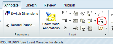

Jan 31, 2012 5:23 PM UTC
"BREAK" tool is circled in red.
What did you find in the Sketch tab that would break extension lines?
Patriot_1776
Jan 31, 2012 6:14 PM UTC
Ok, I see it now. Thanks. Makes it a little easier, but icons still suck. I'm still going to stay on WF4 since in my professional opinion it's much better.
