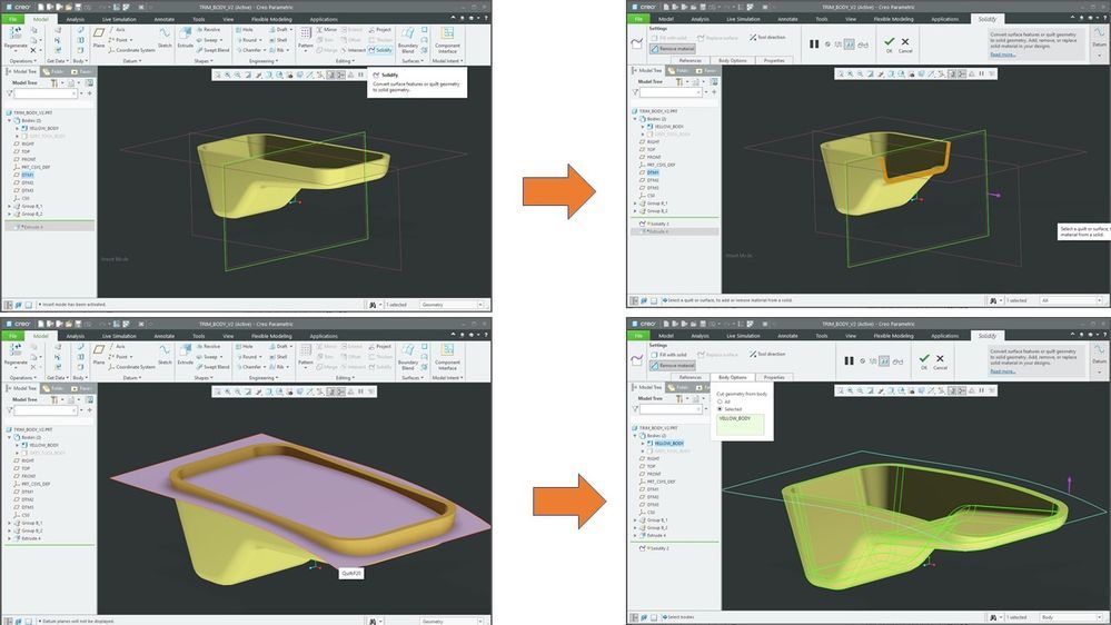

#1) How can I trim a body by a datum, surface, quilt etc?
I have heard this question several times, as there is no “Trim Body” tool currently in Creo Parametric 7.0.
Still, we do have other tools that you can use to trim body geometry.  If you want to trim a body by a datum, surface, quilt, this is the “Solidify-Tool” with the “Remove Geometry” option.
Here are two examples how that would look like. Two hints if you want to try it:
  1. Set the body that you want to trim as default body. This saves you from needing to access the body options panel in the feature
  2.  Pick the trimming object first to get access to the solidify featureimage

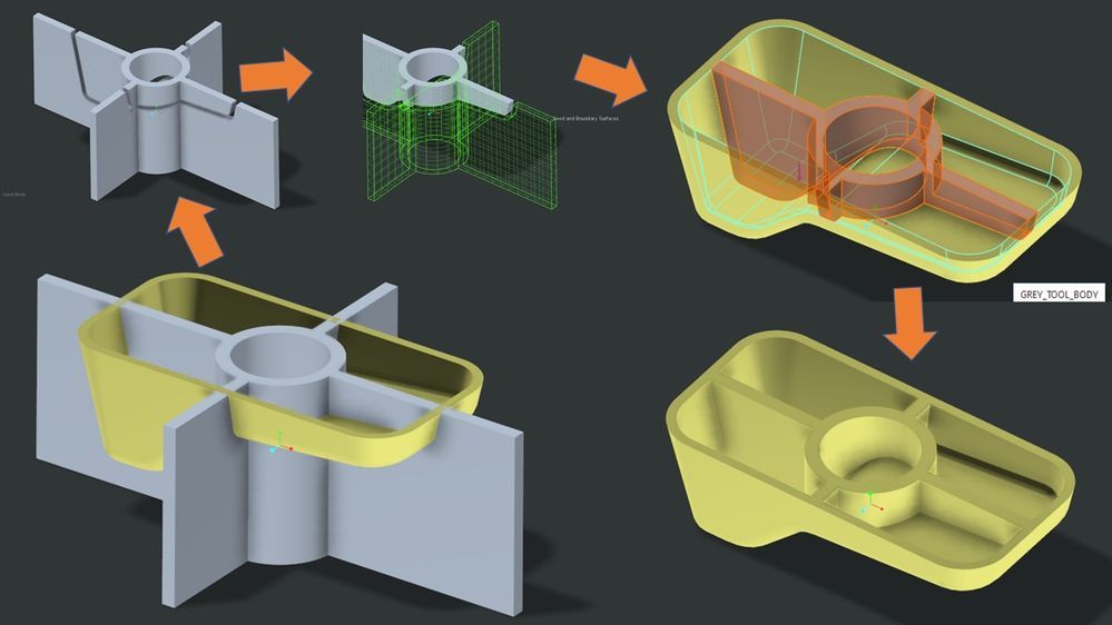

#2) How can I trim a body by another body?
This is often useful to perform Boolean operations with a trimmed “modifying body”. Here is an example of that where you might want to trim a “library-type”/”standard-type” grey tool body to only merge its upper half to the yellow plastic part.
The most robust flavor of this might involve body split and body remove, but there are actually several more workflow flavors on how to achieve the above with mostly 3 steps.
If you are interested in seeing all of different ways to achieve the result, watch a quick 6mins movie of that here:

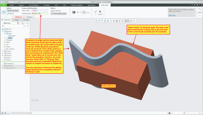

Speaking of pre-trimming a body before the boolean operations, would it be useful to have the option of spliting a body by another body?
I saw that the spliting object can be a plane, or a single quilt, and the quilt can be automatically extended (if it's an analytical surface, I guess). which is a nice feature. Would it also be possible to use another body as a trimming object? It could be used also as a pre-trim before the standard boolean operations. The only restrigtion for the split to qork, is that the triming body mus completely encompass the body to split.
Speaking of the Split Body command, are there any roadmap plans for a future release to allow the "Splitting Object" to contain more than a single quilt?
June 26, 2020
yes, these are potential enhancements, but no concrete plan yet - will depend on relative priorities and how many users and use cases ask for it.

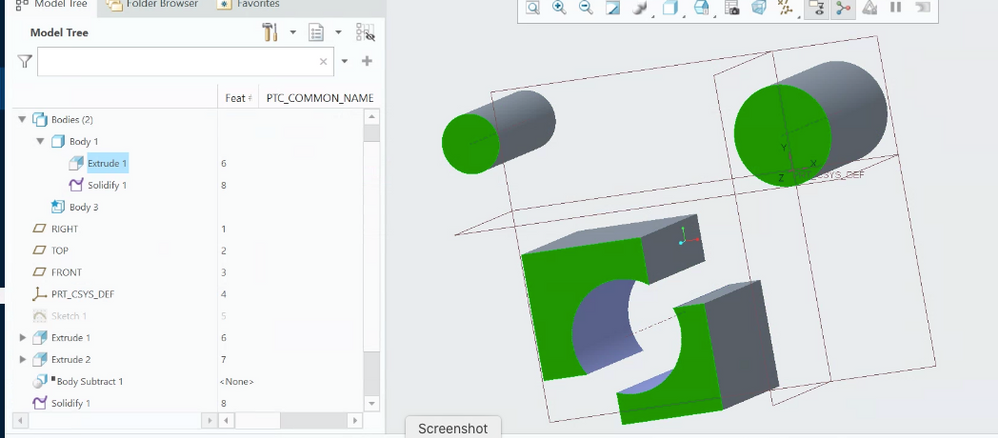

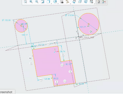

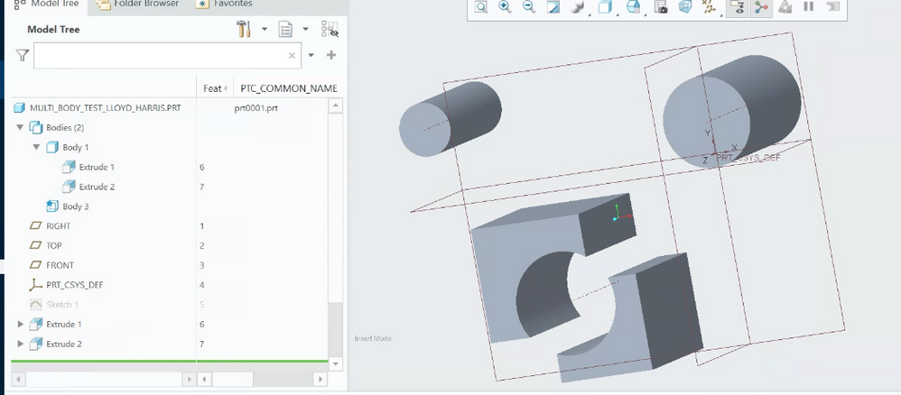

1. When creating a sketch with multiple distinct closed geometry segments, then creating a solid feature; Creo creates a single body with multiple solids, SW creates multiple bodies with individual solids.  Creo defaults to a body to have multiple non-intersecting solid geometry. SW defaults to ensure all non-intersecting solids to be independent bodies.
2. From the above scenario, when modifying solid geometry within an existing body to break it down into further distinct non-intersecting solids [through a simple cut/remove feature], as above Creo keeps all the new solids within the existing body, where as SW implicitly [automatically] creates additional bodies to keep the individual solids in distinct bodies.
[extrude 2 being the cut in the below image]
imageextrude 2 cut
3. the same above applied to a "solidify" option using a quilt, or using boolean operations to remove material.a single Creo body is left. extrude 2 changed to a surface and then solidified in image
4. Finally the split function only works for a single volume at a time, there is no bulk split option either using features or volumes to break-out all distinct non-interesting solid goes into the own bodies.
