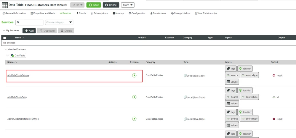

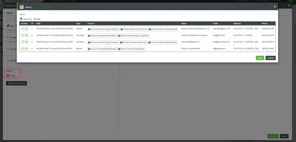

  1. Open the Fizos.Customers.DataTable Data Table and go to the services tab.
  2. Open the AddDataTableEntries service to be executed. This service will allow us to create some general data to work with. You can create as many as you like for this test. Click the values parameter to start creating entries.
  3. After clicking + Add, and enter data for customers. Try to add at least 1 Factor data tag for each customer.
  4. Save your entry and create a second entry with any location and tags you like. We aren’t adding vehicles as of yet, but we will in the next section.
  5. After saving, don’t forget to execute the service with the two entries saved. If you did it correctly, the values parameter of the service, should show at least 1 inside of the parentheses. See below for an example:

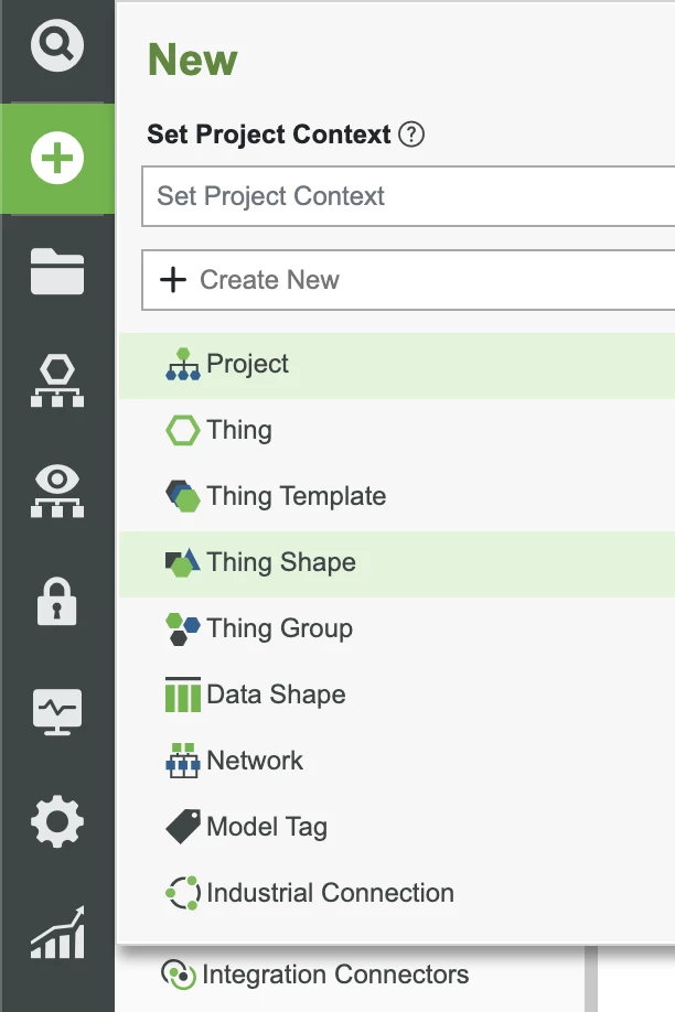

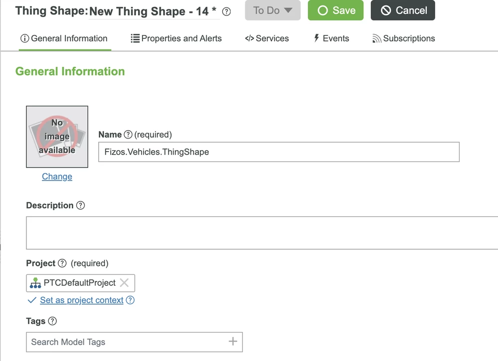

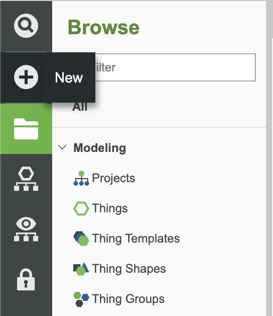

  1. In the ThingWorx Composer, click the + New in the top left of the screen.
  2. Select Thing Shape in the dropdown.
  3. In the name field, enter Fizos.Vehicles.ThingShape and select a Project (ie, PTCDefaultProject). This Entity will have Services implemented by all types of vehicles.

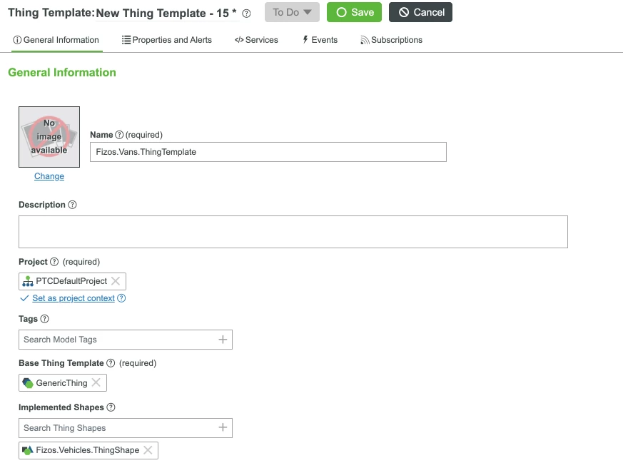

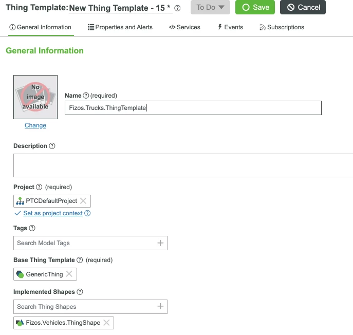

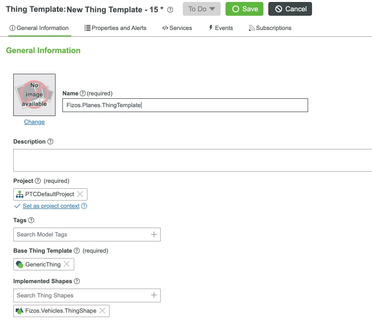

  4. Save your changes and create three Thing Templates which implement this Thing Shape. See below for examples:
Fizos.Vans.ThingTemplate: These are smaller vehicles used to make short or last step deliveries.
Fizos.Trucks.ThingTemplate: These are trucks of different types making larger deliveries.
Fizos.Planes.ThingTemplate: These are planes used to deliver products to long distance locations.

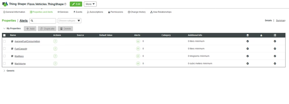

  1. Open Fizos.Vehicles.ThingShape and go to the Properties tab.
  2. Create the following list of Properties. These properties are the generic concepts for a vehicle that can deliver a package.
    NameBase TypeAspectsDetails
    FuelCapacityNumber0 minimum, unit: literslogged, persistent
    AverageFuelConsumptionNumber0 minimum, unit: literslogged, persistent
    MaxMassNumber0 minimum, unit: kilogramslogged, persistent
    MaxVolumeNumber0 minimum, unit: cubic meterslogged, persistent
    CurrentLocationLocationN/Alogged, persistent
    CurrentOrdersInfoTable(Fizos.Orders.DataShape)N/Alogged, persistent
    Your properties should look like the following:

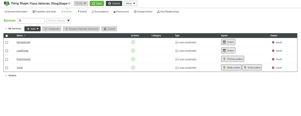

  3. Inside the Fizos.Vehicles.ThingShape entity, go to the Services tab.
  4. Create the following list of Services. These services are also generic in nature and are based on the concept of a vehicle going to a pick up location, goods being loaded onto the vehicle, the vehicle traveling to a destination, then delivering goods.
    NameInputReturn TypeOverrideAsyncDescription
    PickUpGoodsPickUpLocation: LocationNothingYesYesGo to a pickup location (factory or otherwise), and pick up goods.
    LoadGoodsOrders: InfoTable (Fizos.Orders.DataShape)NothingYesYesPerform the task of loading goods onto a vehicle (adding rows to the CurrentOrders property)
    TravelDestination: LocationNothingYesYesTravel for destination A to destination B
    DeliverGoodsOrders: InfoTable (Fizos.Orders.DataShape)NothingYesYesPerform the task of unloading goods at a current location
    As you can see, the goods are orders. In a real world environment, we would create a separate Data Shape and Data Table for packages to hold a number of orders. We are doing this without the packages Data Table for simplicity in this example. One reason why our products have mass and volume properties is to help with the idea of loading a vehicle and the type of boxes or packaging to use. This could be another way to cut cost.
    Your Services should look like the following:
    new_veh_services.pngThe same way we were able to create a system that was automated, we will create events that will notify subscribers of certain tasks being complete. This way, the next level of service can be performed instantly by our robot army.

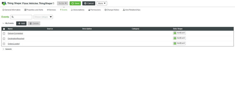

  5. Inside the Fizos.Vehicles.ThingShape entity, go to the Events tab.
  6. Create the following list of events. These Events will connect to a task being completed. For example, when the vehicle has arrived to a location, an Event will be triggered and thus the next task can begin. For a bit more automation, add an Event you might think is needed, like when fuel is needed in the vehicle.
NameData ShapeDescription
DestinationReachedAlertEventThis alert is fired when the vehicle has reached a location (whether for delivery or pickup).
OrdersLoadedAlertEventThis alert is fired when all orders have been loaded onto a vehicle.
DeliveryCompletedAlertEventThis alert is fired when the vehicle has completed a delivery. This delivery might have been the last order delivery and vehicle needs to head back for more orders to be picked up.
