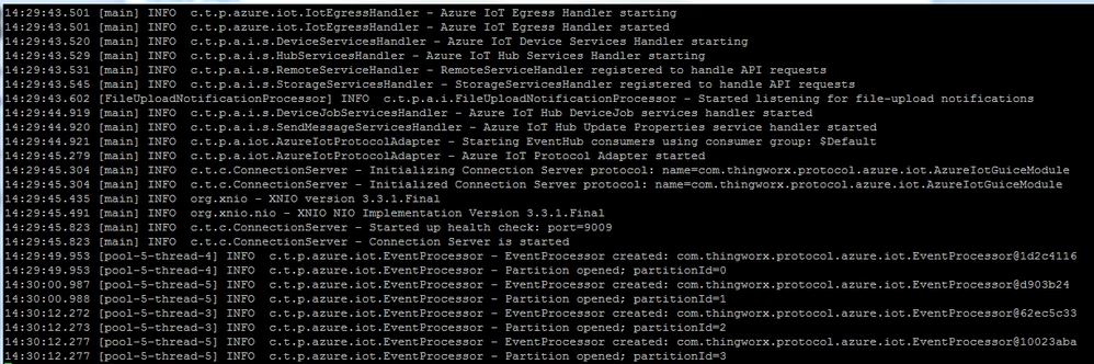

  5. The Connection Server should start with no errors or stack traces displayed. If the program ends, check the following:
    • Java version is 1.8.0, update 92 or greater and is Java(TM) not OpenJDK

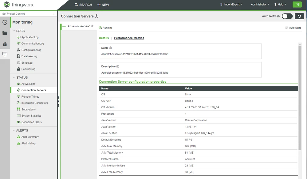

  6. In ThingWorx Foundation click the Monitoring tab then click Connection Servers. You should see a server named azure-iot-cxserver-{server-uuid}, where {server-uuid} is a unique identifier that is assigned automatically to the server.

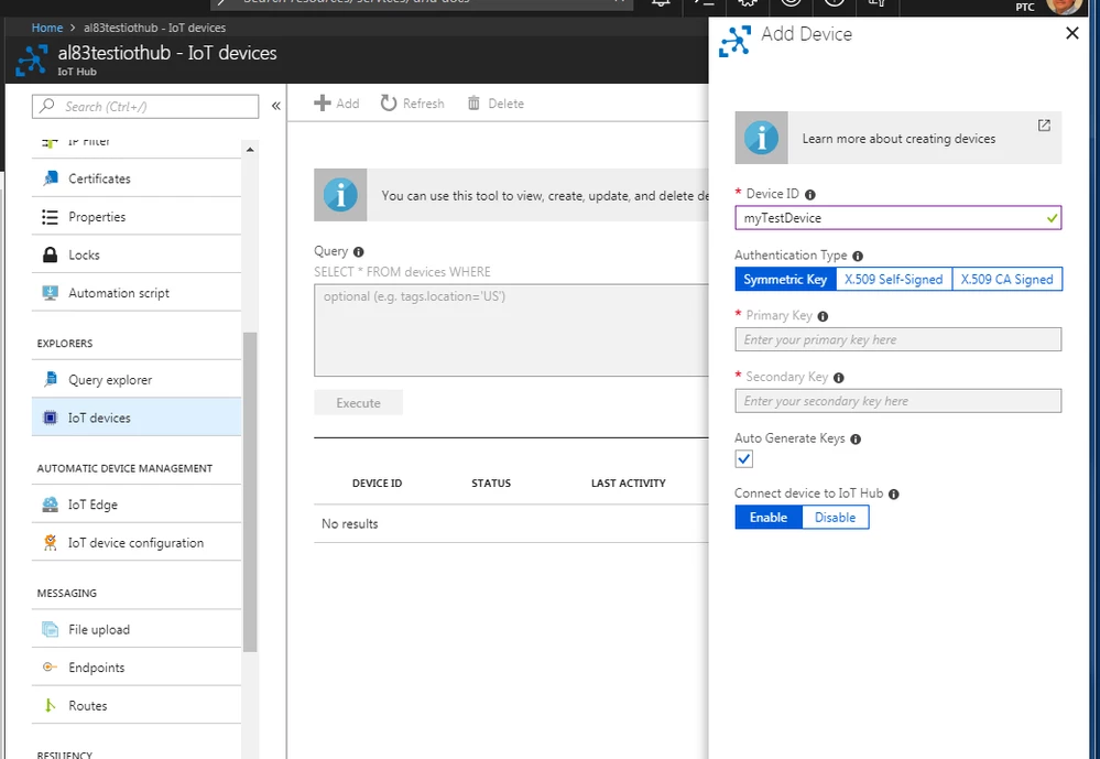

  1. In your Azure Portal, click All Resources, then select the name of your IoT Hub.
  2. Under Explorers click IoT devices, then click + Add.
  3. Enter a name for your device, then click Save
  4. When the device name appears in the list it is ready to us

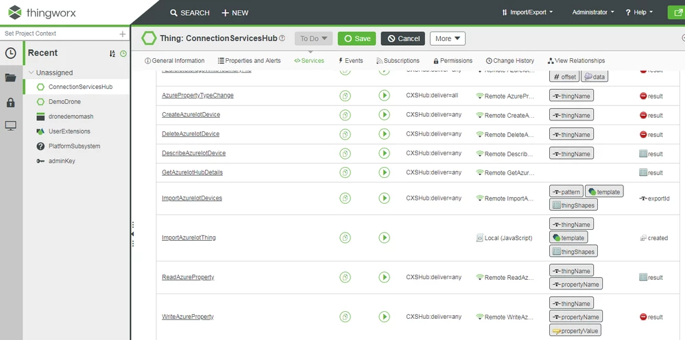

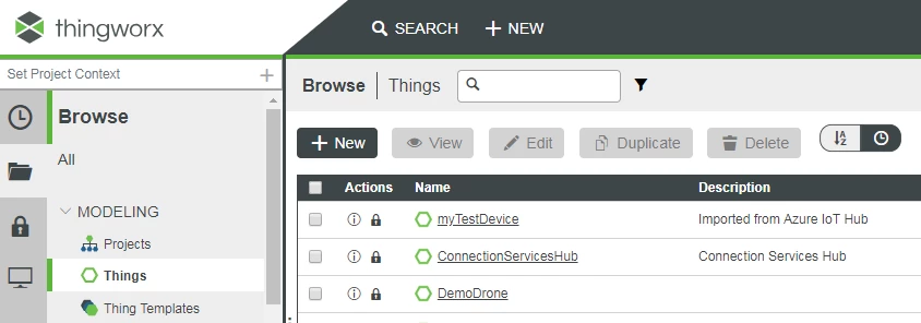

  1. In ThingWorx Composer, navigate to the ConnectionServicesHub Thing.

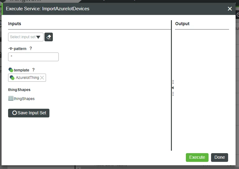

  2. Click Services tab and scroll to the ImportAzureIotDevices service and click the execute Arrow.
    NOTE: The * in the pattern field will act as a wildcard and import all devices, you can enter a string to match that will only import a subset of all available devices.
  3. Click Execute to import the devices then click Done.
  4. Click Things in the left column to see the Things that were created.

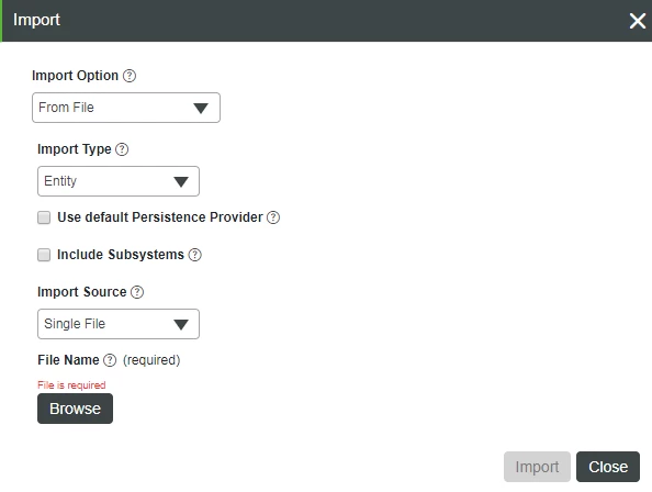

  1. In ThingWorx Composer, click Import/Export menu, then click From File and browse to ../demo/edgedevice- demo/platform/entities/CPUDemo_AllEntities.xml
  2. Click Import then click Close when the import successful message is displayed.

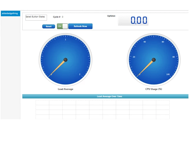

  3. Return to the ThingWorx Composer and open the Properties page of the Azure Thing that you created previously.
  4. Click the refresh button to see the properties change every five seconds.
  5. Open the azure-iot-demo Mashup and view the Load Average and CPU gauges, and the increases in the values of the Cycle and Uptime fields.
