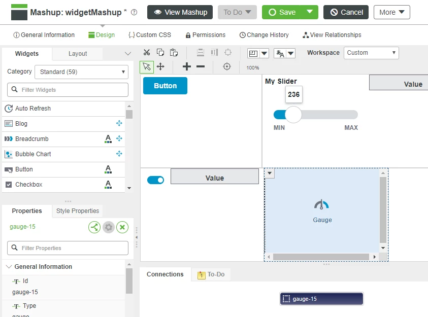

  2. Drag-and-drop the Gauge widget onto the bottom-center container.

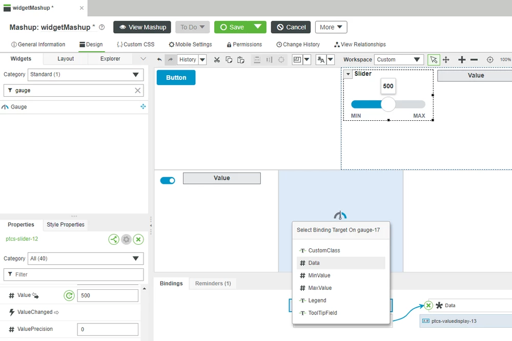

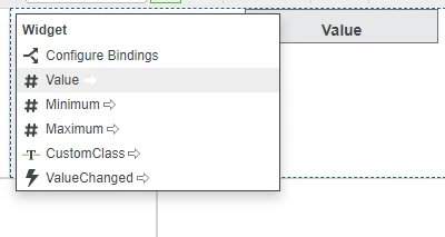

  3. We will now bind the Slider to the Gauge. Click the Slider Widget in the top-right Container.
  4. Click the drop-down arrow on the left side of the Slider widget.
  5. Click and drag the Value property listed in the Slider drop-down onto the Gauge widget.IoTProductMgmt_21-1658761869162.png
  6. Click the # Data property that is available from the Select Binding Target pop-up.IoTProductMgmt_22-1658761869165.png
  7. Click Save to save your Mashup.

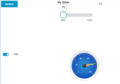

  8. Click View Mashup then adjust the slider to the left to see the changing value shown on the widget.

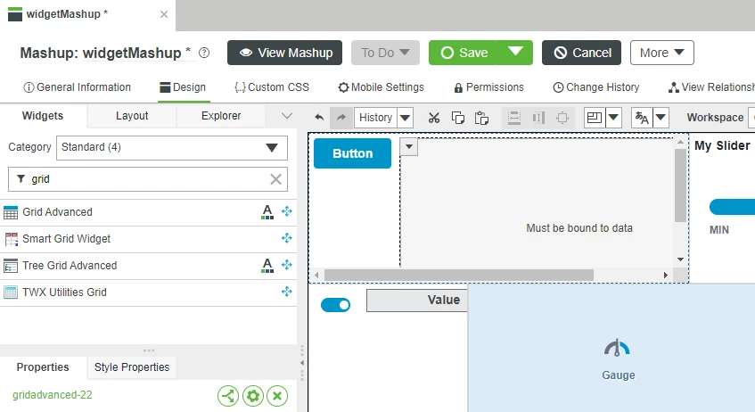

  1. Select the Widgets tab in the uppper panel of the left dock, then enter grid inside the Filter field in the top-left.
  2. Drag-and-drop the Grid Advanced widget onto the top-left container on your Mashup that already has the Button Widget.

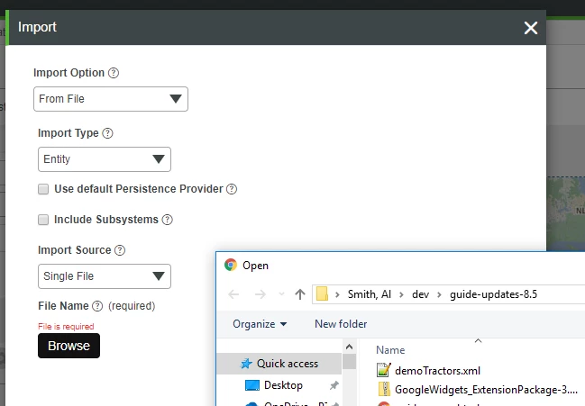

  1. Download the attached demoTractors.xml.
  2. Click Import/Export in the lower left of Composer, then select ImportIoTProductMgmt_25-1658761869182.png
  3. Click From File in the drop down, then Browse.
  4. Browse to the demoTractors.xml file and click Open.
  5. Click Import, then Close after entities are successfully imported.

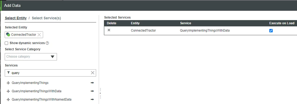

  6. Click the green + button in the Data tab on the right side of the Mashup Builder window.

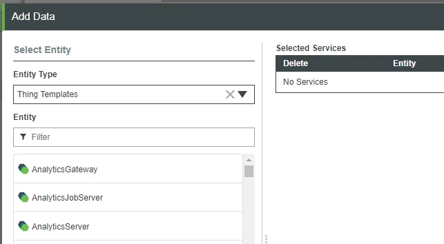

  7. In the Select Entity panel click Thing Templates from the drop down.IoTProductMgmt_26-1658761869183.png
  8. Scroll through the available Thing Templates and select the Connected Tractors Template that was imported.
  9. Enter query into the filter text box then click the arrow to the right of QueryImplementingThingsWithData.
  10. Click the Execute on Load check box, this option will execute the QueryImplementingThingsWithData Service when the Mashup is loaded.IoTProductMgmt_27-1658761869184.png
  11. Click Done.

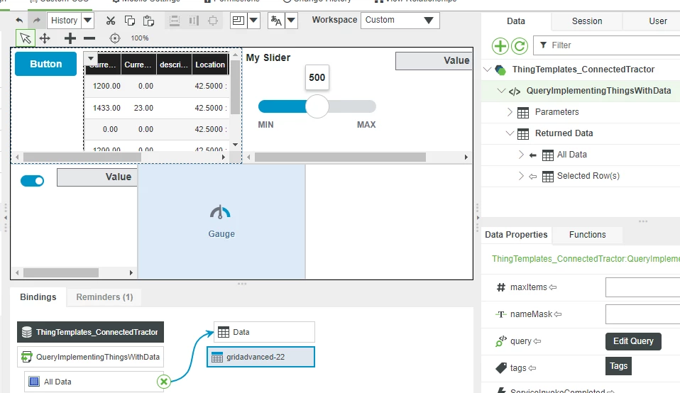

  12. Click the arrow icon to expand QueryImplementingThingsWithDate, and Returned Data.

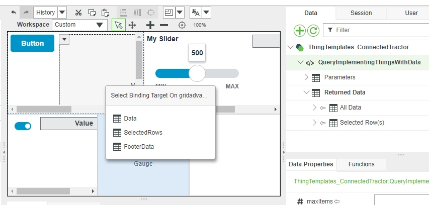

  13. Click and drag All Data onto the Grid widget.IoTProductMgmt_28-1658761869186.png
  14. Click Data in the Select Binding Target pop-up.IoTProductMgmt_29-1658761869190.png

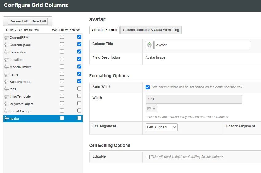

15. Click the drop down in the upper left of the Grid widget, then click Configure Grid Columns to show the Configure Grid Columns pop-up.
16. Uncheck the check box next to the property names in the left-hand panel that you don't want shown in the Grid.
NOTE: You can drag and drop the property names to change the display order. You can customize Column names and formatting by making changes in this window.
17. Click Done when you are satisfied with the column formatting options.

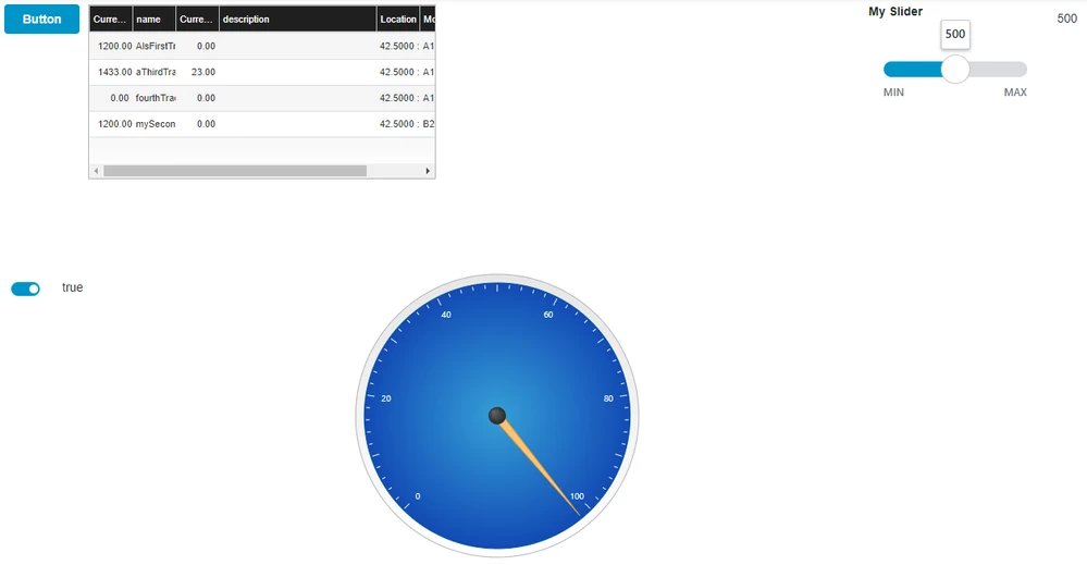

19. Click View Mashup.
