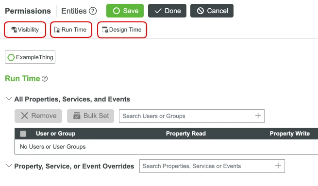

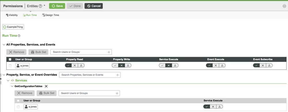

Add Permissions for an Entity
  1. Once an Entity has been selected for editing, select the Permissions tab.
  2. Based on what you would like to edit, select the VisibilityDesign Time or Run Time tab.
The All Properties, Services, and Events section provides blanket security to all of these features for a User Group or User. The Property, Service, or Event Overrides section is used for any overrides that need to be made for specific features. In the example blow, the User a.jones has the ability to read properties, fire events, and subscribe to events. The User does not have the ability to update a property or execute a Service. In the second section, a.jones is allowed to call the GetConfigurationTable Service (even though he was restricted from doing so in the other section).
To set a permission, filter and select a User/User Group. When their name is in the table, click the Permission Type you would like for this Entity. Default permissions are added to the User or User Group you filtered and selected. This will be full access permissions unless you've changed one of the fields.

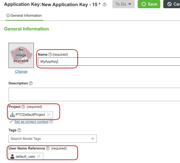

Create an Application Key
Using the Application Key for the default user (Administrator) is not recommended. If administrative access is absolutely necessary, create a user and place the user as a member of the SecurityAdministrators and Administrators user groups. Create the User the Application Key will be assigned to.

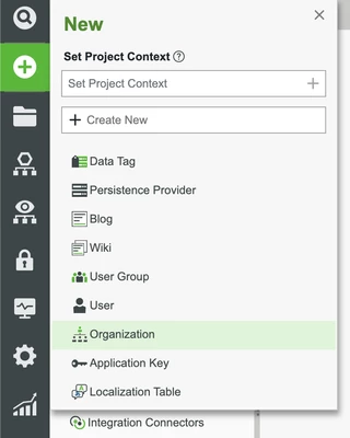

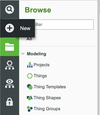

  1. On the Home screen of Composer click + New.
  2. In the dropdown list, click Applications Keys.

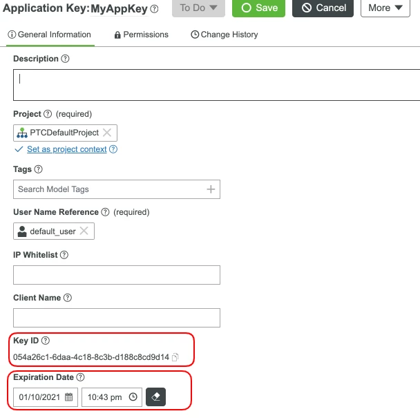

  3. Use MyAppKey  for the name your Application Key.
  4. Set the User Name Reference to a User you created and set the Project field (ie, PTCDefaultProject).
  5. The Expiration Date field will default to 1 day.
  6. Click Save. A Key ID has been generated and can be used to make secure connections.

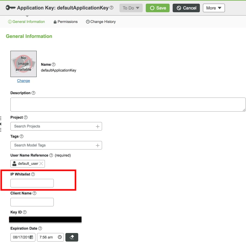

IP Whitelisting for Application Keys
One of the features of an Application Key is the ability to set an IP whitelist. This allows the server to specify that only certain IP addresses should be able to use a given Key ID for access. This is a great way to lock down security on the platform for anything that will maintain a static IP address.
For example, connected Web-based business systems may have a static IP from which all calls should be made. Similarly, you can use wildcards to specify a network to narrow the range of IP addresses allowed while still offering some flexibility for devices with dynamic IP addresses.
Extremely mobile devices should likely not attempt to implement this however as they will often change networks and IP addresses and may lose the ability to connect when the IP whitelist feature is used.

  1. In the ThingWorx Composer, click the + New at the top of the screen.
  2. Select Organization in the dropdown.

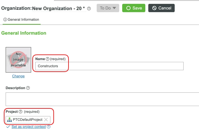

  3. Name your Organization Constructors.
  4. Set the Project field (ie, PTCDefaultProject) and click Save

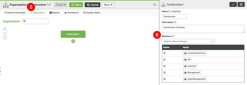

  5. Select the Organization tab to see the hierarchy.
  6. With the top organization selected, in the Members search bar, search for the user you have created yourself and add them.

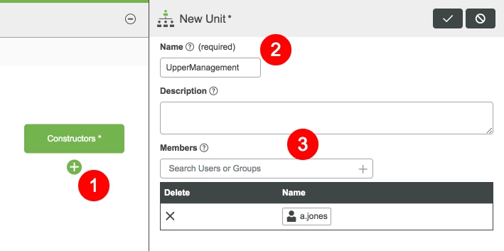

Create Organizational Units
  1. Click the green + under the structure you would like to expand.
  2. Name your Organization unit UpperManagement.
  3. In the Members search bar, search for the user or user group you created and add it.
  4. Click Save.
Repeat the steps to create the full heirarchy of the organization and its department/unit members.

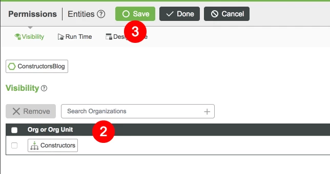

Setup Entity Visibility
ThingWorx provides added security checks and access control with Entity visibility. Visibility ensures an entity is accessible to members of an organizational unit. Those members will then have access to the entity and the underlying security model determines what specific interaction any users that are members of that organization unit may have with a specific asset.
If a user in the system is not granted visibility, then that asset essentially does not exist within that user’s domain.

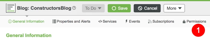

  1. Select the Permissions tab of any custom Thing in Composer.
  2. Filter and select Constructors in the Search Organizations field.
  3. Click Save.
