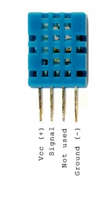

The DHT11 and DHT22 digital temperature and humidity sensors are inexpensive and available from several sources:
The Raspberry Pi does not come with any built-in analog to digital conversion capability and because these sensors are digital they can be interfaced easily with a Raspberry Pi. We will be using a Python library developed by Adafruit that simplifies interfacing with these sensors.

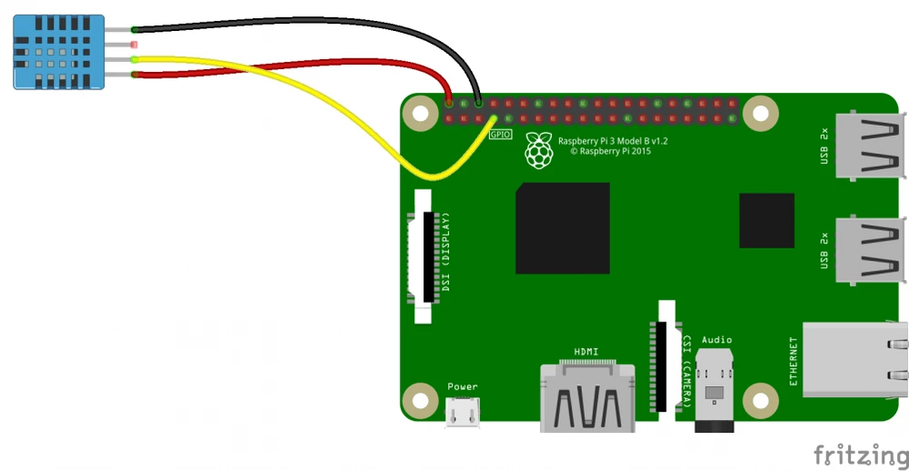

  1. Power down the Raspberry Pi before making any wire connections. To prevent any flash memory corruption, enter the command shutdown -h now then wait a few seconds for it to complete before disconnecting the power supply.
  2. Use female-to-female jumper wires to connect the sensor as shown below. The black wire is connected to ground, the red wire is 5v or VCC, and the yellow wire carries is the digital signal.
WARNING: Double check your connections before applying power. Mistakes can destroy the sensor and the Raspberry Pi!
3. Apply power and boot the Raspberry Pi.
4. Change into the EMS directory:
cd microserver
5. Test the sensor with this commmand:
./Adafruit_Python_DHT/examples/AdafruitDHT.py 11 4
In a few a seconds the current temperature and humidity will be displayed.
  • Change the 11 parameter to 22 if you are using the DHT22 sensor.
  • The 4 parameter is the GPIO pin number of the Raspberry Pi that is conneCted to the sensor's signal pin. This command is the same command the luaScriptResource will use to get temperature and humidity readings.

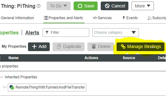

Update Properties of PiThing
  1. Log onto ThingWorx Foundation server.
  2. Click on the Home icon in Composer then broswse to Things > PiThing > Properties and click Manage Bindings button.
  3. Click on the Remote tab, then drag and drop the temp and humidity Properties one at a time to the green plus sign next to Create new Properties.
  4. Click Done to close the binding window, then click Save.
NOTE: The temp and humidity Properties will be updated every 30 seconds.
