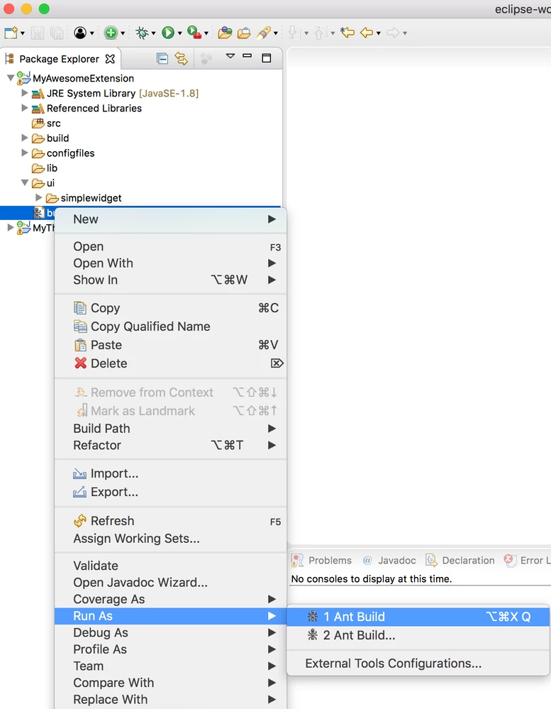

Build Extension with Ant
  1. Go to the Package explorer view.
  2. Right click on build-extension.xml.
  3. Hover over Run As and select Ant Build.
  4. Your console output will indicate BUILD SUCCESSFUL. This will build your project and create the extension zip in the your_project->build->distributions folder of your project.

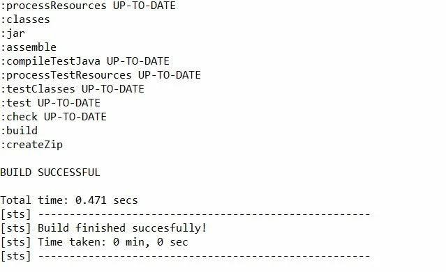

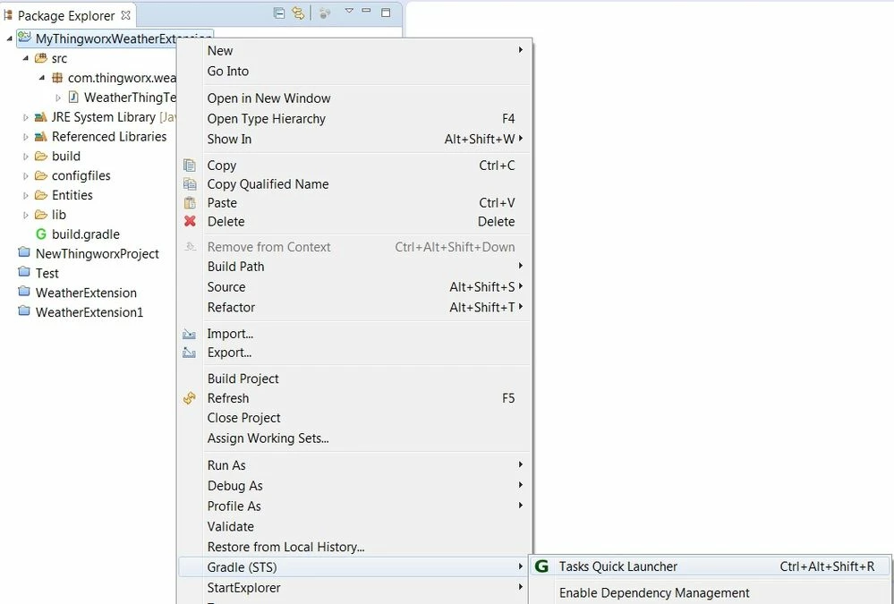

Build Extension with Gradle
  1. Right click on your project ->Gradle (STS)->Tasks Quick Launcher.
  2. Set Project from the drop-down menu to your project name and type Tasks as build.
  3. Press Enter.
  4. Your console window will display BUILD SUCCESSFUL. Your extension has been created and stored as a zip file in your_project->build->distributions folder.

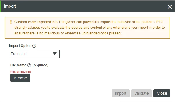

Import Extension
  1. Go to ThingWorx Composer. In the lower left, click Import/Export, then select Import under.
  2. Select Extension for the type of import.
  3. Choose the zip file in the distributions folder under the build directory. Click Import.
  4. Click Close on the prompt to refresh your Composer instance.
After you have imported your new widget and refreshed Composer, you will see your new widget as an option on the Mashup Design tab.
