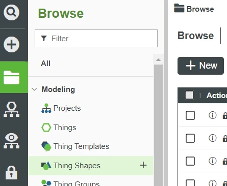

  1. Start on the Browse folder icon of ThingWorx Composer.
  2. Under the Modeling section of the left-hand navigation panel hover over Thing Shapes, then click the + button.

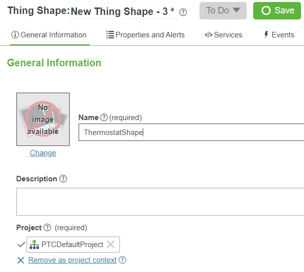

  3. Type ThermostatShape in the Name field.
  4. If Project is not already set, click the + in the Project text box and select the PTCDefaultProject.
  5. Click Save.

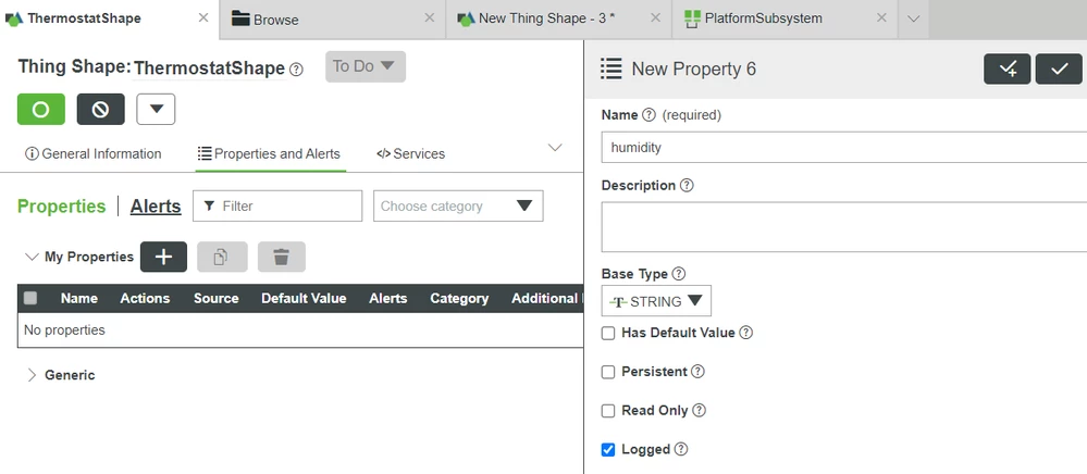

Step 2: Add Properties to Thing Shape

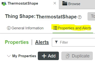

  1. Click Properties and Alerts tab at the top of your Thing Shape.
  2. Click + Add.
  3. Enter the Property name in the Name field as shown in the table below.
    Name Base     Type           Persistent?       Logged?
    humidityNUMBER X
    messageIdSTRINGX
    temperatureNUMBER X
  4. Select the appropriate Base Type from the drop-down menu.
  5. Check Persistent and/or Logged according to the table.
    NOTE: When Persistent is selected, the property value will be retained during a system restart. Properties that are not persisted will be reset to the default during a system restart. When Logged is selected, every property value change will be automatically logged to a specified Value Stream.
  6. Click Check +.
    TIP: When adding multiple properties at once, click Done and Add after each, once you've entered a Name, selected a Base Type and any other criteria. If adding a single property, click Done.
  7. Repeat steps 4 through 6 for each of the properties in the rows of the table.

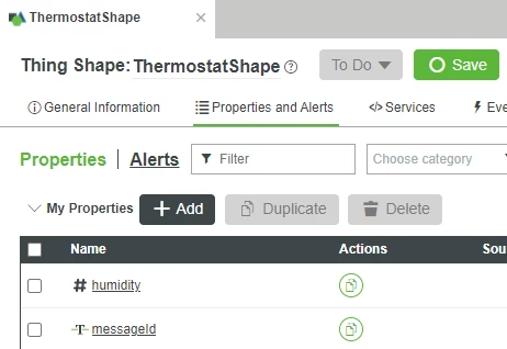

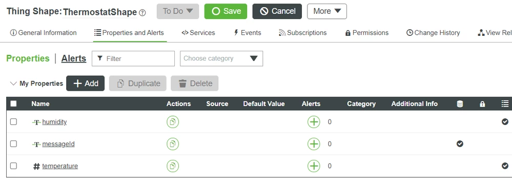

  8. Click the done Check. You'll see that these Properties have been created for the ThermostatShape.
  9. Click Save.
