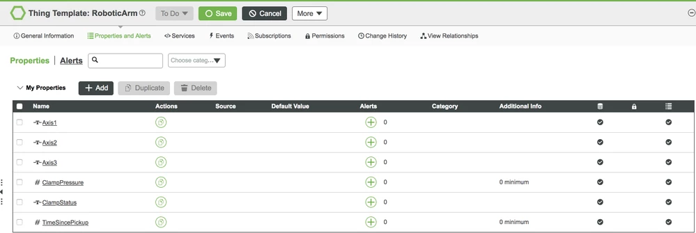

Robotic Arm Properties
The properties for the RoboticArm ThingTemplate are as follows:
Name
Base Type
Aspects
Data Change Type
TimeSincePickup
NUMBER, Min Value: 0
Persistent and Logged
ALWAYS
Axis1
String
VALUE
Axis2
String
VALUE
Axis3
String
VALUE
ClampPressure
ALWAYS
ClampStatus
String
ALWAYS
Your properties should match the below configurations.

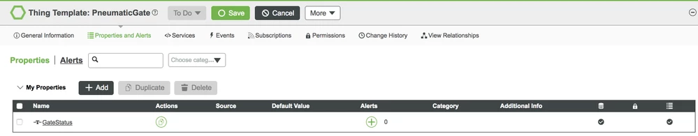

Pneumatic Gate Properties
The properties for the PneumaticGate ThingTemplate are as follows:
Name
Base Type
Aspects
Data Change Type
GateStatus
String
ALWAYS

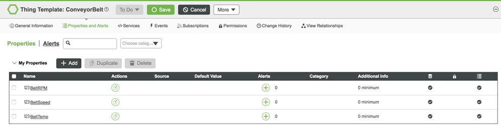

Conveyor Belt Properties
The properties for the ConveyorBelt ThingTemplate are as follows:
Name
Base Type
Aspects
Data Change Type
BeltSpeed
INTEGER, Min Value: 0
ALWAYS
BeltTemp
ALWAYS
BeltRPM
ALWAYS

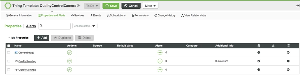

Quality Control Camera
Properties
The properties for the QualityControlCamera ThingTemplate are as follows:
Name
Base Type
Aspects
Data Change Type
QualityReading
ALWAYS
QualitySettings
String
ALWAYS
CurrentImage
ALWAYS

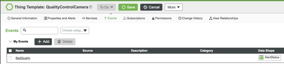

Event
Create a new Event named BadQuality. Select AlertStatus as the Data Shape. Your Event should match the below configurations:

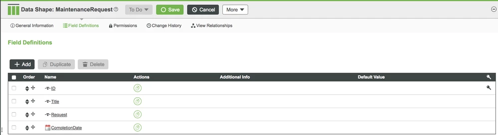

Maintenance Requests DataShape
The maintenance requests DataShape needs to be trackable (unique) and contain helpful information to complete the request. The DataShape fields are as follows:
Name
Base Type
Additional Info
Primary Key
ID
String
NONE
YES
Title
String
NONE
NO
Request
String
NONE
NO
CompletionDate
DATETIME
NONE
NO
Unless you’ve decided to change things around, your DataShape fields should match the below configurations.

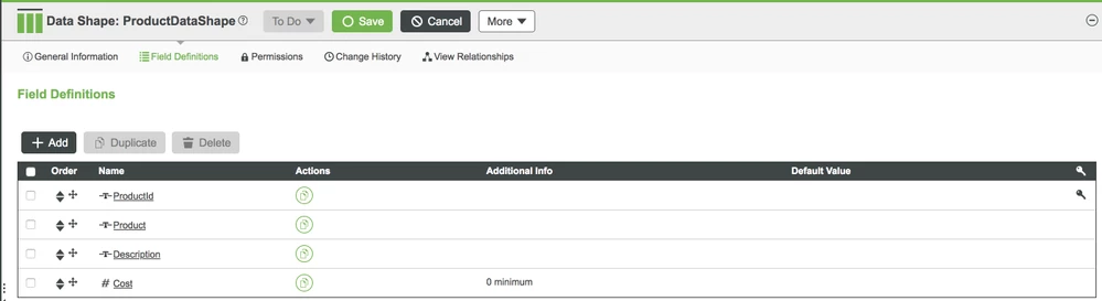

Products DataShape
The product DataShape needs to be trackable (unique) and contain information about the product. The DataShape fields are as follows:
Name
Base Type
Additional Info
Primary Key
ProductId
String
NONE
YES
Product
String
NONE
NO
Description
String
NONE
NO
Cost
NUMBER
Minimum: 0
NO

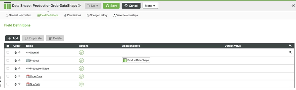

Production Order DataShape
The production order DataShape needs to be trackable (unique), contain information that would allow the operator and manager to know where it is in production, and information to help make decisions. The DataShape fields are as follows:
Name
Base Type
Additional Info
Primary Key
OrderId
String
NONE
YES
Product
InfoTable: DataShape: ProductDataShape
NONE
NO
ProductionStage
String
NONE
NO
OrderDate
DATETIME
NONE
NO
DueDate
DATETIME
NONE
NO

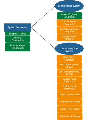

Step 9: SystemConnections Implementation
We have created the ThingTemplates and ThingShapes that will be utilized within our Data Model for creating instances (Things). Before we finish the build out of our Data Model, let's create the Services that will be necessary for the MaintenanceSystem and ProductionOrderSystem Things.
 This guide will not cover the JavaScript and business logic aspect of creating an application. When complete with the below sections, see the Summary page for how to create that level of definition.

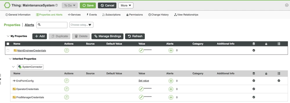

Maintenance System
This is the system managed by the maintenance user and geared towards their needs.
Properties
The properties for the MaintenanceSystem Thing are as follows:
Name
Base Type
Aspects
Data Change Type
 MaintEngineerCredentials
 PASSWORD
 Persistent
 VALUE

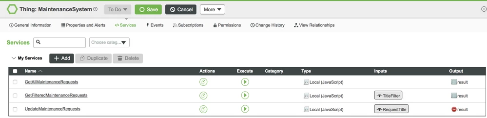

Services
The Services for the MaintenanceSystem Thing are as follows:
 Service Name
 Parameters
 Output Base Type
Purpose
 GetAllMaintenanceRequests
 NONE
 InfoTable: MaintenanceRequest
 Get all of the maintenance requests filed for the maintenance user.
 GetFilteredMaintenanceRequests
 String: TitleFilter
 Get a filtered version of all maintenance requests filed for the maintenance user.
 UpdateMaintenanceRequests
 String: RequestTitle
 NOTHING
 Update a maintenance request already in the system.
 Use the same method for creating Services that were provided in earlier sections. Your Services list should match the below configurations.

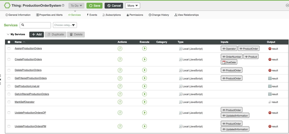

Production Order System
This is the system utilized by the operator and product manager users and geared towards their needs.
Services
The Services for the ProductionOrderSystem Thing are as follows:
 Service Name
 Parameters
Output Base Type
 AssignProductionOrders
String: Operator, String: ProductOrder
NOTHING
 CreateProductionOrders
 String: OrderNumber, String: Product, DATETIME: DueDate
 NOTHING
 DeleteProductionOrders
 NOTHING
 GetFilteredProductionOrders
 InfoTable: ProductionOrder
 GetProductionLineList
 NONE
 InfoTable: ProductDataShape
 GetUnfilteredProductionOrders
 NONE
 MarkSelfOperator
 NONE
 BOOLEAN
 UpdateProductionOrdersOP
 String: ProductOrder, String: UpdatedInformation
 NOTHING
 UpdateProductionOrdersPM
 NOTHING

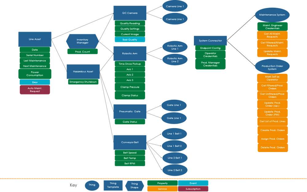

Challenge Yourself
Complete the implementation of the Data Model shown below by creating the Thing instances of the ThingTemplates we have created. When finish, add more to the Data Model. Some ideas are below.
Ideas for what can be added to this Data Model:
 Idea
 1
Add users and permissions
 2
 Add Mashups to view maintenance requests, products, and production orders
 3
 Add business logic to the Data Model
