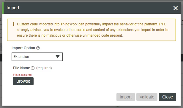

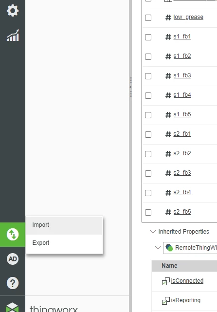

    2. At the bottom-left, click Import/Export.
    3. On the drop-down, click Import.

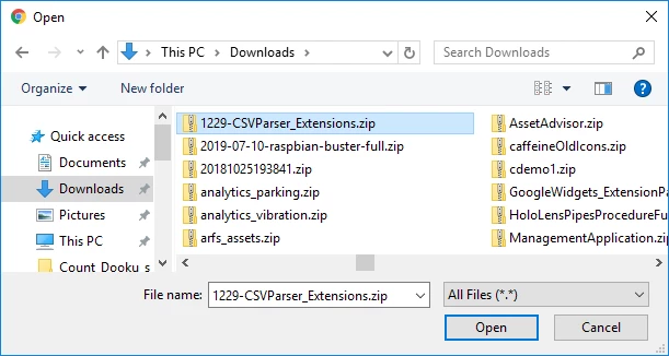

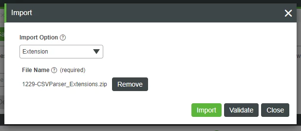

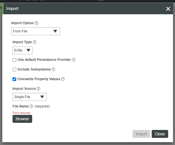

    4. For Import Option, select Extension.
    5. Click Browse and navigate to the extension you downloaded above.
    6. Click Open.

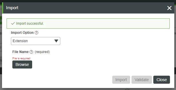

    7. Click Import.
    8. Click Close.

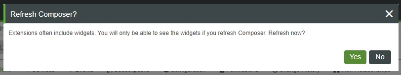

    9. On the Refresh Composer? pop-up, click Yes.

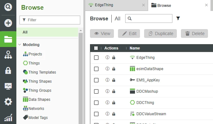

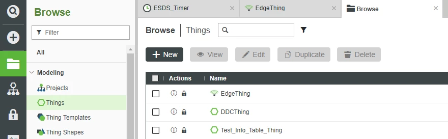

    1. Return to Browse > All.
    2. Click MODELING > Things.

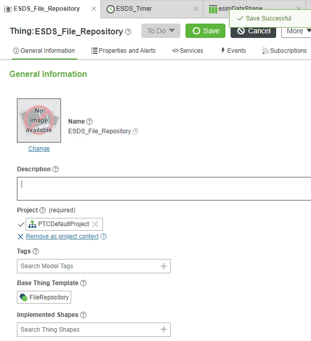

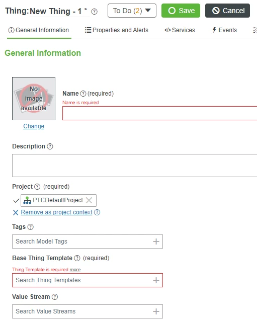

    3. Click + New.

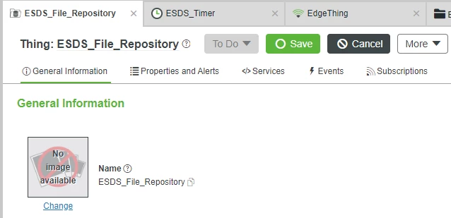

    4. In the Name field, type ESDS_File_Repository.
    5. If Project is not already set, search for and select PTCDefaultProject.

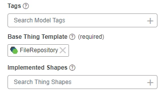

    6. In the Base Thing Template field, search for and select FileRepository.
   7. At the top, click Save.

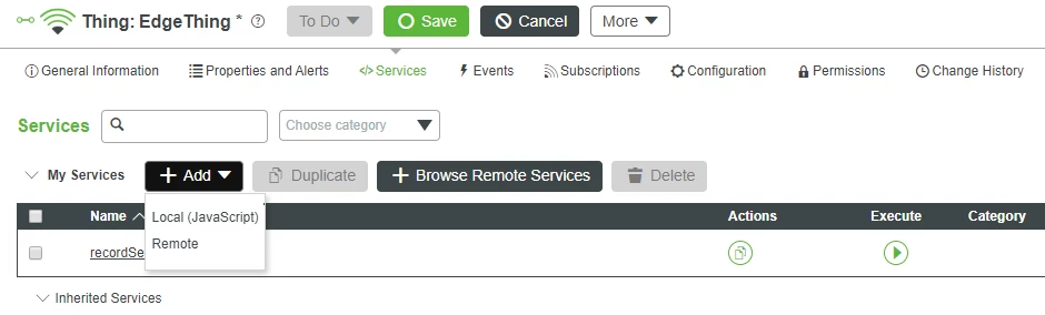

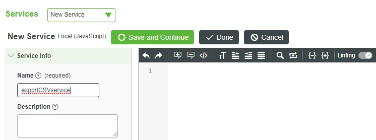

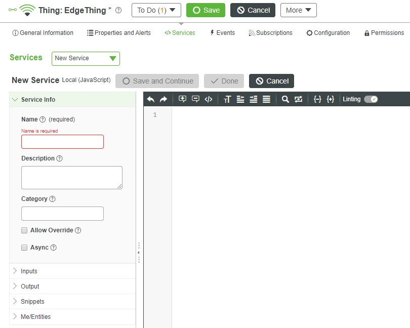

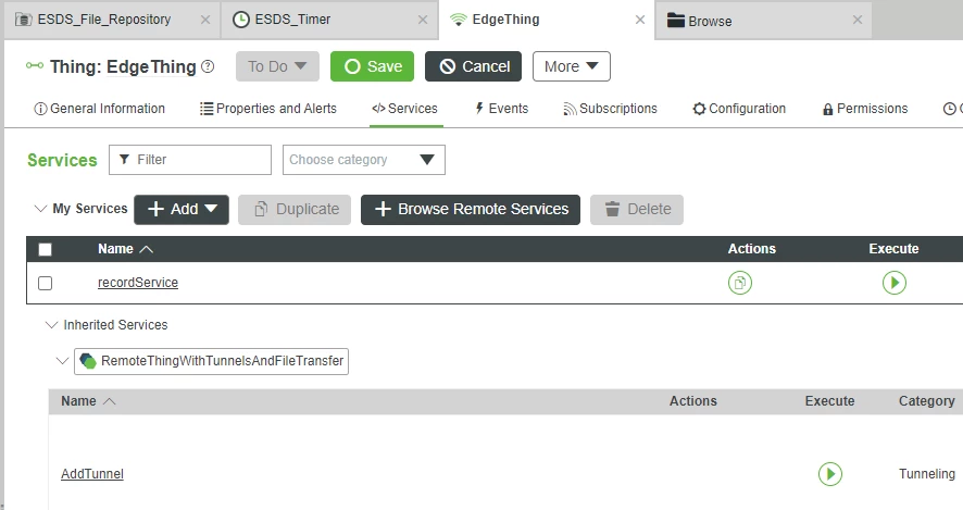

    1. Return to EdgeThing.
    2. Click Services.
    3. Click + Add.
    4. On the drop-down, select Local (JavaScript).

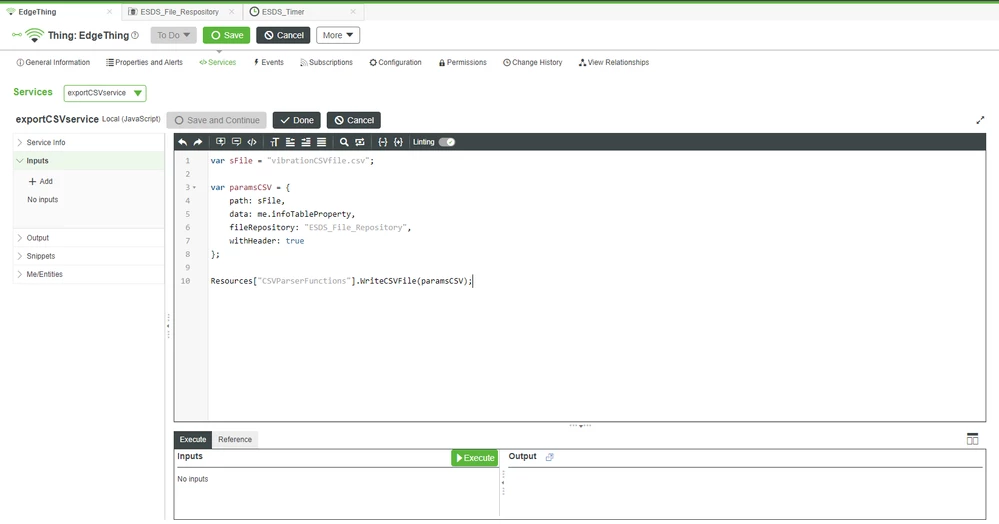

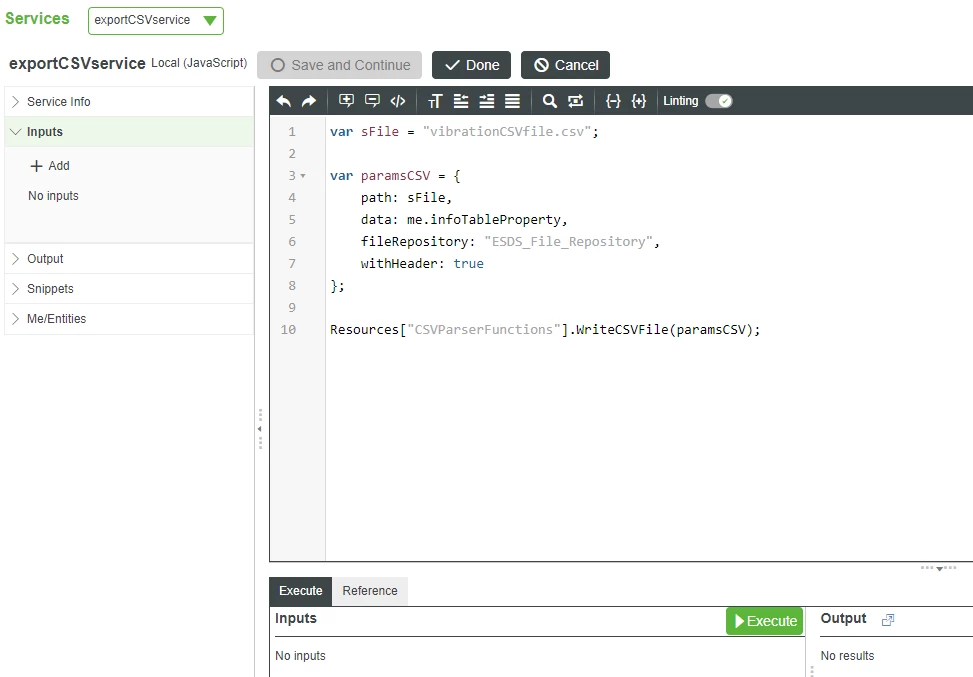

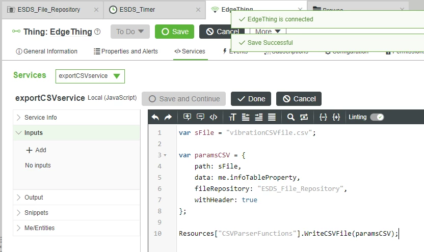

    5. In the Name field, type exportCSVservice.
    6. In the blank JavaScript field, copy-and-paste the following code:
var sFile = "vibrationCSVfile.csv";
var paramsCSV = {
 path: sFile,
 data: me.infoTableProperty,
 fileRepository: "ESDS_File_Repository",
 withHeader: true
Resources["CSVParserFunctions"].WriteCSVFile(paramsCSV);
    7. Click Save and Continue.
  • Note that you should NOT click the top Save button, as that will erase your Service.

    1. Ensure that you’re still on the Services tab of EdgeThing, and have the exportCSVservice open.
    2. At the bottom, click Execute.

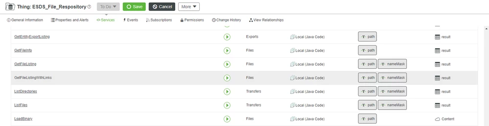

    3. Return to ESDS_File_Repository.
    4. Click Services.

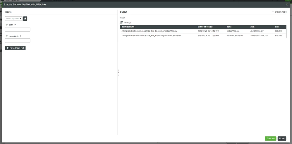

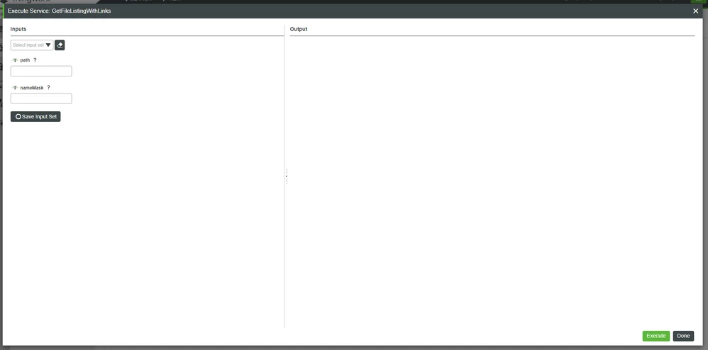

    5. Scroll down and find the GetFileListingsWithLinks Service.
    6. Click the “Play” icon for Execute service.
    7. At the bottom-right, click Execute.

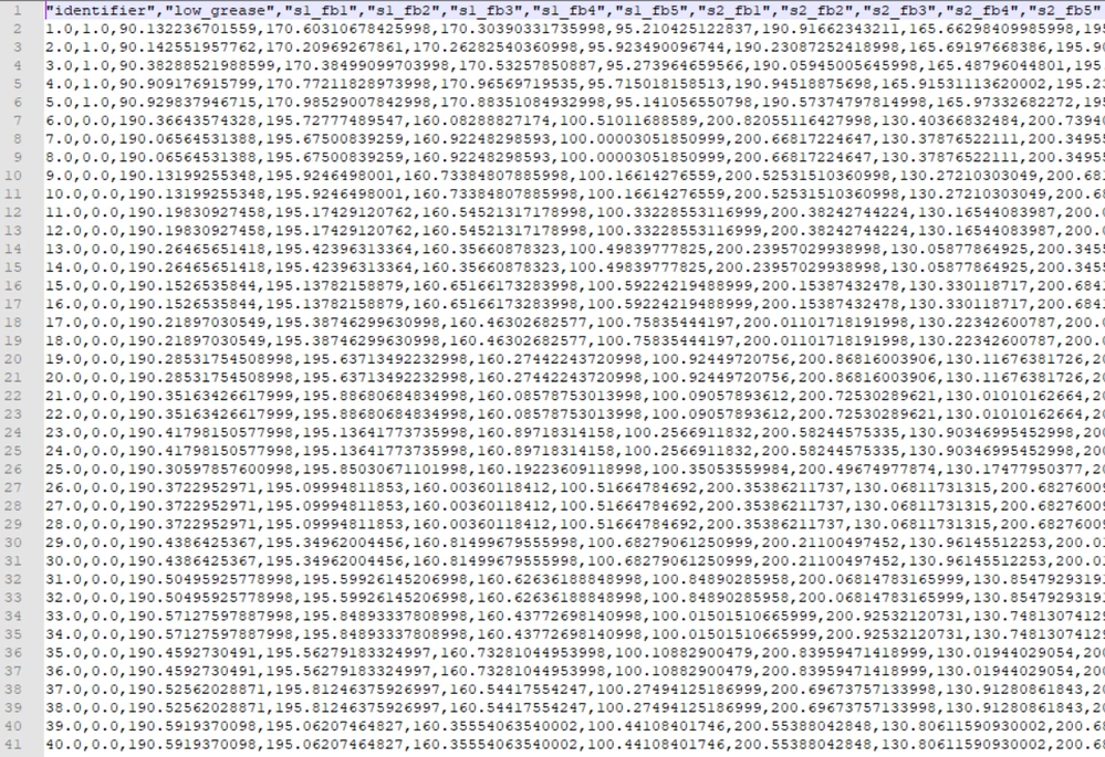

    8. On the right, click Thingworx/FileRepositories/ESDS_File_Repository/vibrationCSVfile.csv.
    9. The .csv export of the vibration data will now be in your local folder to which your browser saves downloads.
