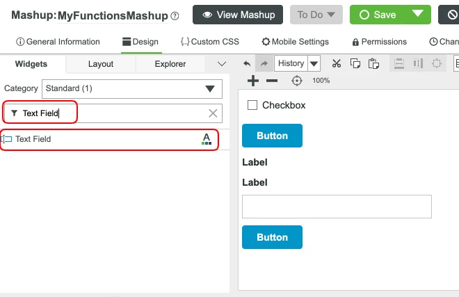

  1. Open the MyFunctionsMashup Mashup to the Design tab.
  2. Click on the Widgets tab.
  3. Type in the Filter text box for Text Field.
  4. Drag and drop TWO (2) Text Field Widgets to the Mashup Canvas.

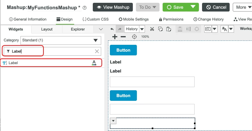

  5. Type in the Filter text box for Label.
  6. Drag and drop ONE (1) Label Widget to the Mashup Canvas.

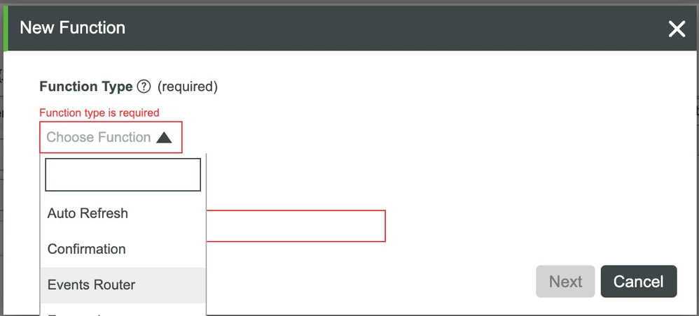

  1. Click the + button in the Functions panel.
  2. Select Events Router in the dropdown.
  3. Set the Name to routeUserInput.
  4. Click Next.

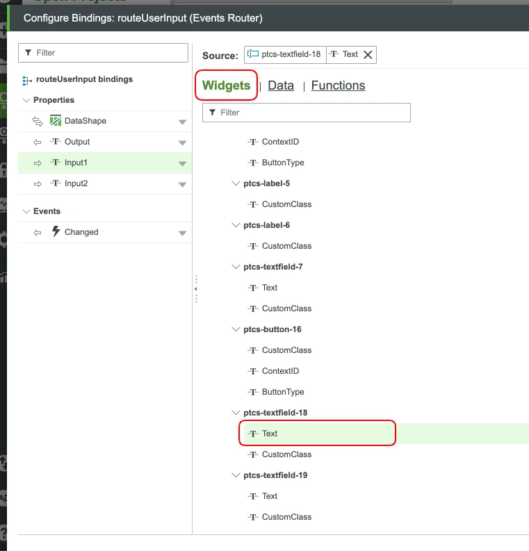

We have our Events Router setup. Now, we'll bind our new items together.
  1. Click the Bind (arrows) button on the routeUserInput Events Router.
  2. Click the down arrow next to Input1.
  3. Select Add Source.
  4. In the Widgets tab, scroll to the bottom and select Text Property of the first of the two recent Text Fields we created (it should be third to last).
  5. Click Next.

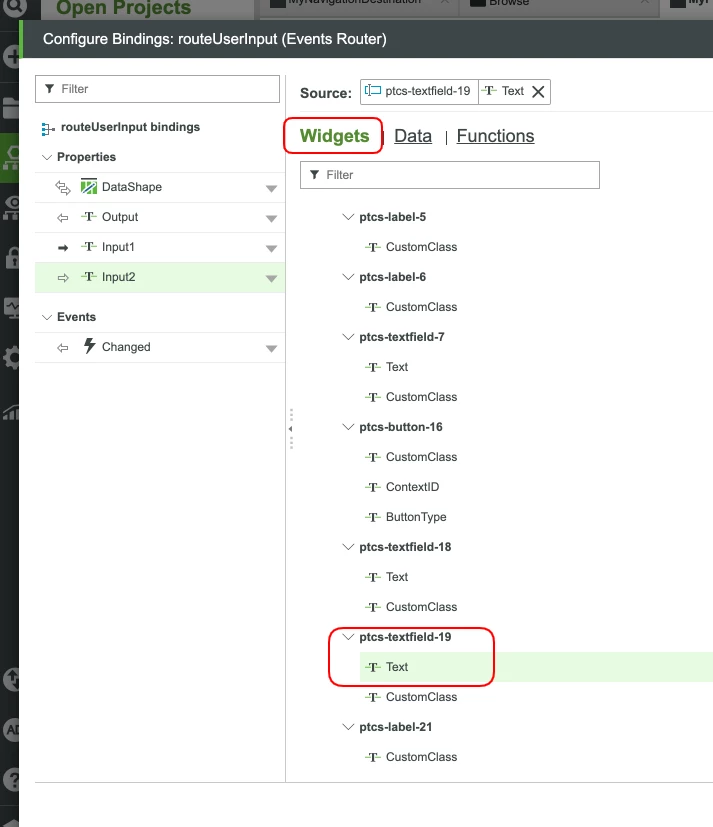

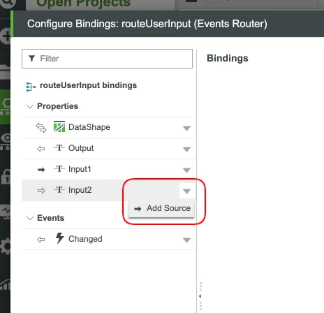

  6. Click the down arrow next to Input2.
  7. Select Add Source.
  8. In the Widgets tab, scroll to the bottom and select Text Property of the second of the two recent Text Fields we created (it should be second to last).
  9. Click Next.

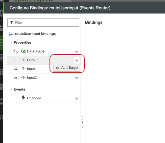

  10. Click the down arrow next to Output.
  11. Select Add Target.

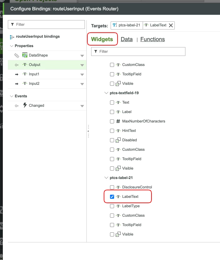

  12. In the Widgets tab, scroll to the bottom and select LabelText Property of the recent Label we created (it should be last).
  13. Click Next.
  14. Click Done.
