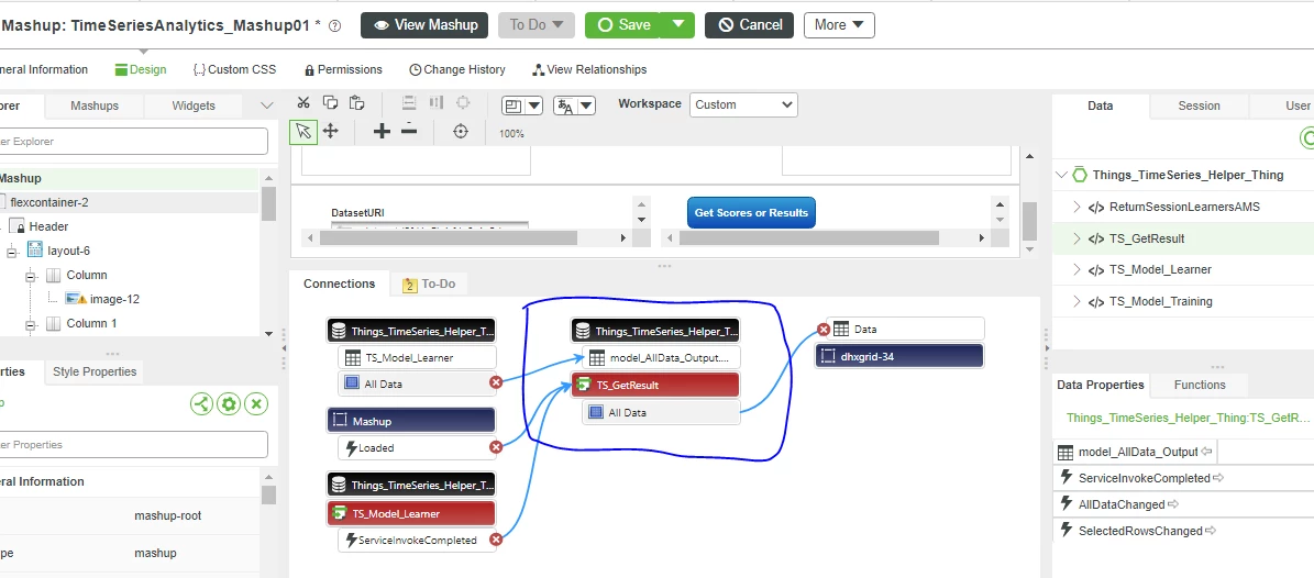

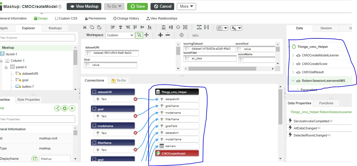

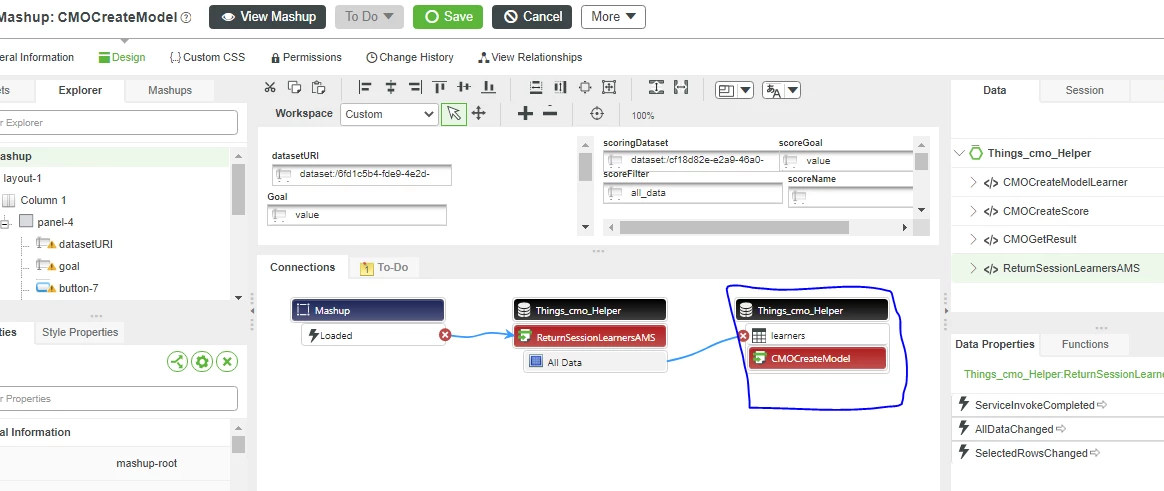

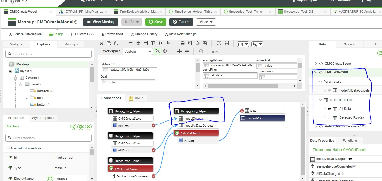

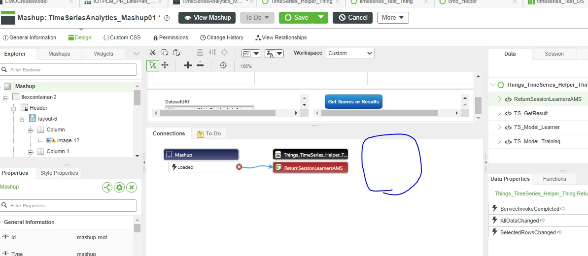

Aug 24, 2020 8:34 AM UTC
Hi Christophe,
I was not able to find 'CMOCreateModel' as service and its associated fields in cmo_helper thing.
I was tried to replicate this model and services in my local, and stuck in mapping for CMOCreateModel and modelOutputs as field.
Please let me know from where i can find CMOCreateModel as service and find modelOutputs fleld.
Mayank
