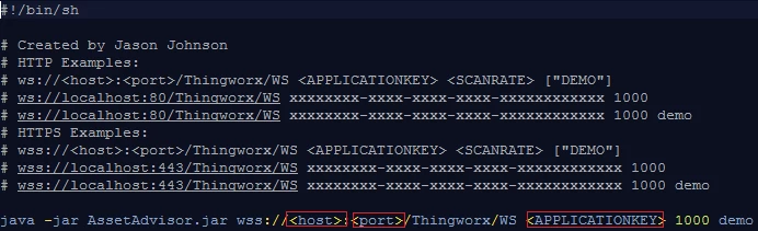

  1. Open the Executable/Script in a text editor, and edit the script with your host and port.
     Operating System   File Name
    Mac/LinuxScript.sh
    WindowsScript.bat
  2. Update the <HOST> and <PORT> arguments to that of your ThingWorx Composer and update the Application Key argument to the one you have created. Use the examples in the file for assistance.
    NOTE: If you are using the hosted trial server, follow the HTTPS example and use 443 as the port.
  3. After updating the script that pertains to your operating system, double-click or run Script.sh (Linux, Mac) or Script.bat (Windows) to run the Java program.

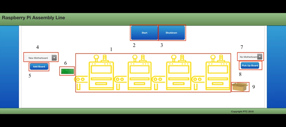

	<host>/Thingworx/Runtime/index.html#master=AssemblyLineMaster&mashup=RaspberryPiAssemblyLine
You can also open the RaspberryPiAssemblyLine Mashup in the Composer and click View Mashup.
You should be able to see rows of assembly machines with buttons. Click the Start button to start the assembly line. Click the Add Board button to add Raspberry Pi motherboards.
NOTE: The screen will not update and properties cannot be changed until the Java backend starts running. Ensure the connection is made before attempting to start the assembly line.
Functional Breakdown
At runtime, the Mashup executes the following functions:
           Mashup Component        Function
1 Assembly MachinesSelecting an assembly machine will provide you with information on the diagnostic status of that assembly machine and access to charts highlighting its performance.
2 Start ButtonStart up the assembly line and all assembly machines.
3 Shutdown ButtonStop the assembly line and shutdown all assembly machines. Queues will not be purged.
4 Motherboard Add DropdownA dropdown that shows the available motherboards that can be added to the assembly line.
5 Add Boards ButtonIf a MotherboardTemplate Entity is selected in the Motherboard Add dropdown, that Raspberry Pi will be added to the assembly line. If no Motherboard is selected, this will add a new Raspberry Pi Thing to the assembly line.
6 Motherboard ImageShow all motherboards currently inside the assembly line queue of Raspberry Pi.
7 Motherboard Pick Up DropdownA dropdown that shows the motherboards in the assembly line that are not in a Complete Stage.
8 Add Pick Up ButtonIf a MotherboardTemplate entity is selected in the Motherboard Pick Up dropdown, that Raspberry Pi will be removed from the assembly line and no longer be available. This can be done if a Raspberry Pi is slowing down the other queues.
9 Box ImageShow all motherboards currently in the Complete Stage.
