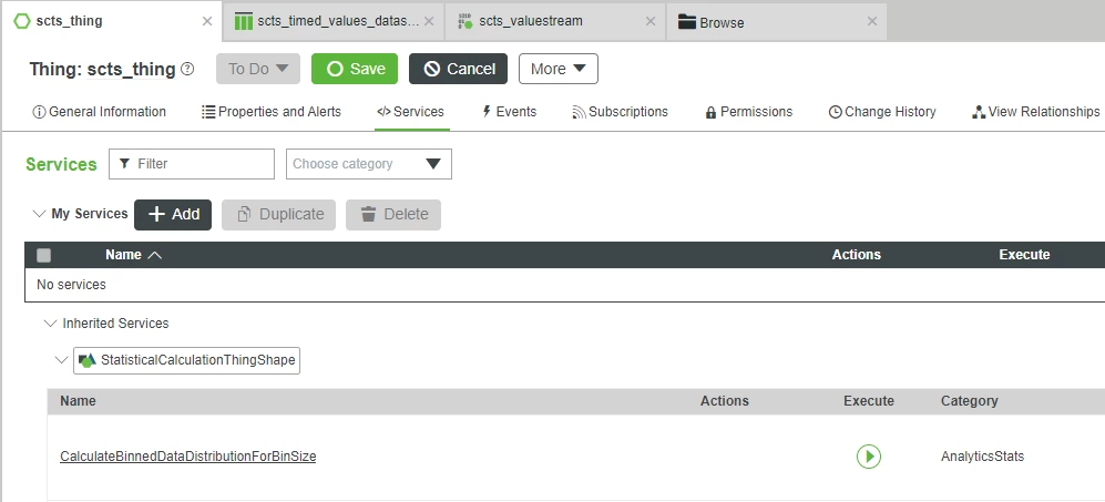

At the top, click the Services section of scts_thing.
In the Ihnerited Services section, you will see the built-in services of the Statistical Calculation Thing Shape. These services can perform a variety of analytical calculations.

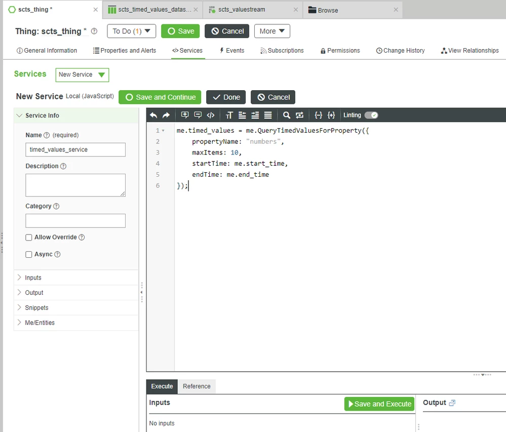

For efficiency, we only reference the Value Stream once to create a formatted timedValues that is used as an input to all other service calls.

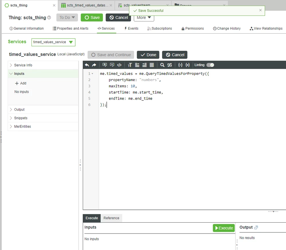

  1. At the top, click Services.
  2. Click + Add.
  3. In the Name field, enter timed_values_service.
  4. In the Javascript field, copy and past the following code:
     me.timed_values = me.QueryTimedValuesForProperty({
     propertyName: "numbers",
     maxItems: 10,
     startTime: me.start_time,
     endTime: me.end_time
  5. At the bottom, click Save and Execute.

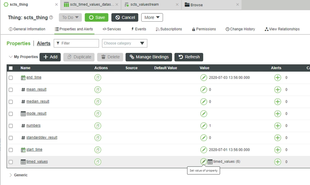

  6. Click Done, and return to Properties and Alerts.

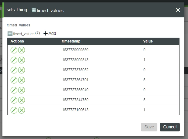

  7. On the timed_values property row, click the pencil icon for Set value of property.
  8. In the pop-up, note that there are now seven entries - each with the 1, 5, 9, 5, 9, 1, and 9 values and the timestamps when you entered them.
  9. In the pop-up, click Cancel.
  10. If needed, in the top-right, click the icon to close the slide-out.

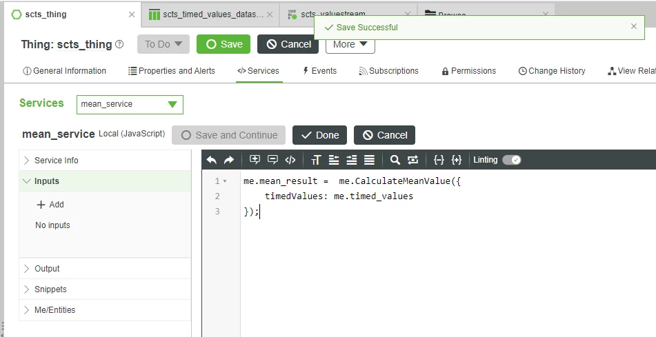

Mean Service
First, you will utilize the built-in CalculateMeanValue service.
The dataset is the following: 1, 5, 9, 5, 9, 1, 9.
As such, the mean should be (1+5+9+5+9+1+9)/7 = 39/7 = 5.571...

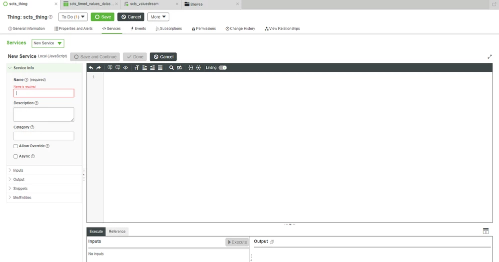

  1. Return to the Services section.
  2. At the top, click + Add.
  3. In the Name field, enter mean_service.
  4. In the Javascript code section, copy and paste the following:
     me.mean_result = me.CalculateMeanValue({
     timedValues: me.timed_values
  5. At the top, click Save and Continue.
  6. At the bottom, click Execute.
  7. Click Done, then return to the Properties and Alerts section.

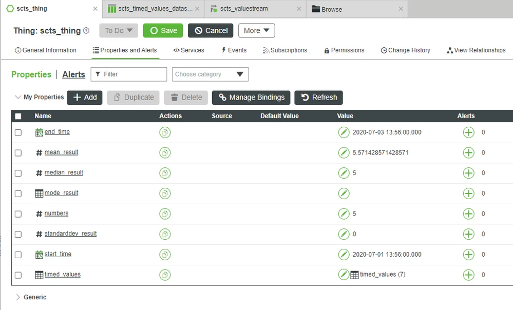

  8. Note that the mean_result property now has the value 5.571....

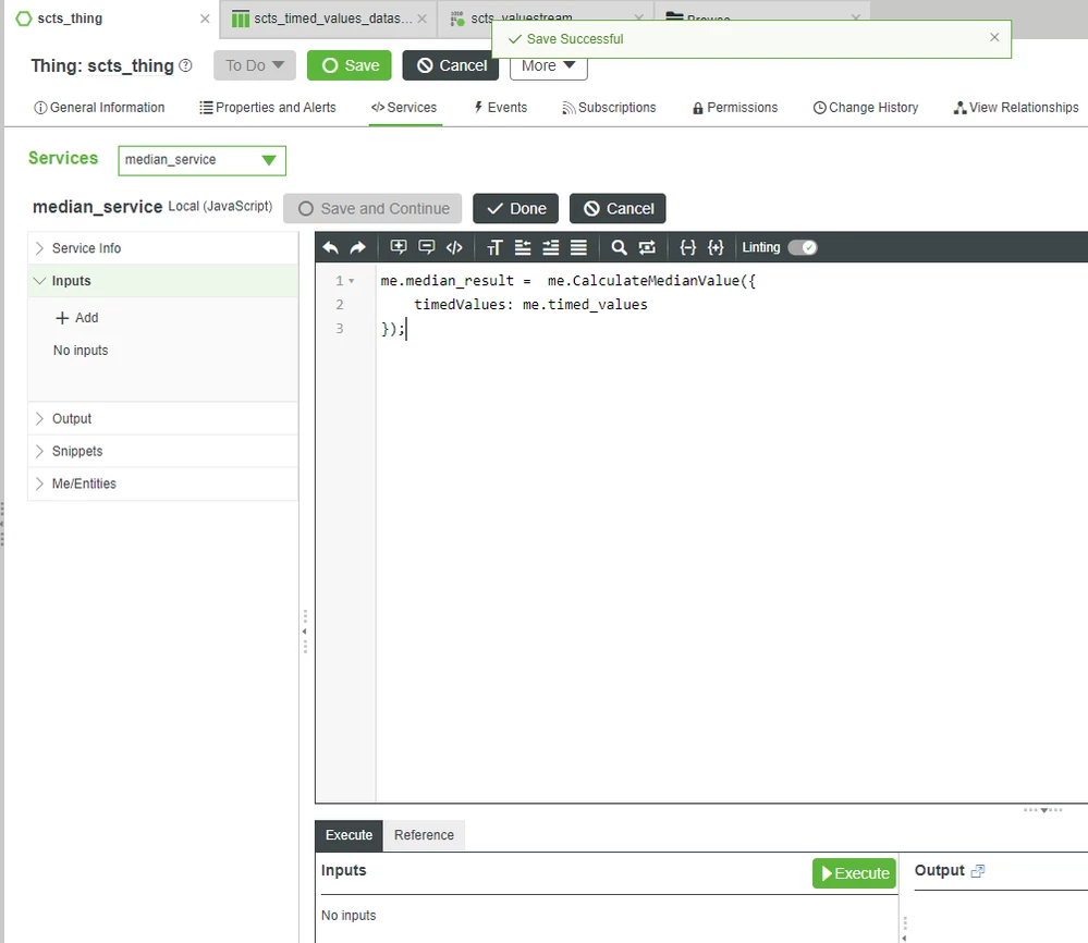

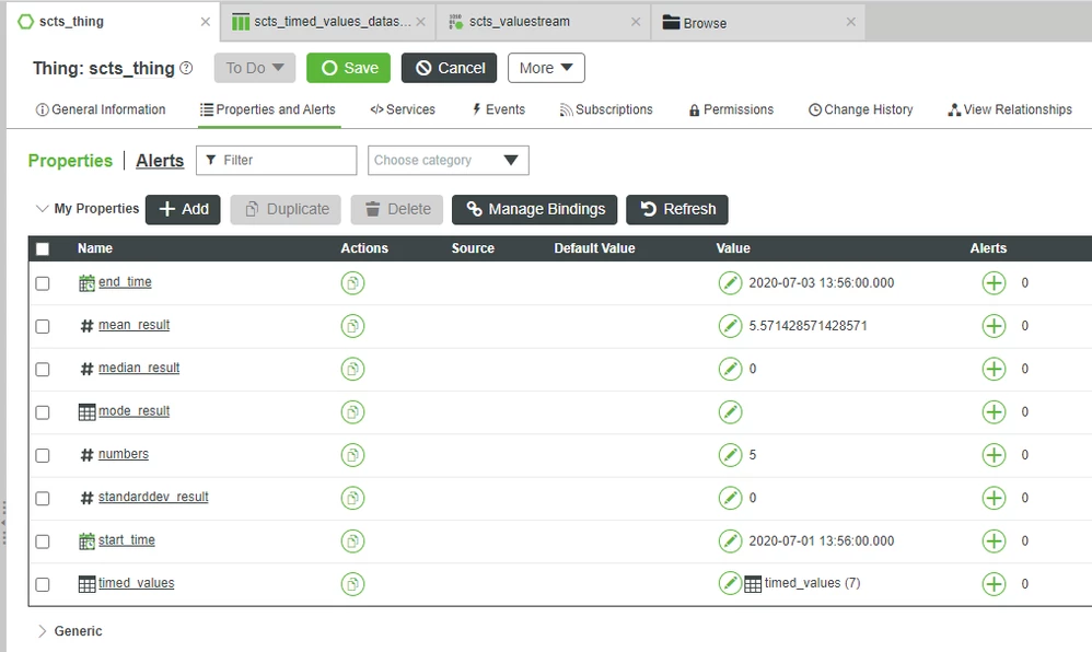

Median Service
Next, you will utilize the built-in CalculateMedianValue service.
With our dataset having 5 as the middle value, that should be the result.
  3. In the Name field, enter median_service.
     me.median_result = me.CalculateMedianValue({
  7. Click Done, and return to the Properties and Alerts section.
  8. Note that the median_result Property now has the value 5.

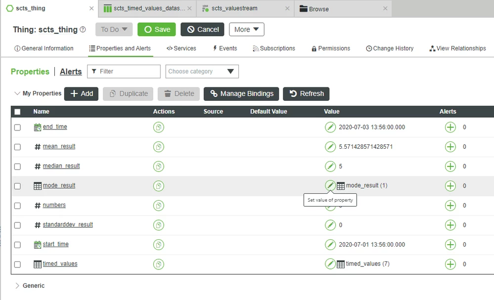

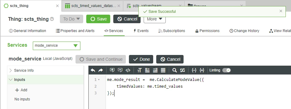

Mode Service
You will now utilize the built-in CalculateModeValue service.
With the dataset having 9 as the most common value, that should be the result.
  3. In the Name field, enter mode_service.
     me.mode_result = me.CalculateModeValue({

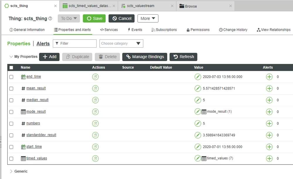

  8. On the mode_result row and under the Value column, click the "pencil" icon for Set value of property.
  9. In the popup, note that the mode_result Property now has the value 9.
  10. Click Cancel to close the popup.
  11. If necessary, at the top-right, click the button to close the slide-out.

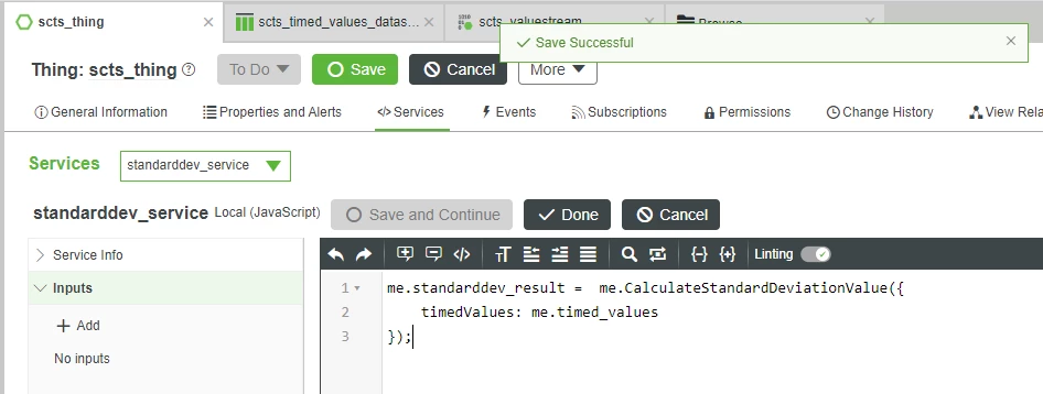

Standard Deviation Service
Lastly, you will utilize the built-in CalculateStandardDeviationValue service.
There are multiple free Standard Deviation calculators to check the answer.
Accordingly, the Standard Deviation should be 3.59894...
  1. Return to the Service section.
  3. In the Name field, enter standarddev_service.
     me.standarddev_result = me.CalculateStandardDeviationValue({
  8. Note that the standarddev_result property now has the value 3.59894...
