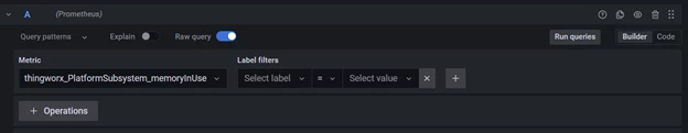

    To add a panel which monitors some component of the ThingWorx application to a dashboard in Grafana, click to add a new panel. Under “Metrics” in the box at the bottom of the screen, select what ThingWorx metrics you wish to monitor (type “thingworx” in the search box to see them all). For example, select the Platform Subsystem memory in use:
    Label filters aren’t necessary, though you may want to sort by instance if you are monitoring multiple ones with the same dashboard. You may also want to take some time to format the Y axis, which by default will show in bytes. Go to the formatting panel on the right side and scroll down to the section called “Standard options”. For the Unit dropdown, start typing “data” and then select “bytes (SI)”. This will automatically determine if the bytes you’ve provided should really print as MB or GB based on how large the numbers are.

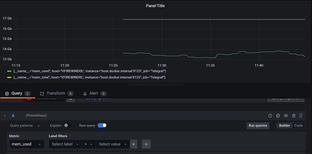

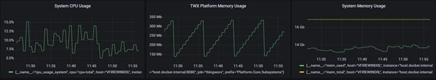

    Don’t forget that with Telegraf running, VM or machine usage metrics are also available for display on a dashboard. Things like overall CPU and Memory usage are critical to determining the health of a system, as we have demonstrated in our own reasoning in past benchmarks and scale tests. You can create a panel to monitor the mem_used versus mem_total, like so:
    Another metric from Telegraf worth adding is the CPU usage, which should be given “percentage” for the units and which needs a label filter of cpu = cpu-total. If we do some resizing and drag-and-dropping, then we now have the first row of a dashboard:

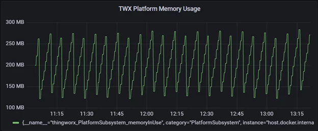

    See how the Platform usage climbs steadily and is purged in a cycle? That is the Java Garbage Collection mechanism, and it’s important to remember to leave room for spikes on top of those peaks. Data can also be calculated or processed in some way to make it more useful for determining system health and stability.

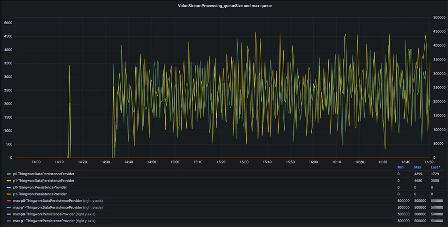

    The data in the picture below uses the formula submitted = completed + number queued + number failed. It shows the current queue on the left Y-axis and the max queue on the right (since the two numbers usually are drastically different). It looks pretty, but it doesn’t really tell us much about the system in this format, so let’s do some math and find a representation that is a bit more helpful.

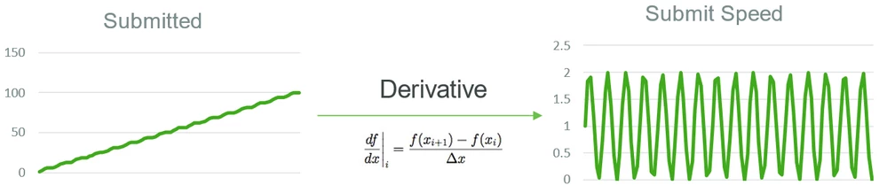

    Performing a “non-negative derivative” calculation over the submitted and the completed queue counts over time allows for us to look at the status of the queue as a velocity. When the “complete” speed appears behind the “submitted” speed for too long at a time, then that means the queue is filling up and will eventually result in data loss.
    If we take this one step further and calculate the average of the submitted minus the completed over time, then we can actually predict approximately when the queue will fill up. This can then be displayed on a dashboard in Grafana, or used as the basis for an alert.

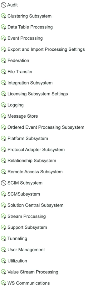

    For ThingWorx, there’s different kinds of data to track: subsystem data (see the list on the right) and non-subsystem data. There’s queue based versus non-queue data. These different metrics can collectively characterize the overall health of the application, depending on the use case.

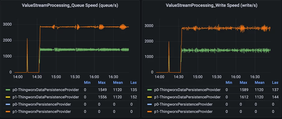

    Other common indicators of a healthy ThingWorx application might include the value stream and stream queues. These queues should fluctuate over time as the data is ingested and processed, but they should never be growing in size. If the stream queues are growing, then that means the data is writing to the queues faster than the queues can write to the database. Eventually, when the system runs out of resources to keep track of the queues, data will be lost. Having the stream information displayed in a chart can make it very easy to spot an upward trend in resource usage early on, which can catch a blockage or bottleneck that needs attention before it starts to affect the larger system in catastrophic ways later.

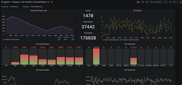

    A mature dashboard used for a production environment might look a little like this:

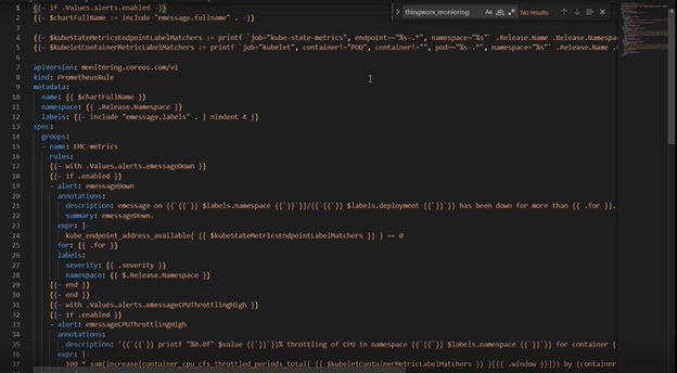

    The alerting mechanism built-in to Prometheus is incredibly easy to configure, so it might be tempting to generate tons of alert rules. However, remember that the more noise a system makes, the harder it is for those monitoring that system to know when action is really required. Playbooks which document how to respond to alerts, who to contact, how to act, and all the information necessary to handle an alert, should be created as an ongoing part of the DevOps process.
    Alerts should fire with the right severity in the subject line, as well as all of the information about the issue that is currently known, presented in a concise way, so that whoever receives the alert starts thinking about the root cause sooner and recovers the system faster. Those who receive the alert should have the ability to facilitate its resolution, and know who is expected to react to any alerts which come in.

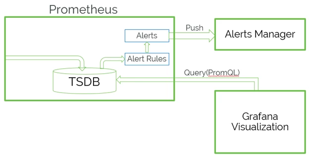

    In the ThingWorx monitoring stack, Prometheus handles the alert rules and the generation of alerts, but alert filtering and delivery is managed in an external alerts manager.

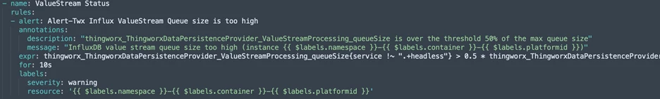

    Generally, you want your alerts to follow a curve. If the current queue size exceeds 50% of the maximum, perhaps that isn’t a huge deal, if the application catches up quickly. How long are spikes in queue processing expected to last? Perhaps if the queue size is over half-full for 10 seconds, 30 seconds, then that means the queue is falling behind and not catching up. Ok, so this might be a warning level alert. When does this become an error? Well, let’s say the queue exceeds 90% of the max queue size. This might want to alert the moment it hits the mark. Now, farther along the curve, it may not take as long before data gets lost.
    As the severity of the situation increases, the threshold for alerting should increase as well. That way when errors do alert, it is a sure thing that they require a response immediately. The alerts are then pushed into the “Alerts Manager” for delivery based on your management rules. The Alerts Manager may decide to withhold warnings altogether, or send them to a much smaller mailing list, whatever filtering helps to ensure the right people receive the right alerts, right when they need them.

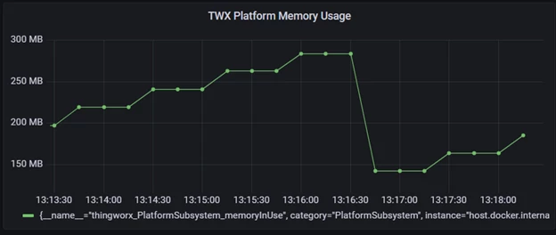

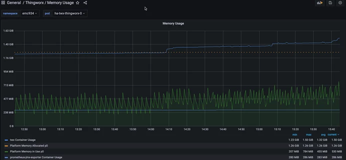

    Has stable memory usage that fluctuates predictably and doesn’t grow over time. In a system experiencing mild issues, the memory starts to trend upward:
    If left unattended, systems like this may eventually experience outages. Finding the issue this early means there is even time to do some digging, debugging, taking of stack traces, and other such troubleshooting steps before the system must be restarted or recovered. That can really make the difference in identifying and resolving before there are real problems.
