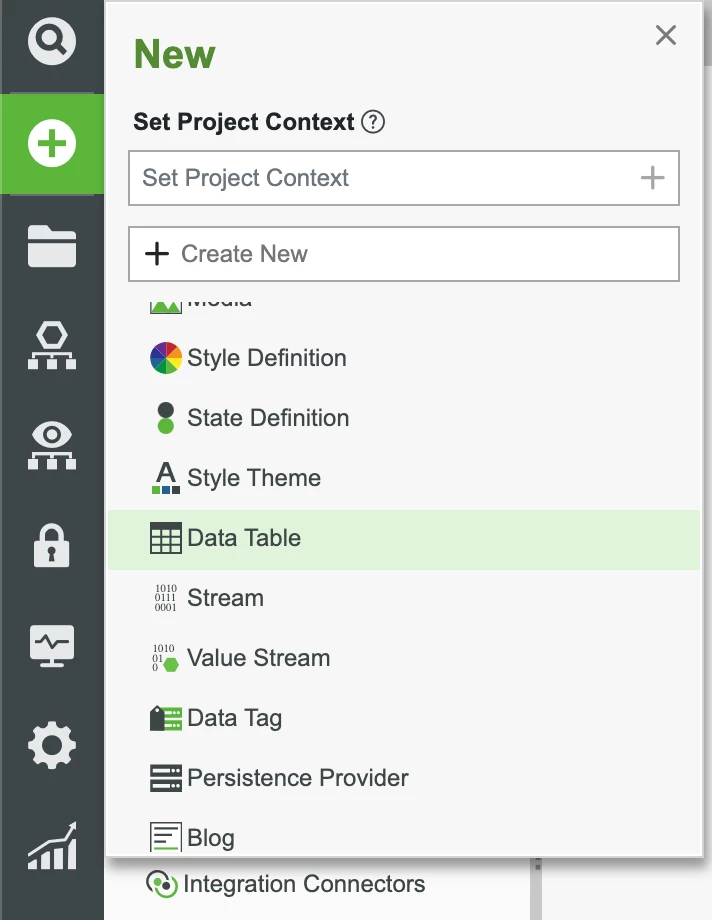

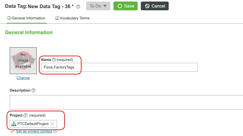

Before we begin, we'll be using Data Tags. These tags will help organize, filter, search, and analyze what is happening throughout our applications.

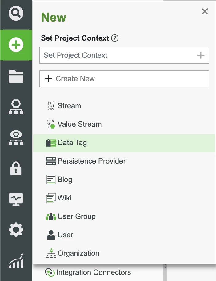

  1. In the ThingWorx Composer, click the + New in the top left of the screen.
  2. Select Data Tag in the dropdown.
  3. Set the name as Fizos.FactoryTags.
  4. Set the Project (ie, PTCDefaultProject).
  5. Add new terms now or you can add them later. We'll be adding them later. You can utilize tags with almost anything in this scenario. The more data, the better.

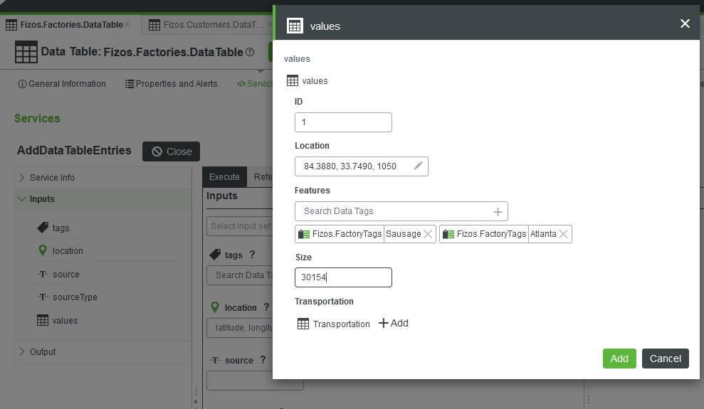

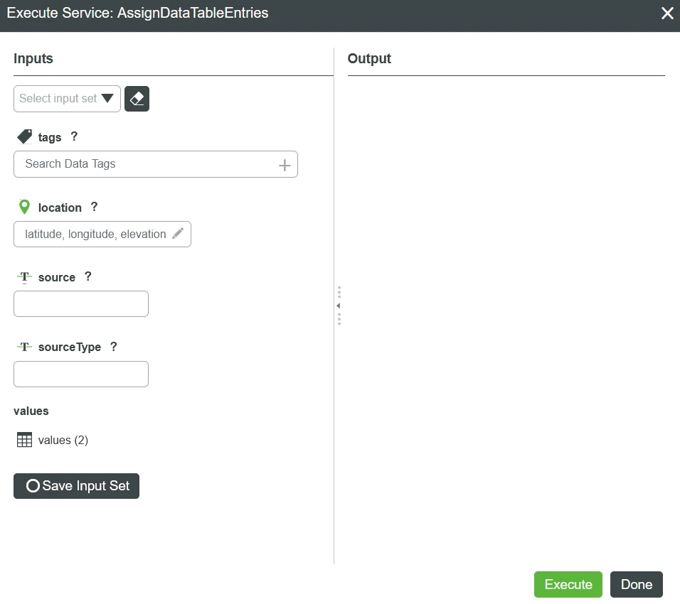

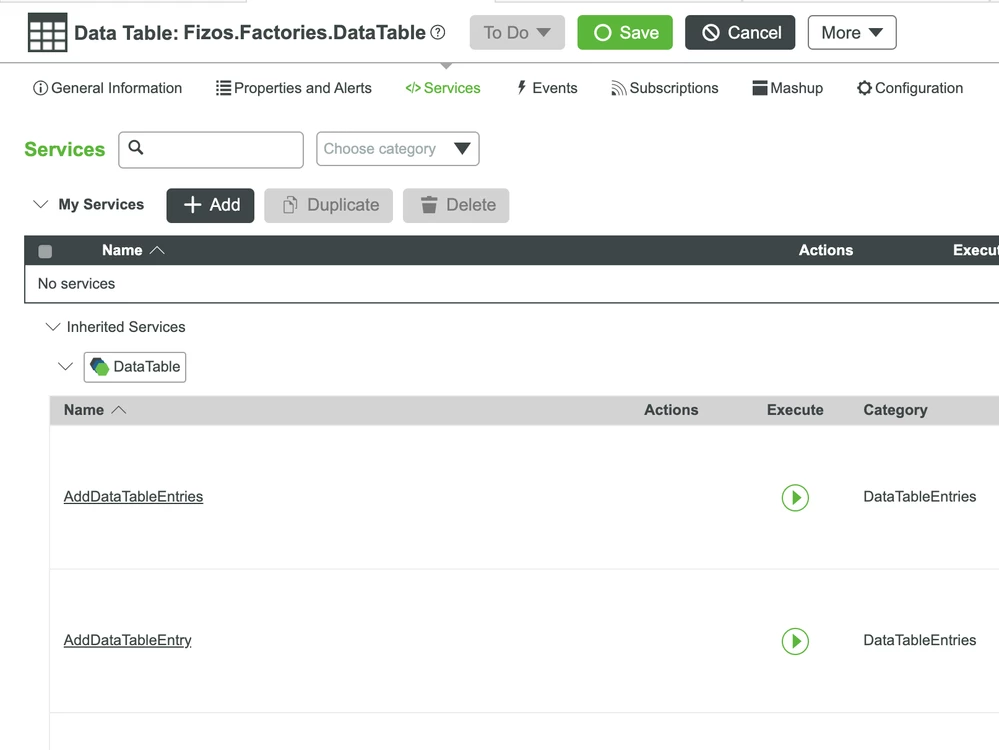

  1. Open the Fizos.Factories.DataTable Data Table and go to the services tab.
  2. Open the AddDataTableEntries service to be executed. This service will allow us to create some general data to work with. You can create as many as you like for this test. Click the values parameter to start creating entries.
  3. After clicking + Add, you'll see our Features property. This is where we can find the factory tags we just created, and create as many terms as we like. For simplicity, click New Term create two tags, Sausage and Atlanta. These options will provide us with the purpose of the factory and a location.
4. Save your entry and create a second entry with any location and tags you like. We aren't adding vehicles as of yet, but we will in the next section.
5. After saving, don't forget to execute the service with the two entries saved. If you did it correctly, the values parameter of the service, should show at least a 2 inside of the parentheses. You can also add data to the other parameters if you like. See below:

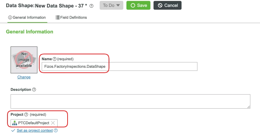

You now have two factories. We need to inspect these factories daily. What does an inspection entail exactly? You can create custom factories based on the type of products manufactured or have a generic system. Nevertheless, we will log and store these reports in a data table. Let's go.

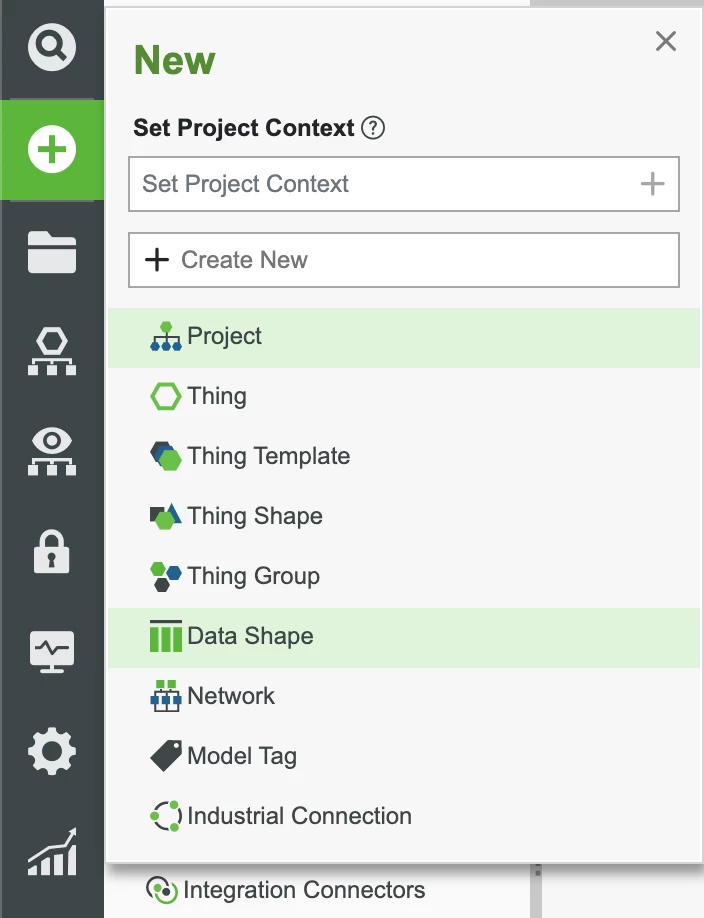

  2. Select Data Shape in the dropdown.
  3. In the name field, enter Fizos.FactoryInspections.DataShape. All of our factory inspections will be based off this Data Shape.
  4. Set the Project (ie, PTCDefaultProject) and click Save to store all changes now.

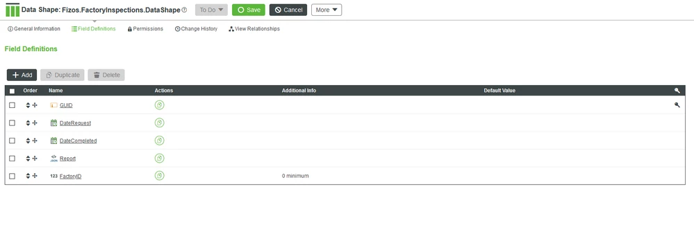

  5. Add the list of properties below:
Name                      Base Type     Aspects            Description
GUIDStringprimary keyReport identifier
FactoryIDInteger0 minimumFactory identifier
DateRequestDateTimeN/ADate the inspection was requested
DateCompletedDateTimeN/ADate the inspection was completed
ReportJSONN/AThis will hold the inspection report data
The fields for the Fizos.FactoryInspections.DataShape Data Shape are as follows:

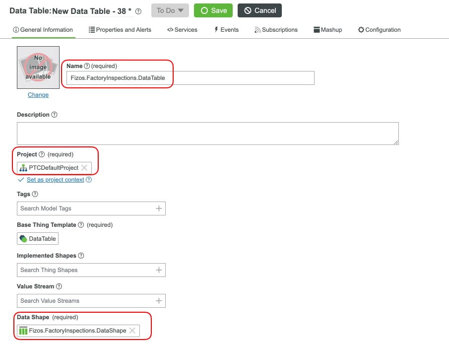

  2. Select Data Table in the dropdown.
  3. In the name field, enter Fizos.FactoryInspections.DataTable. Our Data Table will hold all of our records on factory inspections.
  4. For the Data Shape field, select Fizos.FactoryInspections.DataShape.
  5. Set the Project (ie, PTCDefaultProject) and click Save to store all changes now.
  6. This entity will be used to house our data and provide assistance with our analytics.

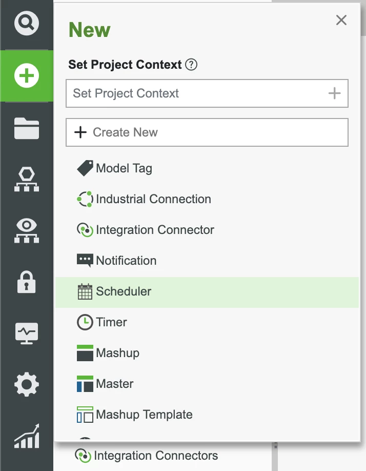

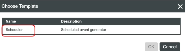

For this scenario, we will create the scheduler that starts a generic process process.
  2. Select Schedulers in the dropdown.
  3. Select Scheduler in the pop-up.

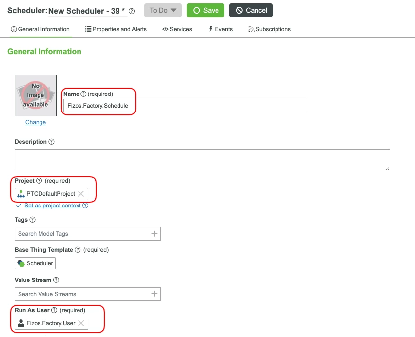

4. Name the new Schedule Fizos.Factory.Schedule.
5. For the Run As User field, select the Fizos.Factory.User that was provided in the download.
6. Set the Project (ie, PTCDefaultProject).
7. Click Save and your entity should match the below configuration.

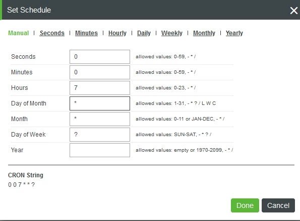

8. For the Schedule field, set it to 0 0 7 * * ?. This will run the process every day at 7 AM.

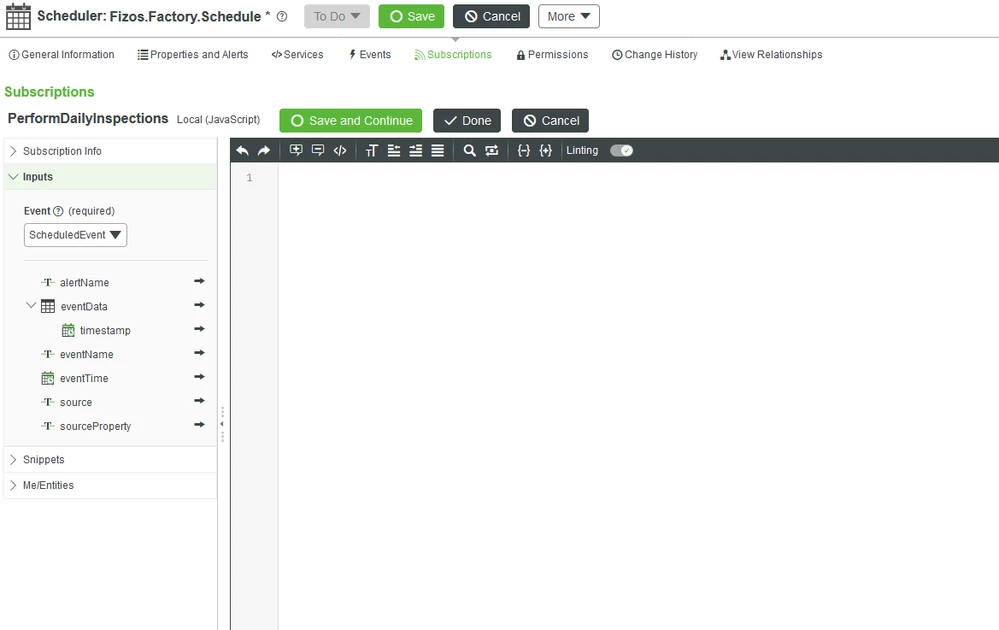

9. Switch to the Subscriptions tab and add a new subscription.
10. Name this new subscription PerformDailyInspections and select ScheduledEvent as the event input.
11. Add the following code to the source section:
var factories = Things["Fizos.Factories.DataTable"].GetDataTableEntries({});
var tableLength = factories.rows.length;
for (var x=0; x < tableLength; x++) {
 var row = yourInfotableHere.rows[x];
 Things["Fizos.ProductsBusinessLogic"].InspectFactory({
 FactoryID: row.ID
This code will execute the inspection request service. Now let's expand on the Fizos.ProductsBusinessLogic to produce and handle the result of a request.
