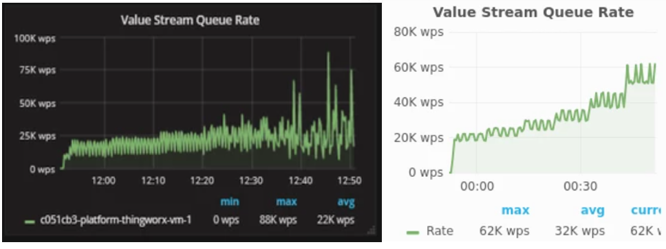

Value Stream Queue
The vertical axis on the Value Stream Queue Rate chart shows how many total writes per minute (WPS) the Platform can handle. The average is 10 WPS higher using InfluxDB in both scenarios, and InfluxDB is also much more stable, meaning that the writes happen more reliably. The Value Stream Queue Size chart demonstrates how well the writes within the queue are processed. Both of these are necessary to determine the health of data ingestion.

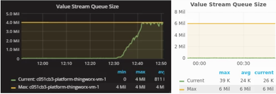

If the queue size were to increase and trend upward in the lighter Queue Size chart, then that would mean the Platform couldn’t handle the higher ingestion rate. However, since the Queue Size is stable and close to 0 the entire time, it is clear that the Platform is capable of clearing out the Value Stream Queue immediately and reliably throughout the entire test.
imageFIGURE 1 – THESE REPRESENT THE DATA GETTING STORED INTO THE DATA PROVIDER. NOTE: THE FORMER IS MUCH LOWER THAN THE LATTER.
imageFIGURE 2 – NOTE THE DATA LOSS IN THE NON-INFLUX INSTANCE (THE QUEUE IN GREEN REACHES THE MAX IN YELLOW). THE INFLUX INSTANCE HAS LESS TROUBLE CLEARING OUT THE QUEUE, AS DEMONSTRATED BY THE CONSISTENTLY LOW QUEUE SIZE.

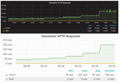

HTTP Requests
Taking the strain of ingestion off of the Platform’s primary database frees its resources up for other activities. This in turn improves the performance and reliability of the Platform to respond to HTTP requests, those which in a typical application are used to aggregate data into smaller data stores (depending on the use case) and which render the mashups for the end users. The business logic and mashups can be more complex when there is one database designated for ingestion (InfluxDB) and one for everything else (PostgreSQL).
imageFIGURE 3 – THE DARKER CHART SHOWS A LOT OF CHOPPINESS, MEANING THAT WHILE THE PLATFORM WAS RESPONDING THE WHOLE TIME, IT WAS NOT DOING SO RELIABLY. THE SMOOTHER SECOND CHART SHOWS HOW MUCH EASIER THE PLATFORM CAN HANDLE THESE REQUESTS WHEN THE LOAD IS DISTRUBITED INTELLIGENTLY ACROSS MULTIPLE SERVERS, EACH OPTIMIZED FOR THE TYPE OF DATA THEY RECEIVE. THE “STAIRCASE” SHAPE OCCURS BECAUSE THE SIMULATOR INCREASES THE WORK LOAD EVERY 10 MINUTES UNTIL IT BREAKS.
Likewise, the nature of Postgres lends well towards this differentiation, given that there are many more database tables required for supporting the HTTP requests, something Postgres does well. That leaves Influx to handle the time-series data and ingestion, and those are the primary strengths of that software as well. So, splitting the load across multiple servers in this way results in smaller server sizes overall, each which is stream-lined and optimized to handle exactly what it is given by the Platform.
Note that in both of these charts, there are no bad requests, so both would seem to be successful runs. However, as future charts will demonstrate more clearly, there is a catastrophic failure when the load is increased around 12:30p. The simulation ends before the server begins to show any real symptoms of the issue, and that is why there are no bad requests. The maximum Operations Per Second (OPS) in the Hardware Specifications and Performance section is taken from before the failure begins.
Clearly the InfluxDB instance has better performance given that the average Operations Per Second (OPS) is substantially higher, nearly 4 times what is seen in the PostgreSQL ONLY instance. Obviously how well the Platform manages the business logic and mashup loading will depend on a lot of factors. In this test scenario, the OPS was increased by increasing the mashup refresh rate on the InfluxDB instances (which could handle over double the operations). Likewise, the number of Stream writes to the PostgreSQL database could be double what it was when PostgreSQL was the only database. Therefore, configuring InfluxDB for the data ingestion and leaving Postgres for the rest of the application certainly makes the load much easier on the Platform, and the same would be true even in a much more complex scenario.

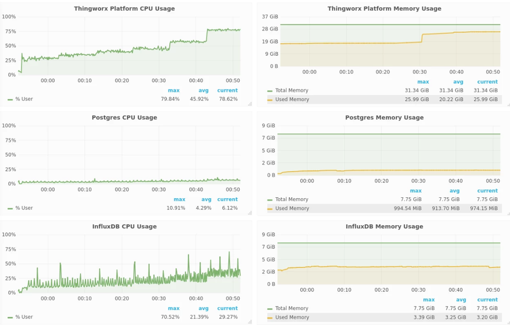

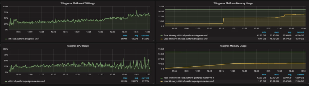

Memory and CPU
The important thing here is to keep the memory use low enough that any spikes in usage won’t cause a server malfunction. CPU Usage should stay at or below around 75%, and Memory should never exceed around 80% of the total allocated to the server. The sizing guides can help determine what this allocation of memory needs to be.
Of note in these charts is the slight, upward slope of the CPU usage in the darker chart, indicating the start of a catastrophic failure, and the difference in the total memory needed for the ThingWorx Platform and Postgres servers when Influx is used or not. As is apparent, the servers use much less memory when the database load is split up intelligently across multiple servers.
imageFIGURE 4 – THE THINGWORX CPU IS ABOUT THE SAME HERE AS IN THE INFLUXDB CONFIGURATION BELOW BUT LOOK AT HOW MUCH MORE MEMORY BOTH THE PLATFORM AND THE POSTGRES DATABASE NEED ALLOCATED TO THEM IN THIS CONFIGURATION (64 GB A PIECE). ALSO NOTE THE JUMP IN CPU AND MEMORY USAGE AFTER 12:30P. THIS IS REFERENCED IN THE PREVIOUS SECTION, AND THE SLOPE UPWARD OF THE USAGE AFTER THAT POINT INDICATES THE START OF A CATASROPHIC FAILURE. THE TEST ENDS TOO SOON TO SEE ANY SYMPTOMS OF FAILURE, BUT IT IS A SURE THING AFTER THE INCREASE IN LOAD AROUND 12:30P.imageFIGURE 5 – INFLUX NEEDS AN EXTRA SERVER, BUT THE SIZE OF THE INFLUX AND POSTGRES SERVERS TOGETHER IS LESS THAN HALF THE SIZE AS THAT REQUIRED FOR THE SINGLE POSTGRES DATABASE IN THE POSTGRES ONLY CONFIGURATION (8 GB). THINGWORX IS SMALLER TOO (32 GB).

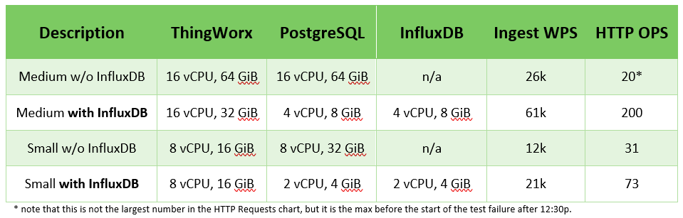

These are the exact specifications for each simulated instance, broken down by size and whether InfluxDB is configured or not. Note that some of the hardware specifications may be more than is necessary real-world use case depending. As stated previously, this document is not a sizing guide (use the official ThingWorx Sizing Guide).
Note that the maximum number of WPS and OPS are shown here. The maximums are higher in the InfluxDB scenarios, meaning that even with smaller-sized servers, the InfluxDB configurations can handle much greater loads.
