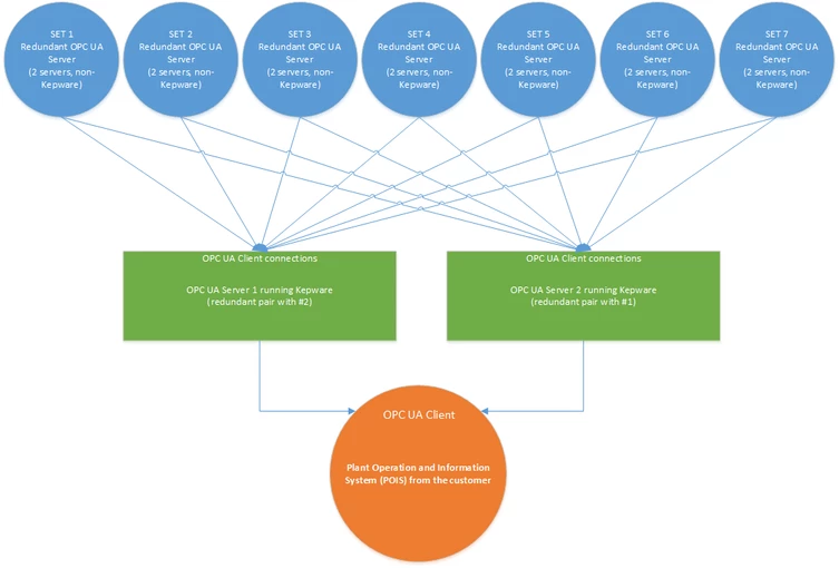

Jun 13, 2023 8:54 AM UTC
The green OPC servers depicted in the image above are the ones I am talking about. They act as OPC proxy relaying all information to the client (orange).
Since we act as OPC UA Server, there's nothing to push from our side, hence buffering is not applicable. If we were to act as OPC UA client connecting to the customer's OPC UA server, then it would be different. How this would be handled in case of redundancy is a very good point! These servers are only allowed to run an OPC server and no other software, so it would be hard to disable/enable channels based on the redundancy status if RedundancyMaster has no provision to do this.
Jun 13, 2023 2:01 PM UTC
Extrapolating that to my system which may or may not be equivalent .... the blue nodes are PLC's,  green nodes are my redundant SCADA servers, Orange would be my SQL DB Server.
SQL can't PULL the data so the Greens have to push it via the DataLogger plugin and ODBC. THATS where my issue lies.  Since Datalogging is triggered in my case by timestamp, all I can do is to turn off the datalogging trigger on the redundant system until its needed and that's what I am pursuing.
If your Orange is pulling from the Greens, you just have to tell the Orange which Green to pull from. You could do that by enabling one channel or the other.
