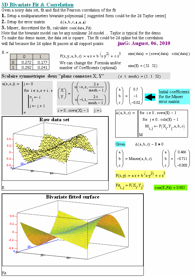

3D fit & Correlation
- August 6, 2010
- 0 replies
- 1509 views
Disambiguation:
1.Spline fitted surfaces will have corr(data,Fit) = 1 ... all fitted points meet at the support points
2. For the non linear X, Y planes the correlation takes another form.
jmG [Mcad 11]
