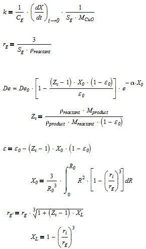

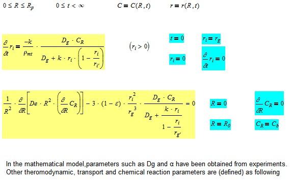

there are governing equations from my friend, describing transport of SO2 through the porous particles and reaction rate of the individual grain along with the respective boundary conditions. Can anyone give me any hints on how to solve the PDEs when mathcad is the only choice? He wants to get the time-space distribution of C and r for the process, and then X0 can be further calculated
NOTE THAT ri' in the 1st equation should be rg'
