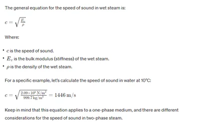

and Chat GPT says
 And  Gemini AI says:
If you need a rough estimate, you might find references to the speed of sound in wet steam being around 10% lower than dry steam at similar conditions. However, this is a simplification and won't be accurate for all cases.

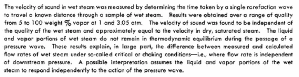

Your reference says no measured data is available?:  But there is one that has measurements of wet steam.
ON THE SPEED OF SOUND IN STEAM
Pavel Šafa?íka,?, Adam Novýb, David Jíchaa,b, Miroslav Hajšmanb
Papers [5, 6] provide much stimulation for further studies of the speed of sound in wet steam, because they deal with the propagation of waves in wet steam. However, no measured data have in fact been published.
[5, 6] are not this article:
Velocity of Sound Measurements in Wet Steam
R. E. Collingham and J. C. Firey
