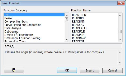

Hi Henry,
of course you can read-in CSV files as well. In the FileList function set the file type extension from "*.xlsx" to "*.csv". Then you have to change the read-in procedure from reading excel files to csv files. For this purpose there are many read-in functions in MC15; see below.
Raiko
