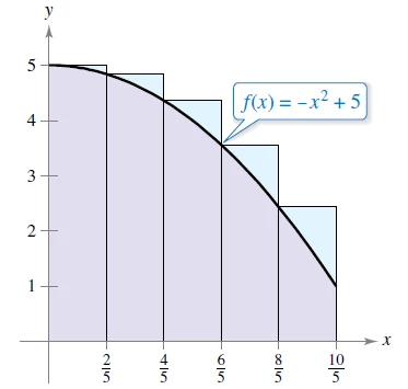

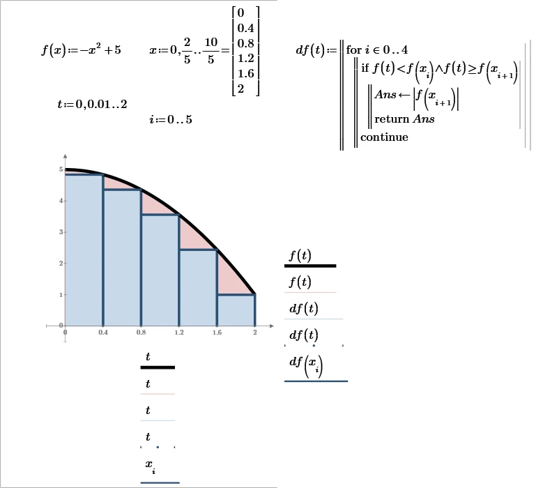

How to create rectangles in Mathcad Prime?
The right endpoints of the five intervals are:
where i = 1, 2, 3, 4, 5.
The width of each rectangle is:
and the height of each rectangle can be obtained by evaluating f(x) at the right endpoint of each interval.
How to create the below rectangles in Mathcad Prime (8)?
ttokoro
ttokoroAnswer
Jul 31, 2023 12:28 PM UTC
t.t.
13 replies
ttokoro
ttokoro21-Topaz IAnswer
t.t.

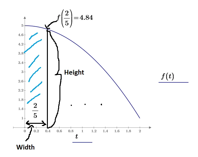

Cornel19-TanzaniteAuthor
Jul 31, 2023 1:23 PM UTC

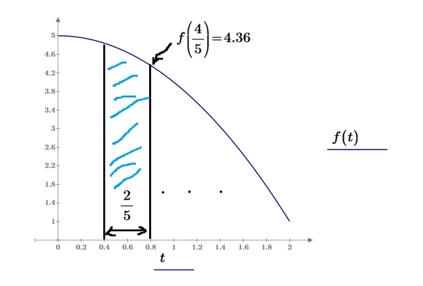

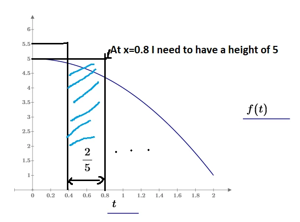

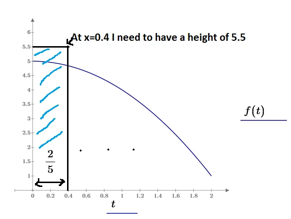

So, I need a function in which that if we give the Width and the Height of a rectangle, that function to draw the rectangle based on the Width and Height. Width to be a parameter that can be modified. Height to be a parameter that can be modified.

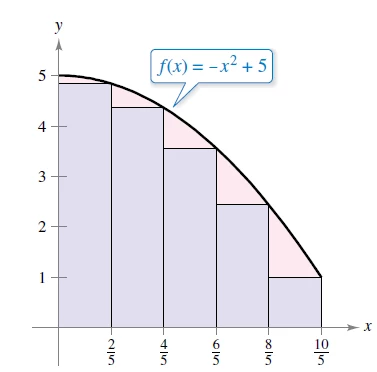

The above case is for inscribed rectangle.
@ttokoro
But there is a second case (circumscribed rectangle):
The left endpoints of the five intervals are:
where i = 1, 2, 3, 4, 5. The width of each rectangle is :
and the height of each rectangle can be obtained by evaluating f(x) at the left endpoint of each interval.

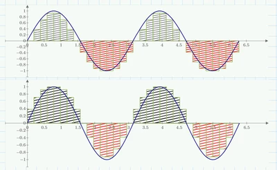

Jul 31, 2023 5:14 PM UTC
Again Prof. Birkelands Hatch functions can come handy.
Look up his examples for the Riemann sums and also for the trapezoid method in the already posted file.
You may also be interested in this thread
https://community.ptc.com/t5/Mathcad/Simple-Riemann-sum/m-p/93217
Who knows, some of the files posted there may even work in Prime after conversion.
