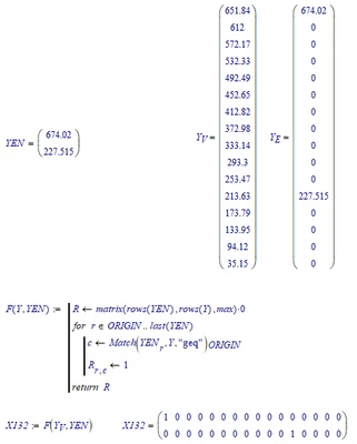

Here is my FORTRAN statements:
      DO 1010 I=1,L
        DO 1010 J=1,NC119
          X119(I,J) = 0.
          X132(J,I) = 0.
          IF(YEN(J) -YV(I)) 1010,1000,1000
 1000       X119(I,J) = 1.0
 1010 CONTINUE
      JAK = 1
      DO 1040 I=1,NC119
        DO 1020 J=JAK,L
          IF(YE(J)) 1020,1020,1030
 1020   CONTINUE
      GO TO 1040
 1030   X132(I,J) = 1.0
        JAK = J+1
 1040 CONTINUE
I include my attempt, results and what I want.

Your Prime  and Fortran programs are different.
Assuming the Fortran code functions according to your desired behaviour (whatever that may be), these are the differences I see so far:
JAK <- JAK+1 should be JAK<J+1
You to place this JAK assigment immediately below the X132 assignment, not below/outside of thye entire IF statement.
X132i,j ← 1
JAK ← j + 1
gives me a 1x12 matrix, not a 2x16.
Ken
23-Emerald V
The "IF(YE(J))" in your Fortran code looks like an IF statement at first sight, but it isn't because it is NOT followd by "THEN".
What does it do? Especially the three numbers following the IF() are puzzling. Are they line numbers? And how are they processed?
In the first Mathcad program (X119) you translated the IF(argument) with "if argument >=0" in X132 you translated a similar construct IF(argument) with 'if argument <=0". Which one of the two is right, 'less than or equal', or 'larger than or equal' ?
It might help a lot if you could explain what functionality you wanted to program. What is the effect that your function should accomplish, in plain text.
