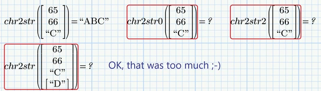

Why are you unhappy with your chr2str function? Its fast and does not suffer from the silly recursion limit.

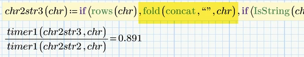

You may speed up chr2str2 a little bit by replacing the call to chr2str2 by the fold command directly.  But speed in no way comes near that of chr2str.
Furthermore chr2str0 and chr2str2 not only are slower, they suffer from another drawback as well:

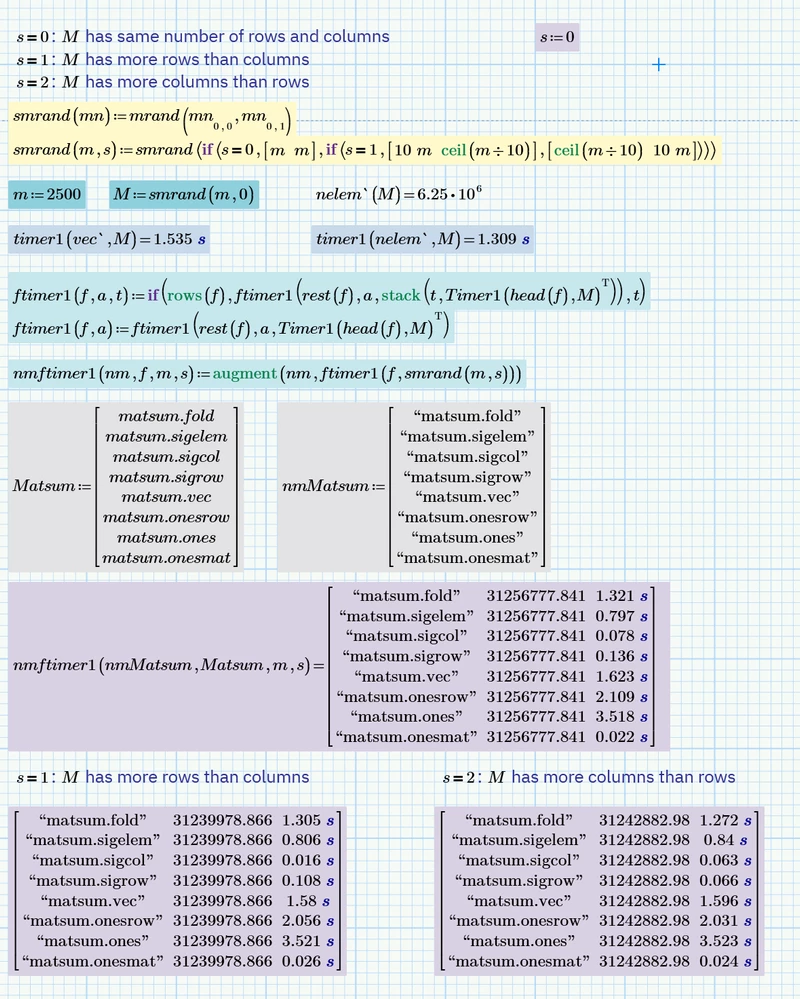

It can also be surprising just what a difference an apparently small change can make to a function's performance.   For example, the marked increase in speed by using update1 rather than stack in my vec function (as mentioned in another thread and as shown below).

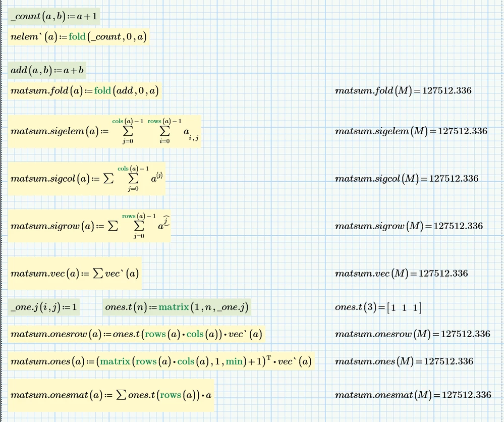

Even some of the matrix summation functions surprised me with how quick they were - look at matsum.sigrow and matsum.onesmat below, especially the latter when compared to the other Sigma operator (S) variants.
Summation Function Timings:
Summation Function Definitions:

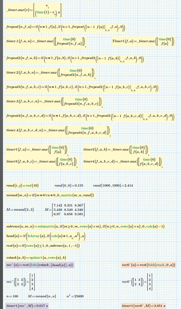

Auxiliary Function Definitions:
