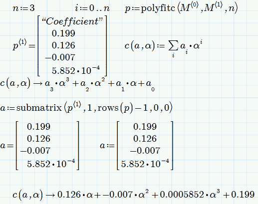

Ok all you MathCad experts, I have a really annoying problem. I have a worksheet that performs the following tasks: data is input via a text file into a 3D array, next it curve fits the data, and finally I want to be able to read the coeffecients of the function. The problem occurs when I try to symbolically evaluate the curve fit. I use a the general form of a polynomial to the nth power to display the polynomial, but when I symbolically evaluate it MathCAD returns the very function that was called earlier. This makes sense, but it is not how previous versions worked. Anyone know of a symbolic modifier that would fix the issue? I attached the document with a similar example; the real version is proprietary.
Thanks all!
Jacob

I would consider that a bug.

May be so?
Viktor

Jacob Stockton wrote:
... but it is not how previous versions worked.
What makes you think so? I've just tried M11 and it exhibits the same behaviour (though I had to use genfit, as it doesn't have polyfitc).
Alan
