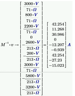

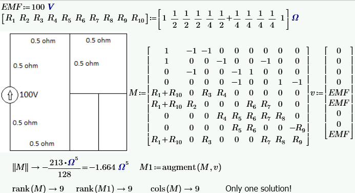

One circuit-fractal problem
Can we calculate I1, I2, I3...Iinfinity of this electrical circuit?
The first steps is here - http://communities.ptc.com/message/229536
