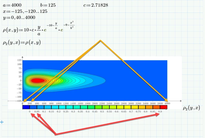

Unfortunately Mathcad 15 does not offer a way out of the box to add a legend to a contour plot. This is one of the few improvements in Prime. On the other hand, in Prime you have not much control over the colors used (in Mathcad you can provide your own color map) but can just chose among a handful. Also I don't think that you can add your parabola in the Prime plot.
Anyway, for whatever it may be worth - here is what Prime can do for you. You may also notice that on contrary to a surface plot you are able to stretch the contour plot (isolines plot) the way you demanded. I added the arrows to show which values you can change directly in the plot to have more control over the number of isolines, etc. basically the first, second and last value in every scale.
I used the Prime file you posted in your initial thread. I would prefer the approach with "CreateMesh" but in this file I didn't change your approach with the range variables and of course they work OK, too.
Of course its possible to add a legend in Mathcad, too, but you have to create it yourself. Basically you add a second contour plot of a simple plane and have to take care to use the same color map and the same max and min z-values in both plots.
The need for a legend in contour plots resulted in a lot of questions for them in this forum quite a while ago. I attach one of my answer files (could't find the thread it stems from) with a possible solution.

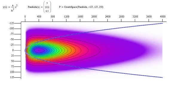

One possible way is to turn the parabola into a 3D parametric curve, use "CreateSpace" and add it as an additional plot, which you have to format as "Data points"/"Scatter Plot". You can decide to omit the dots and just draw line segments. The distance between the dots can be controlled by the last argument of "CreateSpace".
It was necessary to give the curve some "height" (here 0.5) to avoid the curve being covered up partially by the surface plot. Another way to cope with this could be to add some degree of transparency to the surface plot.

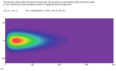

The MC15 sheet is now attached.

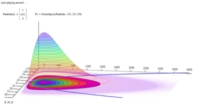

I also played around with transparency and added a true contour plot as a ground base.
If you would like to use the built in contour plot only, you have to change the arguments of the function to achieve the same plot as yours because we have not other way to change the axis orientation in the contour plot.
