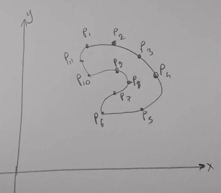

Hello everyone, I have determined 12 points individually (2D). I want to plot a closed curve between these nodes and I want to have many nodes on this pattern?
I drew an example sketch and uploaded as adding.

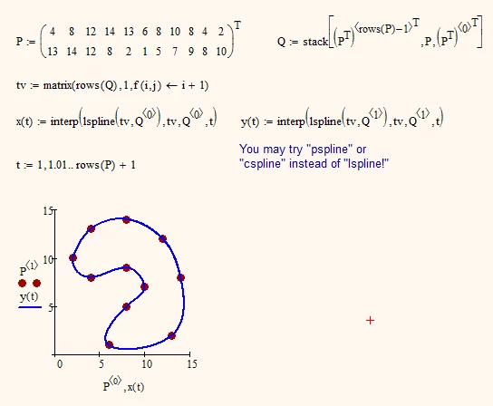

Here is a quick and not quite elegant hack using Mathcads built-in splines. Would it help?

Unless you have an idea of how to describe the relationship that defines these nodes this is going to be a long, torturous path:
  • If you need a plot of y(x) vs x the existence of different values of y for the same value of x is going to be problematic.  You need to "parameterize" the problem, plot x(z) vs y(z) where z is a linearly valued parameter.  (You can plot a full circle as x(r,q) := r cos(q) and y(r,q) := r sin(q), with 0<q< 2 pi.)
  • What the parameterized equations might be for your data is the challenge.  If you know the forms of the expressions, Mathcad can find the values of coefficients that form a "best fit."
Just 12 points? Hope you also know the order they have to be connected. You might want to look up the theory behind Bezier curves.
And no, it has nothing to do with an ellipsoid, which is a three-dimensional body and it seems all you are asking for is to connect or approximate your points with a two-dimensional smooth closed curve.

You're totally right. I edited post. I don't know why I just stuck with the wrong word. It's not even eliptical. It's like all you say: "a two-dimensional smooth closed curve"

Werner_E25-Diamond IAnswer
tasdemirg1-VisitorAuthor
This look pretty simple and nice.Thanks a lot really. I was eating my mind with the previous solution above. It works out for me if only I can attend extra nodes on this curve.
How do we create nodes automatically on curves? Let's say I'd like to have 50 nodes on the curve.
I need to have matrix that contains nodes on this curve in order to put in an equation.
23-Emerald I
Werner has created a parametric graph--- functions x(t) and y(t).  These will give a value of x and y (a node) for any value of t.
