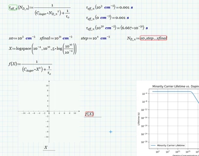

Im trying to plot, lifetime as a funct. of doping, and abs. coefficient as a function of wavelength. I've looked up some videos and good instructions from this Solved: How to produce a log based range variable or plot ... - PTC Community but I have a problem getting the plot to show while defining the range correctly, ie, units for the start and stop, adding steps. I can pull it up with python but not with Mathcad and I can't find out why. thank you,

It would be a good idea to make the function QE_emit work OK with a single scalar value of lambda (without any vectorization). Once you have tested that function, you can call it vectorized with vector argument(s).
What I noticed so far:
When you write a(lambda) Prime assumes a function a, which does not exist. If you meant a * lambda you would have to explicitly write is a multiplication. So you would write e.g.
but I still wonder as you defined x being zero, so this expression would always be constant 1
As you now multiply by a (which has unit 1/m), there is again a unit mismatch because now the exponent again is not dimensionless but has the unit meter.
You could make x dimensionless again, but you would run into problems with the sinh and cosh function. Their argument must be dimensionless, too, and as Ln is a length, xj must be a length, too.
Further unit mismatches in the expressions
and
where one summand is dimensionless while the other is  a length.
So you have to fix the unit mismatches in your formula first, then set up the function in a way that it works for a single argument lambda and the n you should be able to call it with vector arguments.

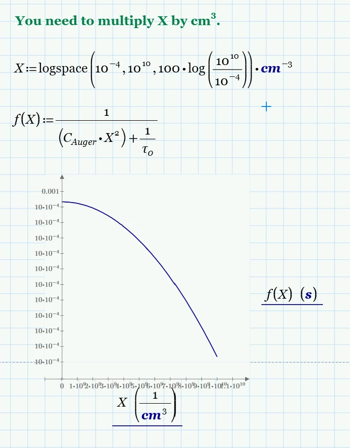

You have a unit incompatibility error.  Your X is unitless, CAuger is cm6/s and t0 is s.

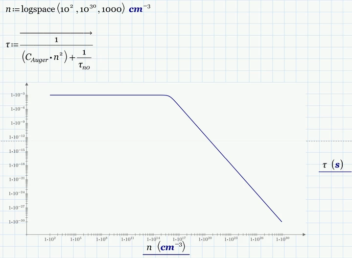

Just answered your question in the old thread before I saw your new one here 😉
See Solved: Re: Circuit ODE set up and solution - symmetrical ... - PTC Community

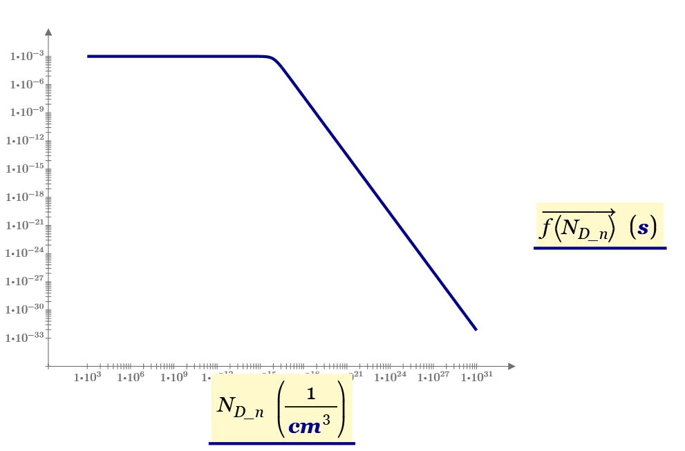

I found that 100 points would suffice for a decent plot. The way you had used logspace would only create 70 points which may be a bit too coarse. Stuart increased to 1400 points 😉
BTW, while its not necessary to use vectorization because X^2 is an operation not defined for vectors and so Prime would apply automatic implicit vectorization, I would nonetheless suggest to use explicit vectorization on f(X). Just good habit IMHO and it avoids unexpected results if some day you define a function differently. You see the difference if you replace X^2 by X*X 🙂

I thought I'd changed the x-axis scaling to logarithmic before posting, but clearly not.  However, when I corrected that deficiency (and extended the range ... I didn't know why the OP had chosen those values and assumed they had some reason to do so), the plot still looked different to what I expected.  I rewrote it to match what you'd written (in case I missed something obvious or some other weird interaction was happening), but I got the same plot.  So, in desperation, I deleted the plot and created a new one (with log axes), and hey, voilà, success.

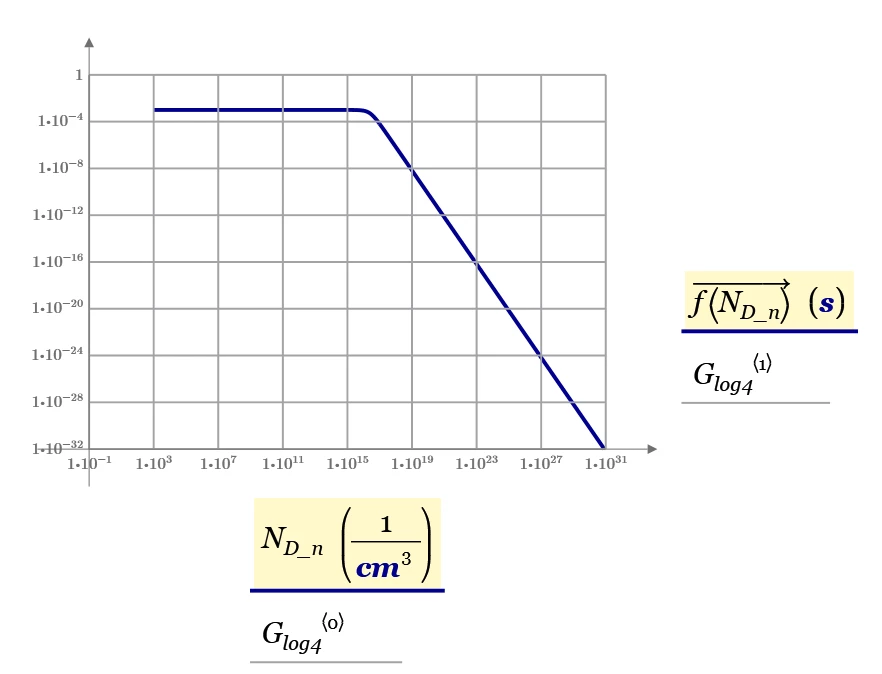

What shall I say ... its Prime time 😉
I also noticed just now when the axis is scaled logarithmically, Prime does not allow to change the second value on the axis and thus controlling the step width.
I wanted to change the exponent to show every fourth to match the picture, but I only was able to set the top value on the y-axis to 10^-3 and the bottom one to 10^-30, but I was not allow to change the second value from 10^-27 to 10^-26. That's silly and an unnecessary restriction!

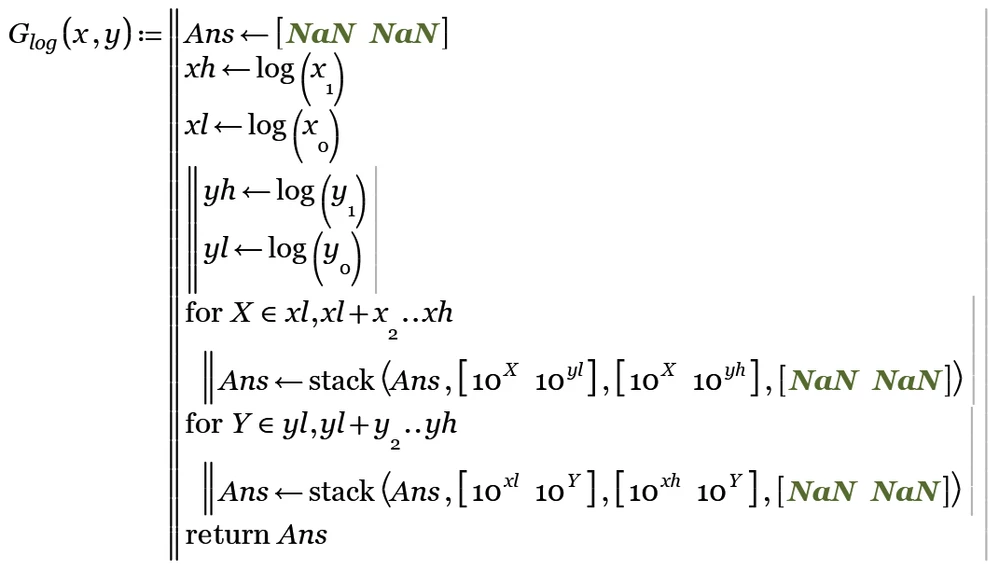

Sep 29, 2024 1:55 AM UTC
I was looking at this matrix operation in your sheet, and I need to find a good video to learn it. Can you explain to me what is happening in this calculation?
