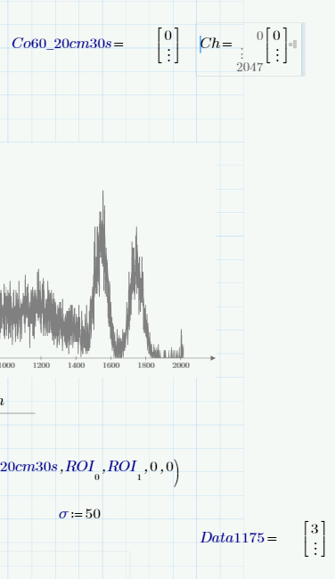

May 14, 2010
Wish that I knew where that spot is!!
In the attached image, you can see that I was working with the matrix Ch. I was shrinking it vertically. Then I noticed that all 3 matrices were shrinking at the same time. Then M' went nuts. Changed the color of Ch here and in the plot to black. Turned the plot color gray. The doc scrolled up and down by itself for several minutes, then stopped.
Then, too, the attached M' file works in M14, but not here. 2 CPUs @ 85%, but never ends...
