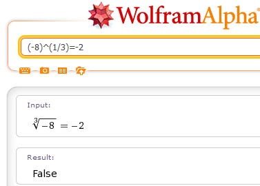

Power function, especially those with non-integer exponents and negative arguments, are not so simple as they might look on first sight. What I wonder is, why to Mathcad there is a difference between (-8)^(1/3) and cubic_root of -8. Should be the same (and in both cases NOT -2). Look at the screenshot of WolframAlpha below.
