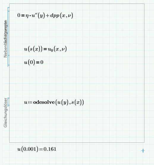

I'm trying to solve an ODE of 2nd Degree (Couette flow):
0 = eta * d²u/dy² + dp/dx
This works out well with the common ODE solver from MathCad as Long as I determin a function for p as Long as:
u is a function of y  --> u=f(y)
and
p is a function of x --> p=f(x).

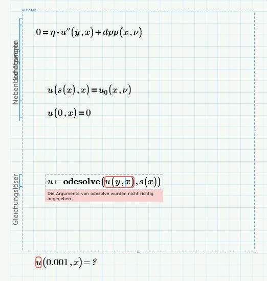

Along the x Axis my boundary conditions and my p(x) change so that "u" is no longer just a function just of y but also of x.
I implement this dependency by declaring my boundary conditions to be fuunctions of "x".
But in the end I cannot declare my "u" as a function of "y" and "x" because "y" is the only variable to be integrated over.
Please refer to the attached screenshots.

23-Emerald V
Seems like what you have is a Partial Differential Equation (or Boundary Value problem). For that you should need PDEsolve, not ODEsolve.
PDEsolve is (still) available in Mathcad 15, for which you have a license due to the fact that you're licensed to Prime (You can install and license Mathcad 15 using the very same license file that you used for Prime).
PTC did not (yet... will they ever?) include PDEsolve in Prime.

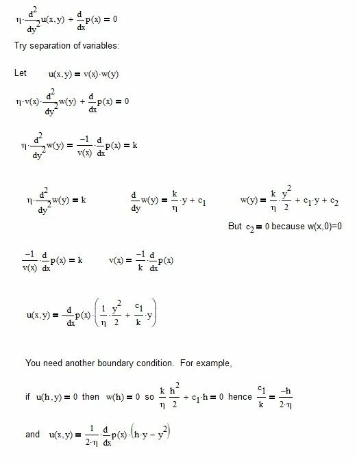

I could be wrong, but doesn't this have the following solution:
Correction: Penultimate line.  Where I wrote  if u(h,y) = 0 then ... I should have written  if u(x,h) = 0 then ...

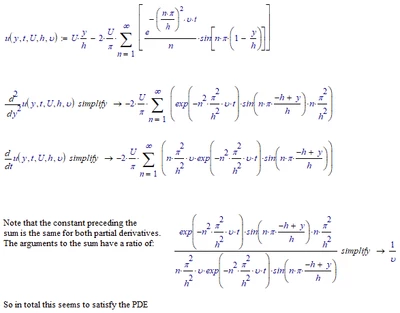

23-Emerald V
I think your answer should be found here: https://en.wikipedia.org/wiki/Couette_flow
If I use the solution to the PDE given there, I get:
Luc,  you've selected a solution to an equation with no dp/dx term.
Alan
