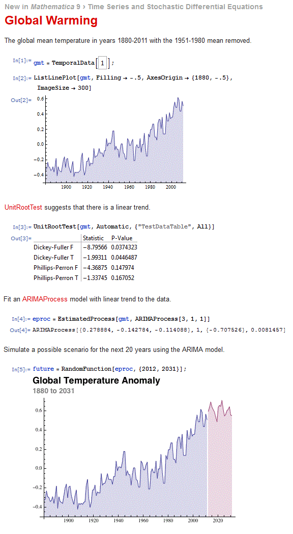

The new Mathematica 9 included:
  • Support for scalar and vector moving average (MA), autoregressive (AR), and ARMA processes.
  • Support for processes with polynomial and seasonal trends, as well as long memory time series models.
  • Full support for simulation, estimation, and forecasting from time series models.
  • Additional time series support for partial correlation function and spectral density.
  • Flexible tests for unit root including augmented Dickey-Fuller and Phillips-Perron tests.
  • Support for parametric stochastic differential equations (SDEs) such as Cox-Ingersoll-Ross.
  • Support for scalar and vector Ito and Stratonovich processes defined by differential equations.
  • Automatic conversion of parametric SDE processes to their Ito and Stratonovich forms.
  • Support for Ito and Stratonovich SDE processes driven by other SDE processes.
  • Support for nonlinear functions of Ito and Stratonovich process with automatic conversion to normal form.
  • Extensive methods for simulation of SDE processes including Euler-Maruyama, stochastic Runge-Kutta, etc.
  • Support for symbolically computing mean function, covariance function for time series, and SDE processes.
See web page.
http://www.wolfram.com/mathematica/new-in-9/time-series-and-stochastic-differential-equations/
