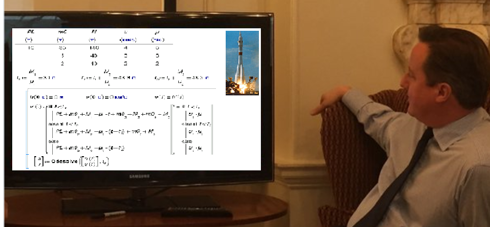

UK Mathcad Prime Minister is one user of our site about rockets calculation
See please more David Cameron watched Tim Peake's space launch and everyone's laughing at him - Mirror Online

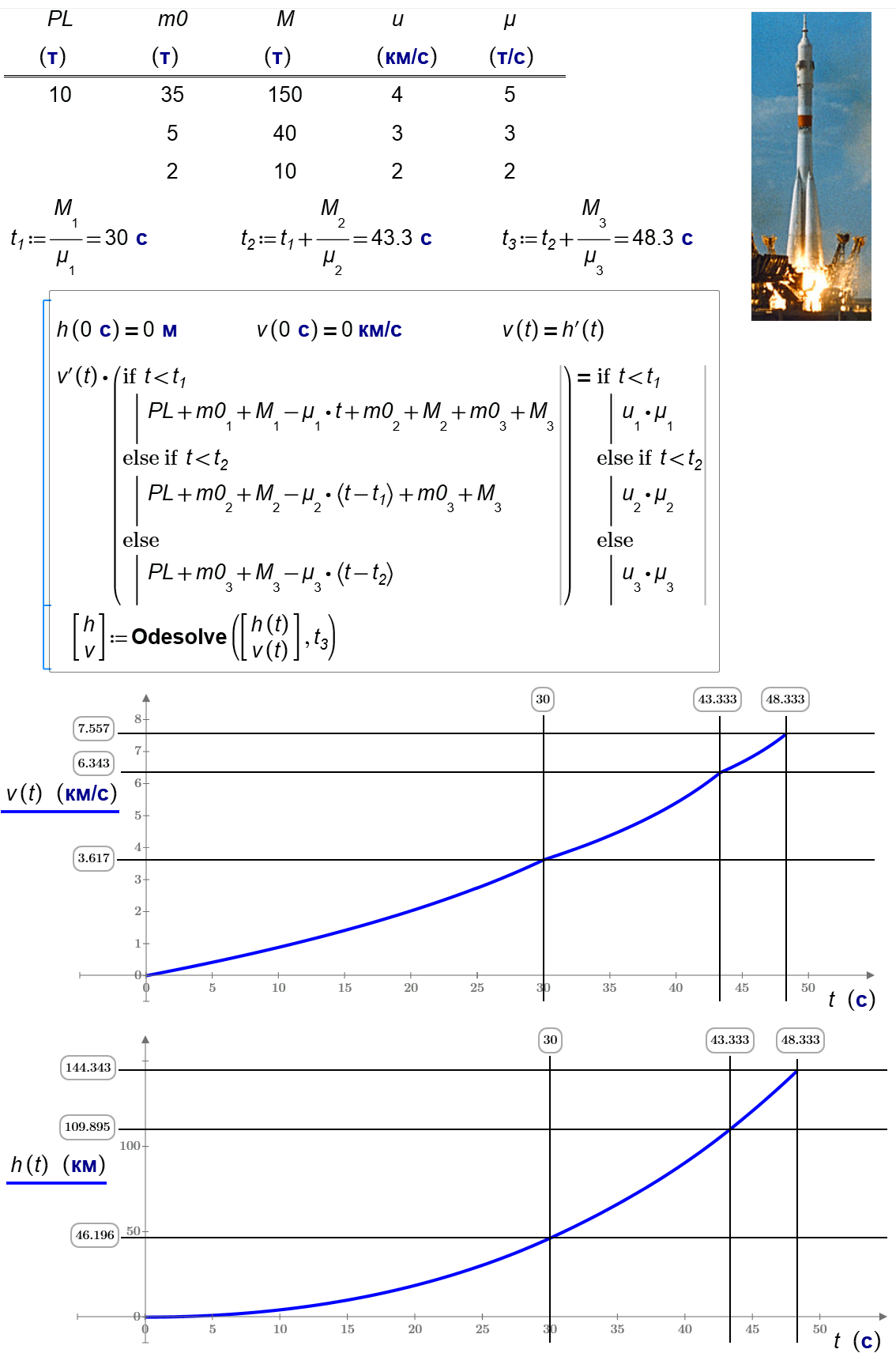

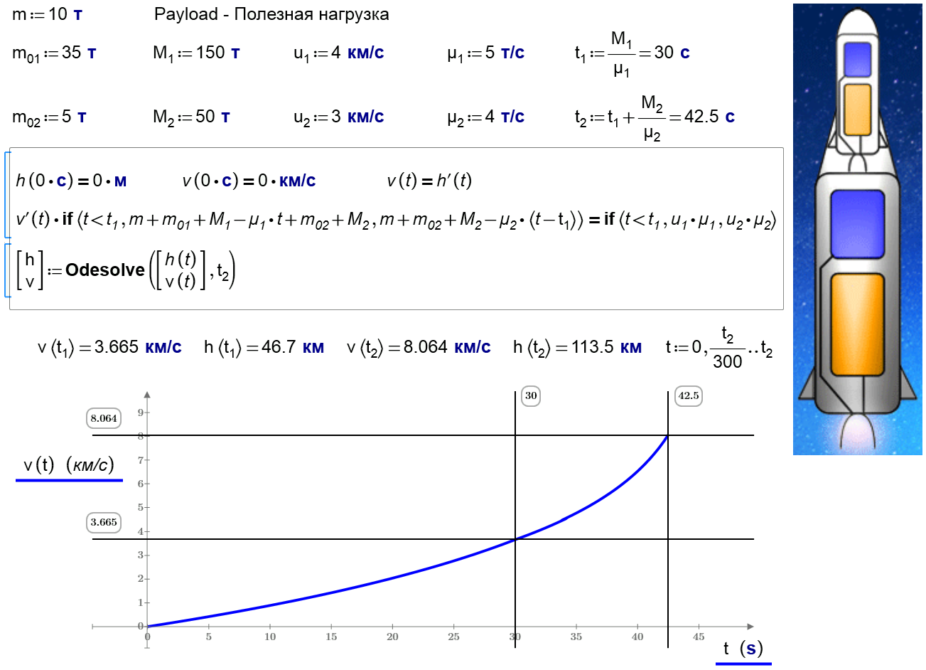

Three stage rocket:
Oct 19, 2015 6:24 AM UTC
Hello Valery,
technically the Soyuz is a two-and-a-half (2 1/2) stages rocket as the four boosters start together with the core stage which continues running after the booster have separated. 🙂
Raiko
Oct 19, 2015 6:41 AM UTC
Tanks, Raiko, I Know it. See please - Союз (ракета-носитель) — Википедия
I would like to solve this task with Союз with my students - see Московский лицей 1502. Класс 10-10
Can you help us? With Alvaro and... Isaak!

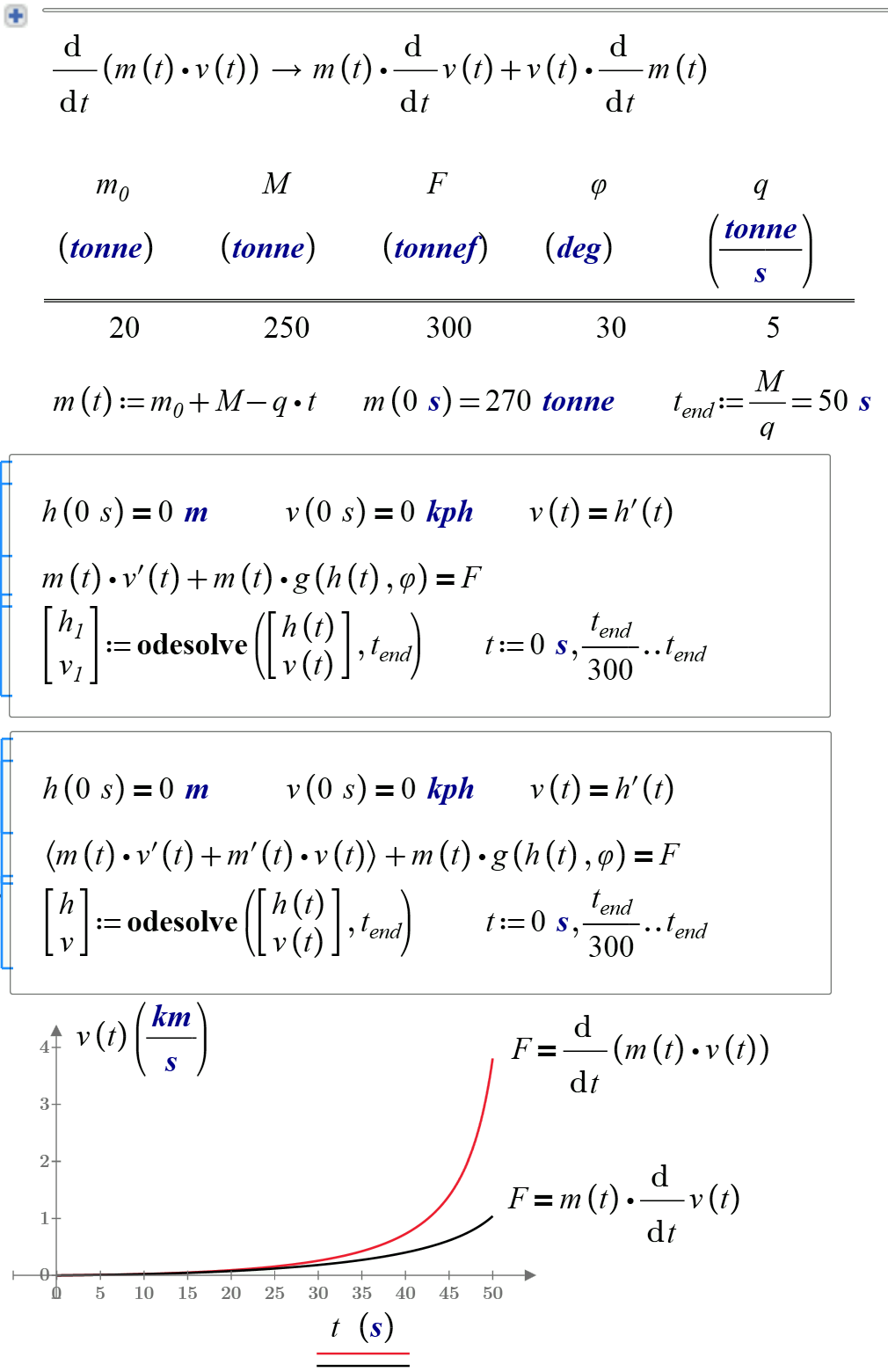

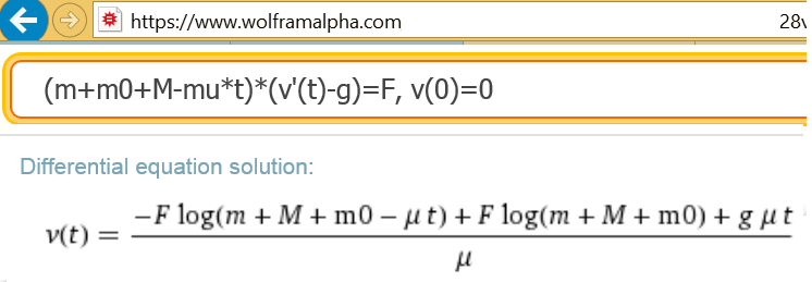

Oct 19, 2015 3:37 AM UTC
Hi Vallery. Nice example. I guess that what you can remark there is that the equation Force = mass x acceleration isn't true!. Newton equation is Force = dp/dt.
Oct 19, 2015 5:46 AM UTC
Thanks, Alvaro.

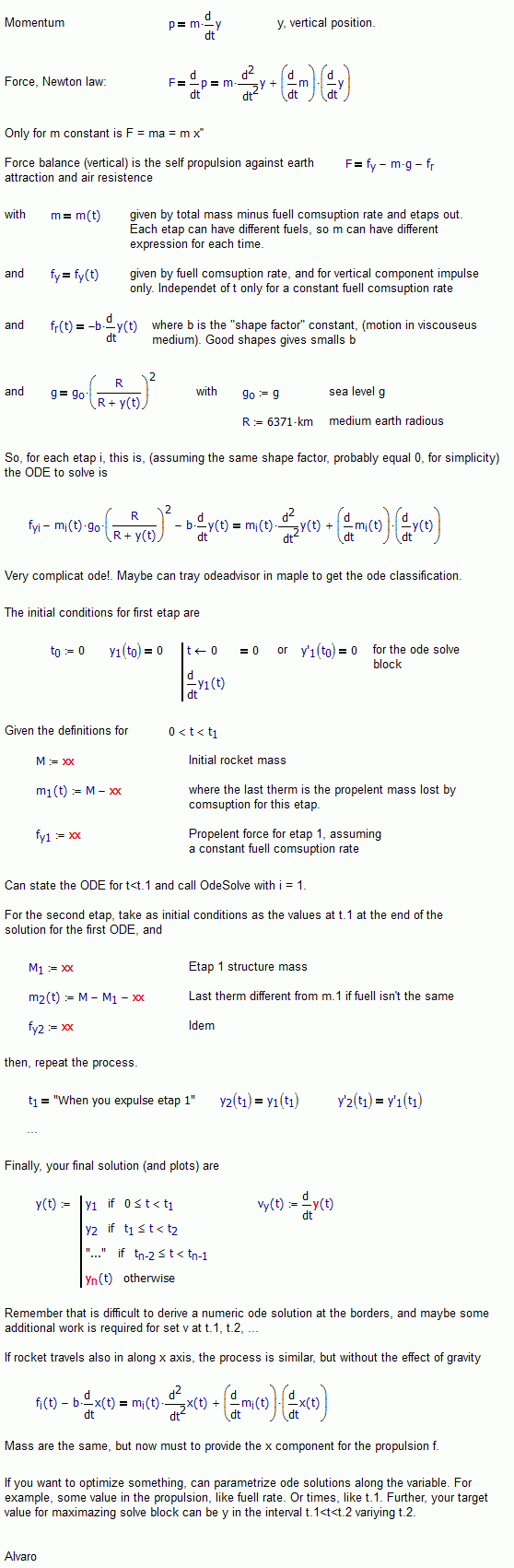

Oct 19, 2015 9:40 AM UTC
Hi Valery. Hope this helps.
Best regards.

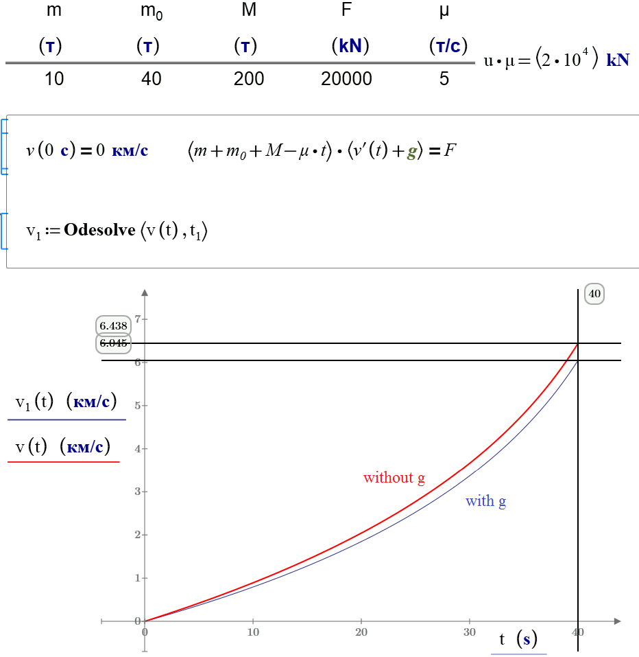

Oct 24, 2015 10:43 PM UTC

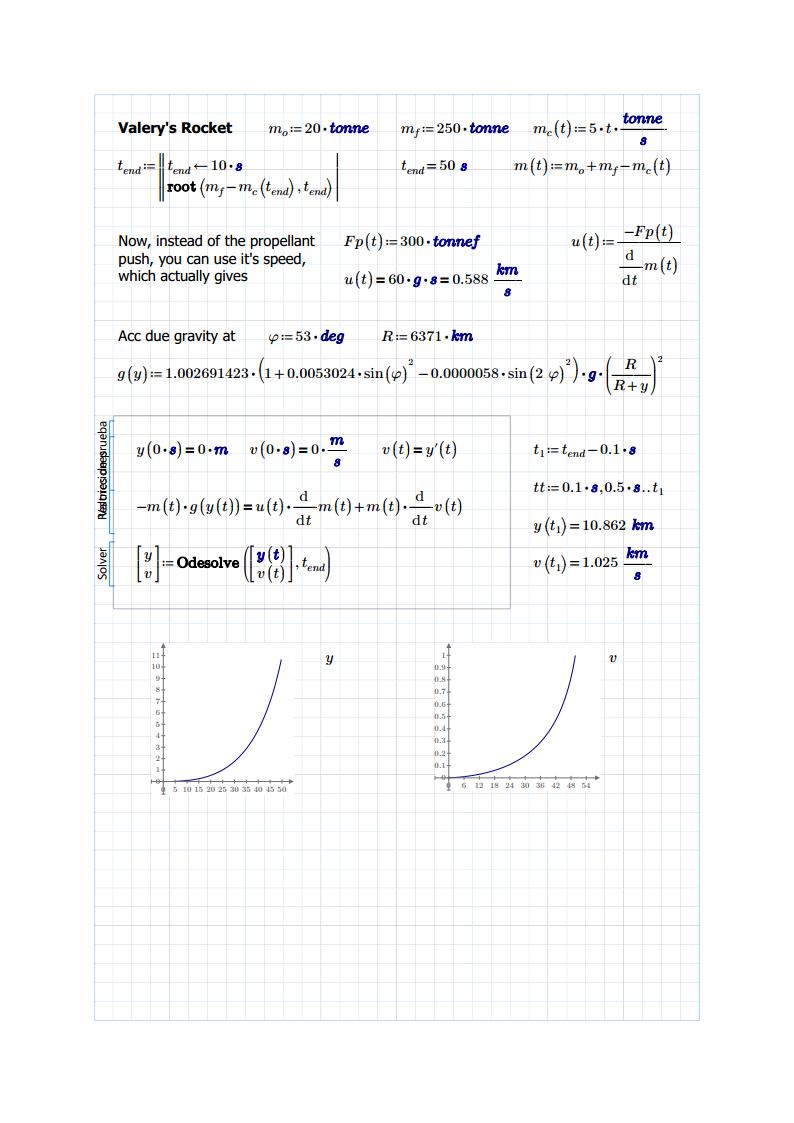

Well, attached my solutions.
Results agrees with Un cohete de empuje constante (pages uses java, chrome don't support java), but there g=0. About original Valery question, "which's the target" for optimize the rocket, I guess that he want the "perfect" rocket, avaible in the same web: El cohete "perfecto"
Best regards.
Oct 25, 2015 8:55 AM UTC
Oct 25, 2015 11:40 AM UTC
Hi Valery. As usual, you're right. First solution gives the correct h,v. But, can you deduce from there the kinetics energy, for example? My point is that the relation F = - u*dm/dt gives the correct understanding, and the correct generalization for the Newton law F = dp/dt.
Best regards.

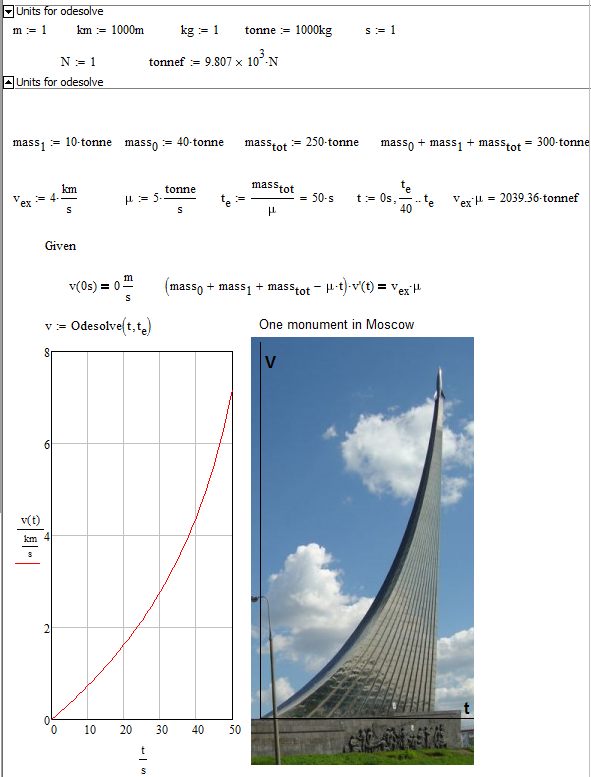

Hello Valery,
I have problems replicating your first equation in Mathcad 15. I got rid of the units by using UnitsOf(xyz) but still it doesn't compute. any advice what I'm doing wrong apart from not working enough with ODEs?
Raiko
Sorry, I forgot to add the sheet
Oct 26, 2015 8:42 AM UTC
Please

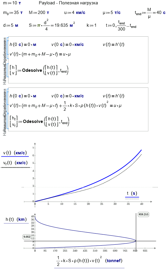

With friction, one stage rocket (please see the picture and Mathcad 15 - Mathcad Prime sheets in attch)

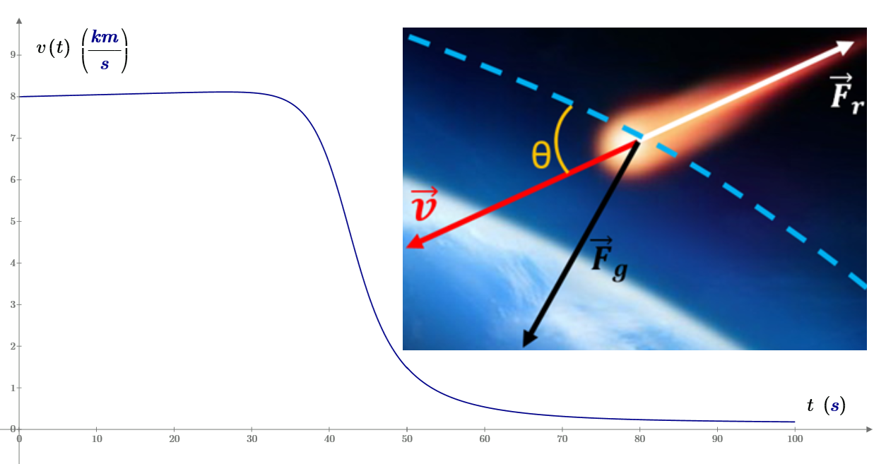

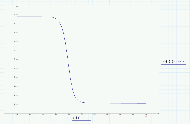

Oct 31, 2015 7:40 AM UTC

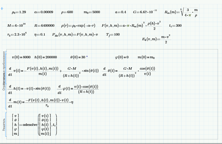

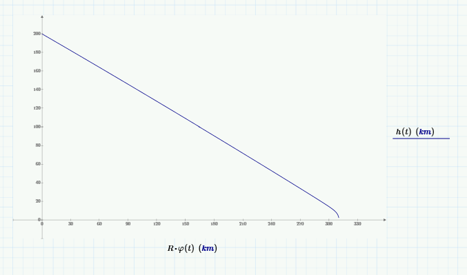

The movement of the meteorite in the Earth's atmosphere with a view of the ablation
It is interesting to note the sharp braking and intense pulsed energy of the meteoroid at low altitudes, as well as the trajectory in the final phase of flight.

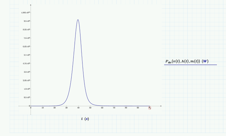

Oct 31, 2015 10:34 AM UTC
Fine!
Will be good to show one-two plots:

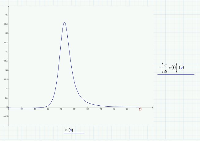

Oct 31, 2015 11:19 AM UTC
Thank you!
In my opinion, the most interesting are the destructive shock acceleration (~70g!)...
powerful thermal flash (10GW!) and a sharp decrease in weight...
and a significant change in the trajectory at the end of the flight

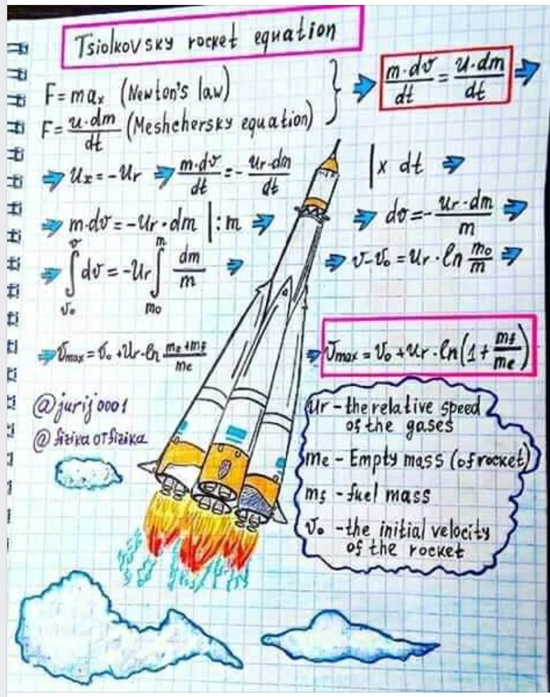

sorry, but remaining calculations are too complex for me, besides no practical value, they do not have.

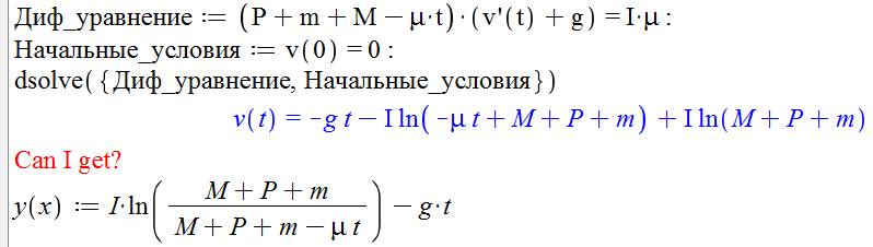

Feb 22, 2016 7:57 AM UTC

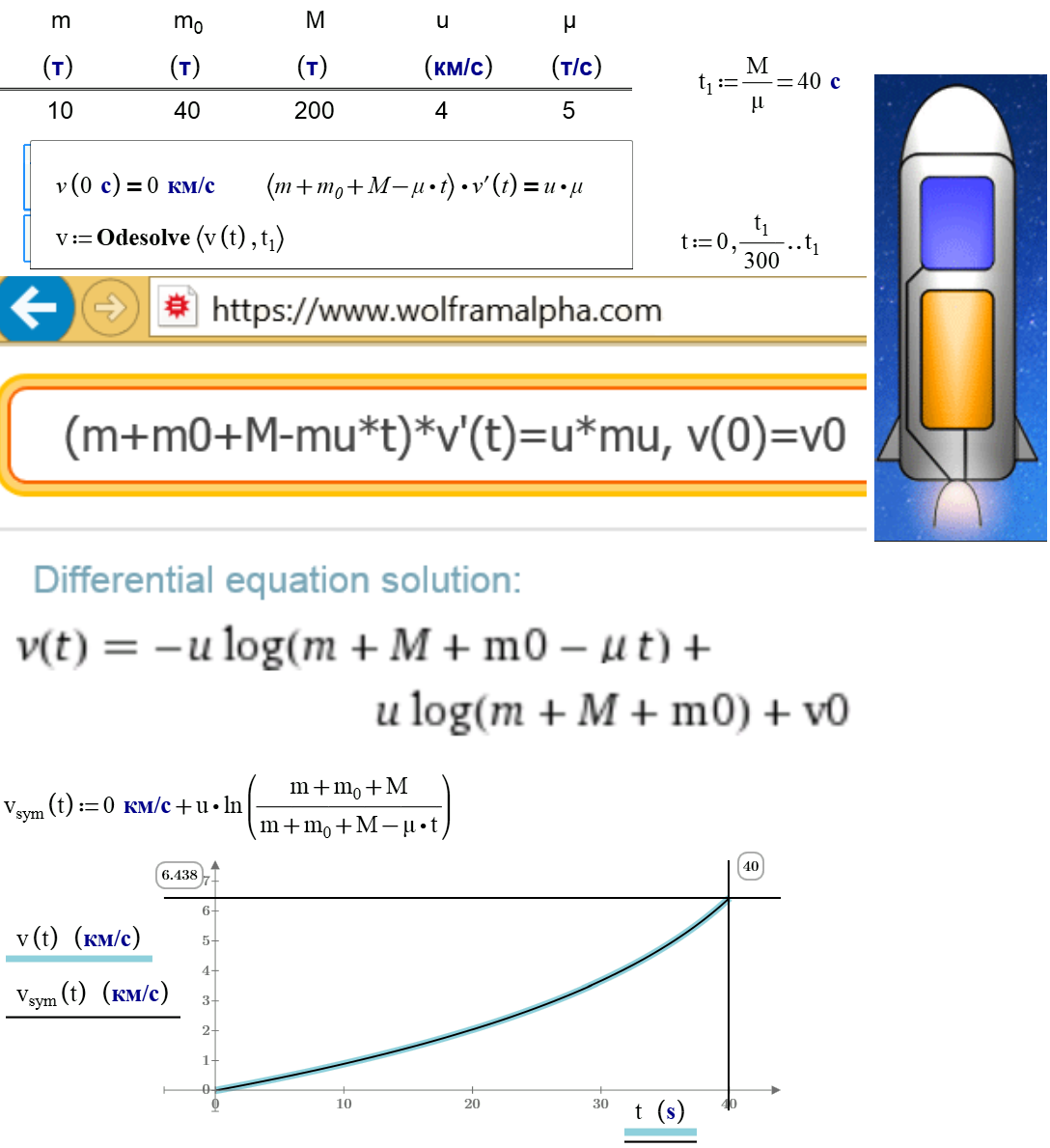

One question
Feb 22, 2016 8:28 AM UTC
Не совсем понятно. Последнее выражение это v(t) в сокращенной записи. (а не y(x))
