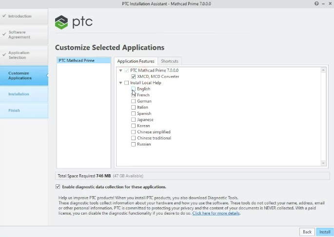

Did you follow this step by step guide? "How to Acquire 30 days License for Mathcad Prime 7.0?": https://community.ptc.com/t5/Mathcad-Installation/How-to-Acquire-30-days-License-for-Mathcad-Prime-7-0/m-p/721613#M413
August 19, 2022
Starting from the 7th version of Mathcad Prime you can use the built-in converter (before the installation process, it is necessary to select it among the installation components).
