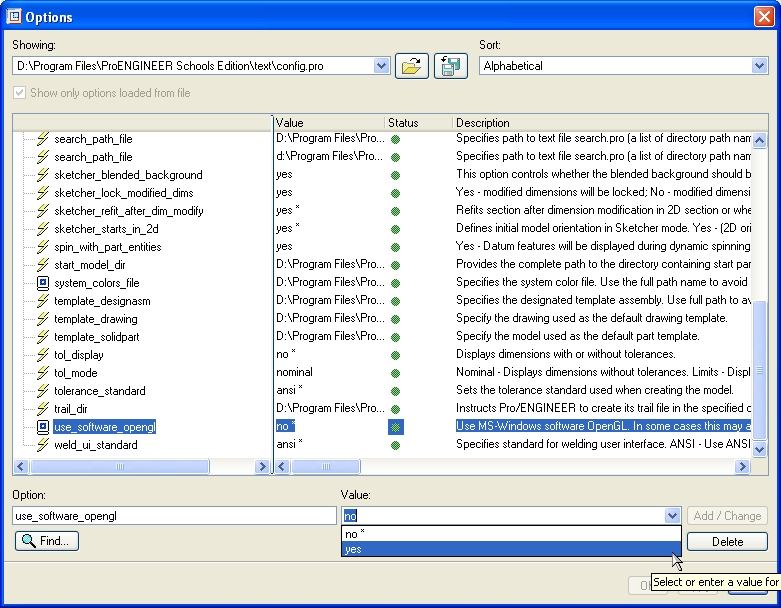

I have a weird problem running creo 5. It doesn't happen all the time, in fact I couldn't get it to happen for my teacher.When I am in sketch modeand I start to scketch, the screen shows everything i done at the same timeit is really weird.I can't figure out how to make this stop. I.ve deleted and reloaded creo 5 many times and it always happens againi can't use the program as is and I don't have the time to find a machin to complete my assignments. please help.if i move the middle button on the mouse it will go to a proper looking screenbut when I move the mouse to draw it goes back to a funky screen and I can't tell where i am drawing in the mess here is what the screen looks like149.JPG

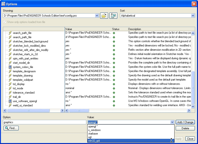

    Your graphics adapter is most likely to blame. A couple of things you can try. Change your graphics option (in config.pro) to win32_gdi rather than Open_gl and restart.
    Else, try setting use_software_opengl to yes... Restart and let us know if either helps...
