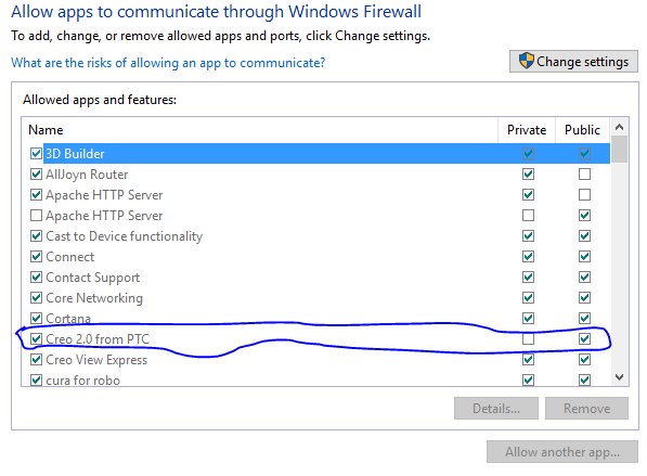

    SOLVED:
    I found a solution that fixed it for me. I've been on many forms and nothing worked, and it seemed like most of the forms did not actually provide a solution or were unanswered. It seems like many people were having the same problem over different versions and builds of Creo, over the last few years. I got Creo 2.0 M130 to work on my Windows 10 computer. I was getting the error message "Creo Parametric is shutting down because it could not run the Quality Agent, which is required in this edition. If you call Technical Support about this problem, report error 0x0000000b." I've also gotten variations of this error message before, usually with a different error code.

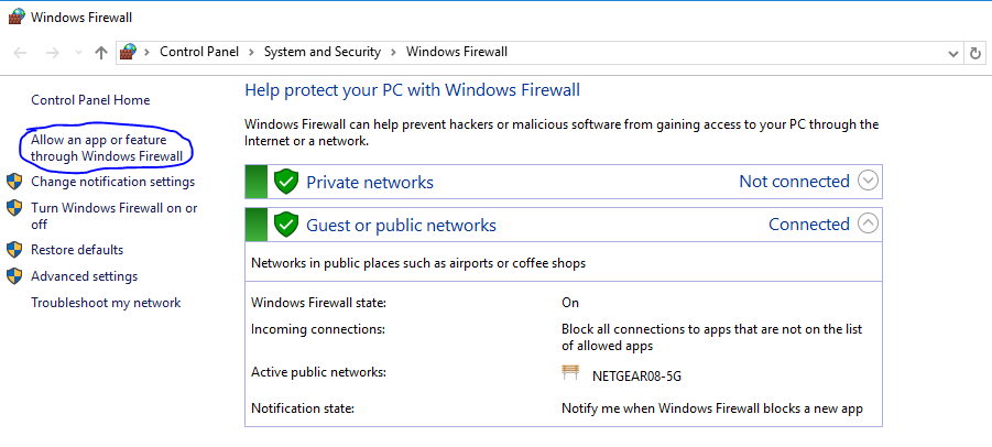

    The only thing that fixed it for me was allowing "Creo 2.0 from PTC" through the windows firewall. Here's how I did it:
    1. Close out of all PTC applications.
    2. Type "Windows Firewall" into the windows start menu, or open Windows Firewall through the control panel.
    3. Click "Allow an app or feature through Windows Firewall" on the left-hand side
    4. Click "Change settings", and scroll down and check the box next to the name "Creo 2.0 from PTC".
    5. Also make sure to check the appropriate box on the right side of the line to allow access to private and/or public networks.
    6. Hit Okay, and attempt to start Creo Parametric.
    This worked for me, I hope it works for you.
