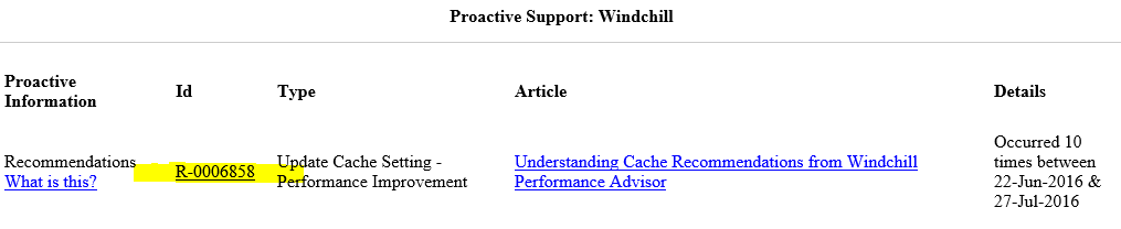

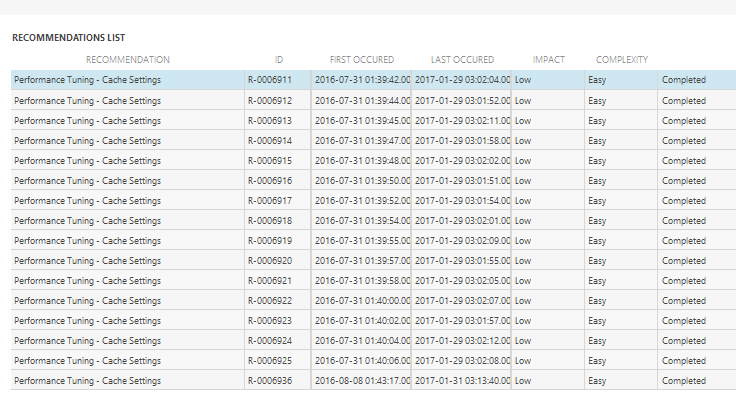

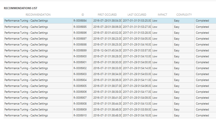

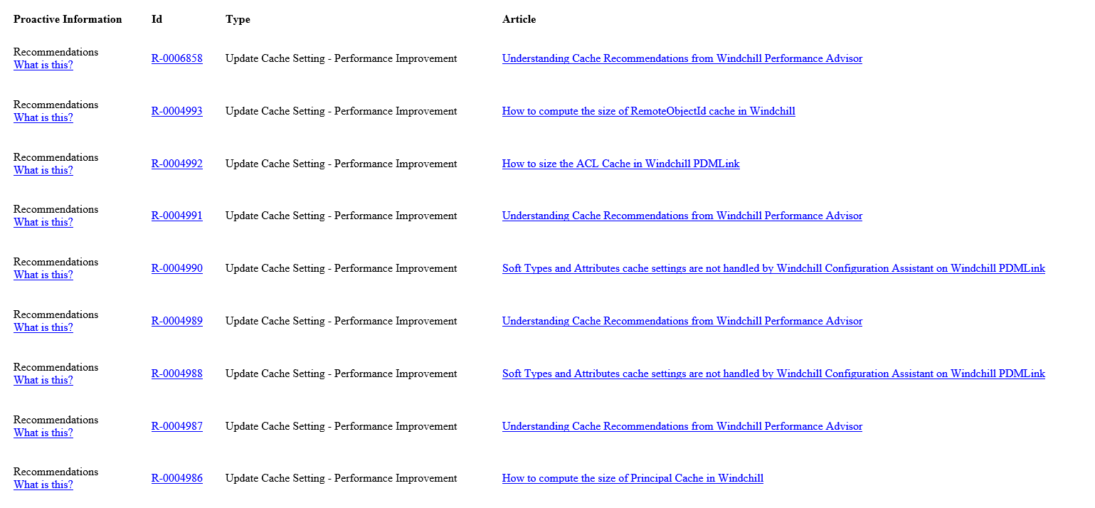

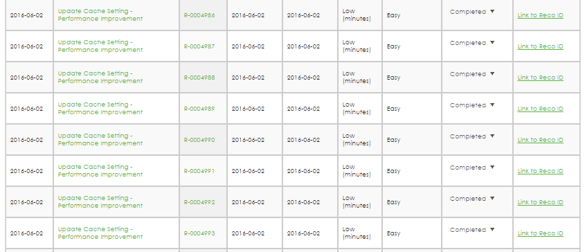

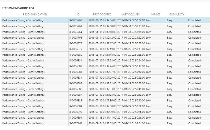

Hi Peter,
sorry if I reach you again, but after a couple of weeks I still receive recommendations for server that I'm not tracking again (you know the issue about rehosting and duplicating server ID).
Take a look at attached images.
The first is for recommendations of our Prod server
The second is for recommendations of our Test server
The third is for recommendations of our Dev server
The fourth are recommendations I got from tech support every day but, as you can see, non of them are about my three connected servers.
In the fifth and sixth image you can see that, in our recommendations list, those that came form TS are already completed and are nearly eight months that they no more occurred.
In the last image you can see that there are completed recommendations that still occurred in the last few days for which I haven't received a single alert from TS.
What do you think about it?
May I have to open a case?
TIA

Hi Marco,
Thank you for sharing these images, which clearly describe a disconnect you're seeing. I spoke with Jean-Christophe Coynel yesterday, who heads up Proactive and Digital Service Delivery, and he and his team would like to be involved in this conversation too.
I'll speak first to one issue that's on my radar, and is currently slated for a fix in our next major web release in April: "Do not send proactive notifications once a user has set to Snoozed, Ignored or Completed". This will at least improve the relevance of the alerts you receive, but as all 9 of the recommendations in your email screenshot are already completed (screenshots 5&6), this would mean that you would currently receive no alerts.
Reading through your post again, I'm understanding that your main concern is that you have followed articles linked to recommendations we sent to remedy some problems, you set them to completed, but the errors are still occuring.
