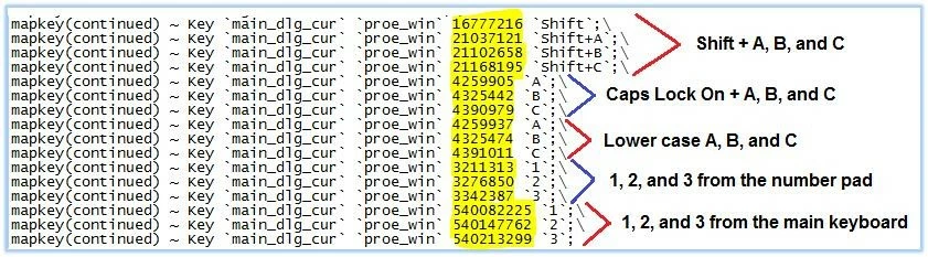

If you feel like manual editing, it seems like you can remove all the extra "common" numbers:
mapkey tom ~Activate `main_dlg_cur` `page_Annotate_control_btn` 1;\
mapkey(continued) ~ Command `ProCmdDtlInsFreeNote` ;@PAUSE_FOR_SCREEN_PICK;\
mapkey(continued) ~ Key `main_dlg_cur` `proe_win` 4259905 `A`;\
mapkey(continued) ~ Key `main_dlg_cur` `proe_win` 4325442 `B`;\
mapkey(continued) ~ Key `main_dlg_cur` `proe_win` 4390979 `C`;\
mapkey(continued) ~ Key `main_dlg_cur` `proe_win` 4259937 `A`;\
mapkey(continued) ~ Key `main_dlg_cur` `proe_win` 4325474 `B`;\
mapkey(continued) ~ Key `main_dlg_cur` `proe_win` 4391011 `C`;\
mapkey(continued) ~ Key `main_dlg_cur` `proe_win` 540082225 `1`;\
mapkey(continued) ~ Key `main_dlg_cur` `proe_win` 540147762 `2`;\
mapkey(continued) ~ Key `main_dlg_cur` `proe_win` 540213299 `3`;\
mapkey(continued) ~ Key `main_dlg_cur` `proe_win` 3211313 `1`;\
mapkey(continued) ~ Key `main_dlg_cur` `proe_win` 3276850 `2`;\
mapkey(continued) ~ Key `main_dlg_cur` `proe_win` 3342387 `3`;

Yes, the codes are required.  The character displayed at the end is to help with readability.  It has no impact on the value actually used.  From my post here:
"Mapkeys are still editable, but the text they enter is not intuitive.  Each letter is represented by an 8 digit code.  This code is different for upper case, lower case, and where the number is entered (number pad or main keyboard area.)  The letter/number displayed after this code is NOT necessarily the character that will be entered.  (For example, the mapkey text will always show upper case characters even if the code is for entering a lower case character.  To change the text that is entered, you must change the 8 digit code.  Changing the displayed characters doesn’t do anything."
