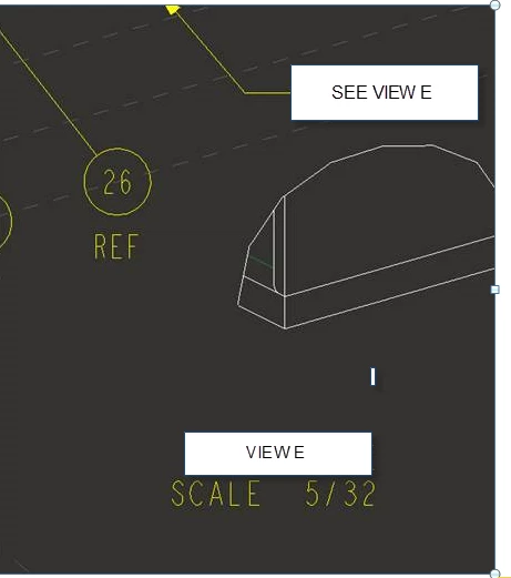

Does anybody know what settings (dtl/config/format file) controls the format used for detail view notations in a drawing?
I have attached two images one from a user's PC with the notation we use and one from a user's PC where the notation is very different.

That is a drawing option and not a modeling option. I remember playing
around with this before and I ended up saving a dtl file for this
configuration.
Take a look at the image that I have included here:

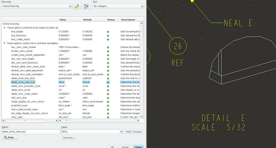

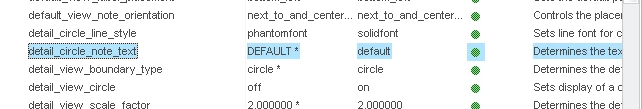

It's detail_circle_note_text and the value should be DEFAULT...seems like an odd value but that gives you the 'SEE DETAIL'
[cid:image001.png@01CFAD60.778515F0]
You can make it anything you want...in this case, I set it do say 'NEAL'
[cid:image002.jpg@01CFAD61.1760B340]

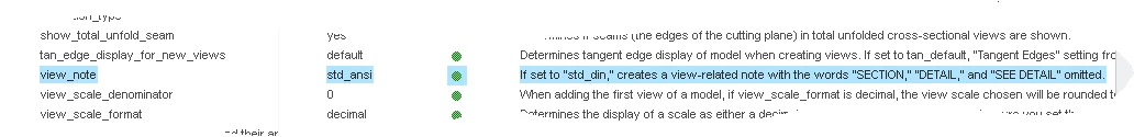

yes, that's a drawing .dtl setting. the name's 'view_scale_format'. defaults to 'decimal' but you can change it to a couple types of outputs.
