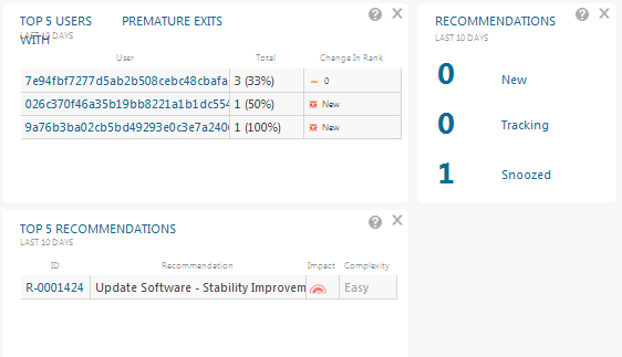

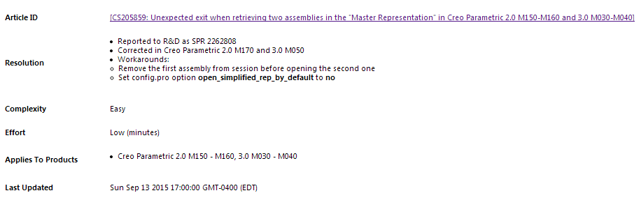

MarcoTosin
September 16, 2015
Wow!
Today is the day I've been waiting for.
Two days ago a user had a crash of Creo.
Now in the recommendations section I found the first from PTC with a solution.
See attached pictures and also link to TS's article
https://support.ptc.com/appserver/cs/view/solution.jsp?n=CS205859
Marco

MarcoTosin
September 16, 2015
This is not the first crash.
I think that it's the first time PTC has a solution to give.
Marco
