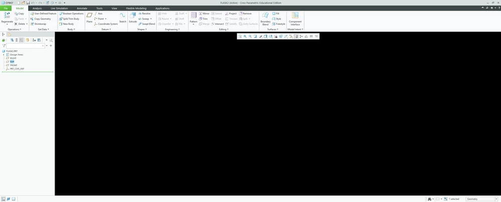

i dont know how to fix this please help

Has it worked before? Or are you just trying it for the first time? What graphics card are you using?
Normally, issues like this are related to graphics cards and/or their drivers.
If you have a config.pro, add the following line:
graphics win32_gdi
You can do this using a plain text editor.
Restart Creo and test. If you can see your model, then your problem is graphics card related.
Edit the config.pro again and remove the line you added.
Update your graphics card drivers, you may have to try different drivers.
Between each driver upgrade, restart your computer.

it has worked before, i have redownloaded it today because i thought at first that it was an issue with the instillation but that didn't fix it.
I'm using an rtx 4070 super.
ill try that code when I'm back at my computer thanks.
also my drivers are up to date.

What version of Creo? Creo 11 messed up one of our user's computers and all he saw was the black screen. Went into Creo options and played with the anti-aliasing settings.

its creo 11
