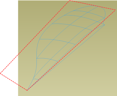

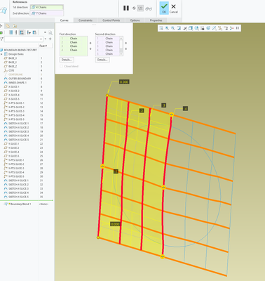

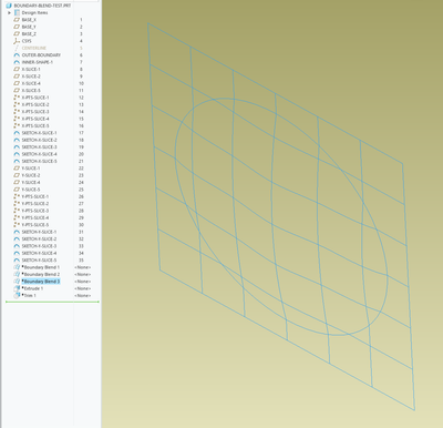

I'm very new at compound surfaces. I'm using Creo 9 and I'm trying to create a surface from a sequence of curves shown in the first few pictures.
In the past I've been successful with using boundary blend to get a basic surface that I need.  However this case is more complicated than normal in that not only do I have 2 directions of curves I also have an outline it needs to extrapolate to.

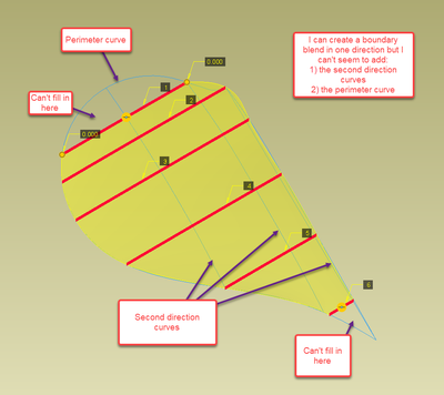

The next picture is a successful boundary blend in one direction (it fails when I try to add in the secondary direction curves) but as you can see it spills out over the perimeter in some locations and doesn't fill in the perimeter in others.  To be honest I'm not really sure how to add in the perimeter curve as a constraint.

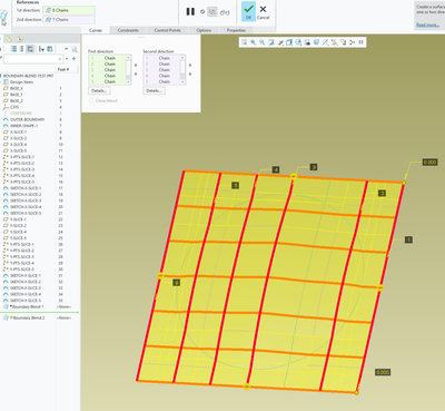

This next picture is the closest I've gotten to a fully filled in outline by selecting the curves in the other direction from the picture above and adding in a selection of the perimeter.  The result as you can see is not desirable as the surfaces have several folds in the them.  I know boundary blend is sensitive to the start point and end point sequence of each selected curve which I suspect is my problem here.
What I'm really looking for is just some tips on the sequence of tools I need to use and any things to watch out for in order to achieve a nicely blended continuous surface.  Am I heading down the right track with boundary blend or am I way off base?

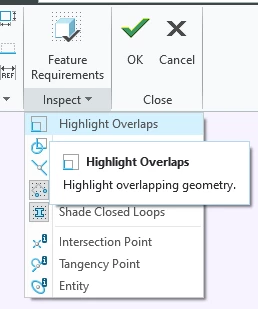

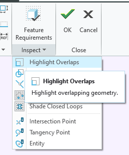

After interrogating your model I found that SKETCH-X-SLICE-4 has overlapping segments.  The center section and the near line are doubled up.  deleting one of each fixed the selecting issue.
The doubled constraints are a clear giveaway of the overlapping curves.  You can also use Highlight Overlaps in the Inspect overflow.

In general, when using boundary blend, you want to have a 4 sided geometry to build the surface. Overbuild your surfaces and then trim them to get the required shape at the outer boundary. The boundaries do not need to be straight lines. The image below illustrates the general problem where you would build a 4 sided surface and then trim it to get the desired shape at the edges. Using internal curves will give control over the topology within the boundaries.

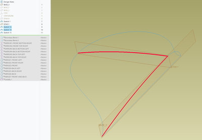

Okay so I have simplified the model and made the model tree a little cleaner for general viewing (my first model was a throw a way model to try the technique) and I'm still having trouble but I don't know why.  I've attached the .prt file to this message but I'll explain with some screenshots.
Model setup:
I created an outside perimeter and an inside perimeter taking note of creating the surface bigger than you need then trim philosophy and also having a 4 sided outside shape.

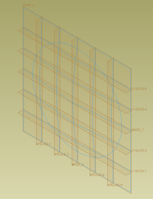

I created a series of slicing planes planes along the x axis and Y axis.
On each of those X planes I created a sketch using the arc command for the curved portion of the sketch.
At each Y slicing plane I created datum points to use as references for Y sketches.
I created the Y sketch curve portions using splines so I could directly intersect with the points created in the previous step.
Then unsuccessfully tried the boundary blend and trim method.
In my model you will see the 3 different attempts I had at creating the boundary blends.  The extrude and trim only works with boundary blend 3.
In blend 1 I could only pick the first 4 curves in the X direction and but I could pick all Y curves in the Y direction. I don't know why I couldn't select all of the X direction curves.
Blend 2 I tried from the other side of the X curves.  it wouldn't let me select SKETCH-X-SLICE-4 for some reason.
In Blend 3 it wouldn't let me select SKETCH-X-SLICE-4 either.
Finally when I did my trim on boundary blend 3 I can see that the circular perimeter isn't planar.  How do I make it so the circular perimeter is planar?
Also because I was mostly winging the dimensions and using splines for the Y direction curves it's not a very smooth surface but it was a quick way for me to try out the tools and hopefully get some feedback.
Help appreciated.

No part file attached.  Put it in a zip folder and attach the zip folder.
I suggest verifying that SKETCH-X-SLICE-4 intersects with all of the Y curves.
Because the surface is not created using the planer boundary curve, the trimmed edge will not be planer.

I've double checked the intersection of slice 4 curve with the Y curves and it looks good to me.  The Y curve was generated using datum points on the slice 4 curve and it looks to me everything is lined up.
I tried to use the perimeter circle to create the curve but I couldn't make it work.  I think I probably need to divide the circle in the sketcher mode so that the division line up with my X and Y planes and then maybe I'll be able to pick it during the blend.  I'll give that a shot.
Attached is the zip file.

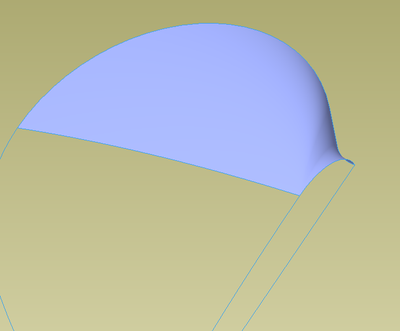

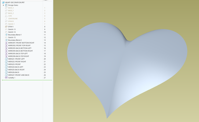

I'm a little in shock and astonished that I finally managed it in about a third of the features I was originally trying. Perseverance is really important with Creo - oh and some good guidance from the experts.  I have one more issue regarding tangency of surfaces that I need to resolve but it's pretty good.
The key was splitting the shape into 4 portions and stitching the resultant surfaces together.  Downloading your model really helped my realize the complexity of my first model thus making the surface generation much harder - I still think it should not have failed - thanks for finding those overlapping segments (insert *embarrassed emoji* here).

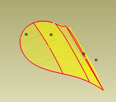

It took me a bit of time to figure out when doing the boundary blend after right clicking to select part of a curve you can then hold shift to add additional segments of the same curve.  I also noticed that it was really finnicky about the order of the mirror. If I merged the left side before I mirrored then the mirror operation would fail.  If I mirrored the surfaces individually and then merged them one at a time I got success.  Maybe more by luck than skill.  Maybe I'll go back and try to reduce the number of merges.

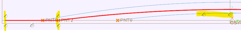

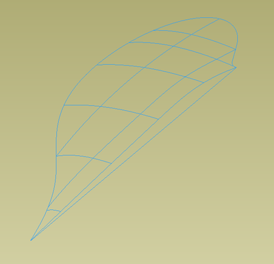

Here is what I did, model attached.

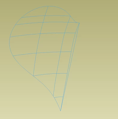

I took my original curve and added a plane so I could create the boundary blend in 2 parts rather than trying to do it all in one feature. That was key.
The curves used for the blend, 2 of the 3 highlighted.
B. Blend 1
B.Blend 2
Then it was just a sequence  of mirror and merge operations to get the full solid.

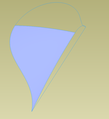

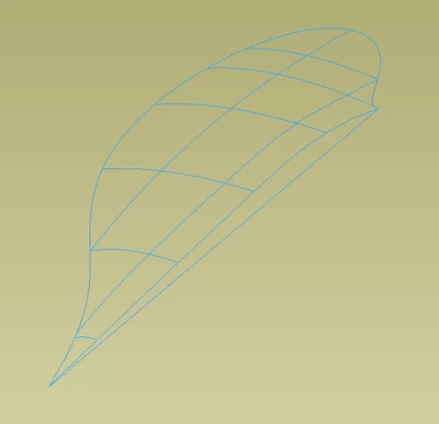

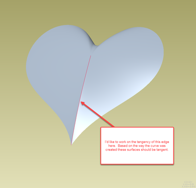

I'd like to figure out the tangency of this piece:
I tried to modify the tangency in the boundary blend control dialogue box but the features fails:
I could just add a round but it would be nice to have the tangency correct.
Next project will be to try and flatten the quilt, add some surface features and then wrap back on the surface but that's a learning experiment for another day.

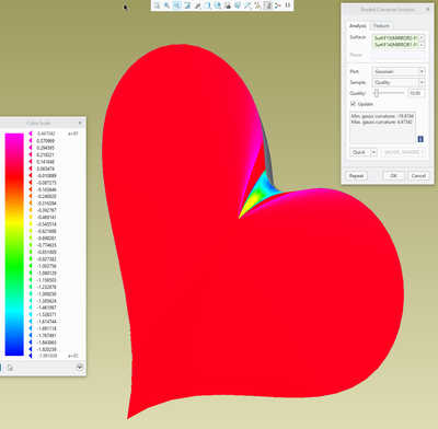

Dec 20, 2025 8:22 PM UTC
