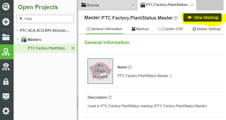

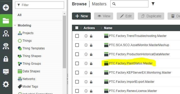

    2. In ThingWorx Foundation Composer, click Browse then Visualization > Master then click PTC.Factory.PlantStatus.Master.
    3. Next click View Mashup button.
    4. Click the App Switcher icon in the upper left.

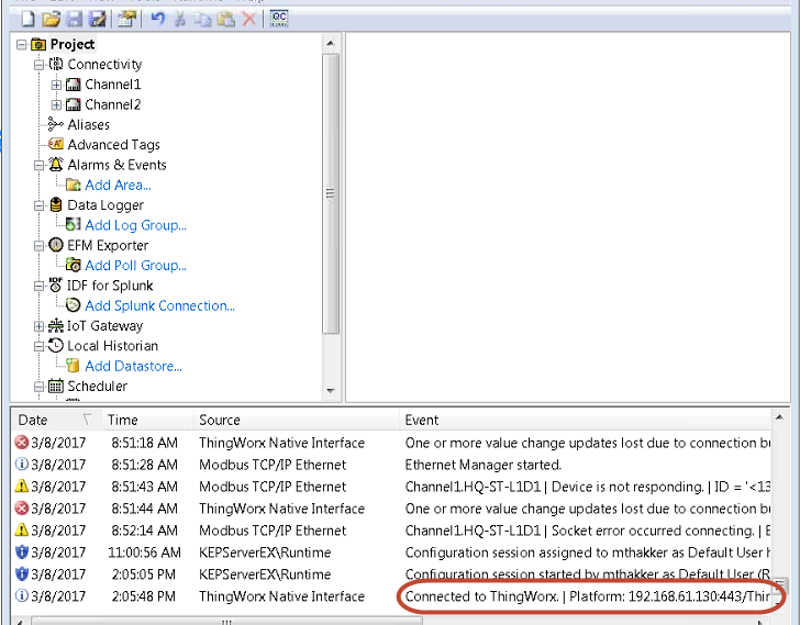

7. Check Connected to ThingWorx is shown in Kepware.
NOTE
: The message displayed should say: Connected to ThingWorx.

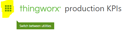

  1. Click the grid icon located in the upper left to switch to a different utility.
  2. Click the Configuration and Setup utility icon.
