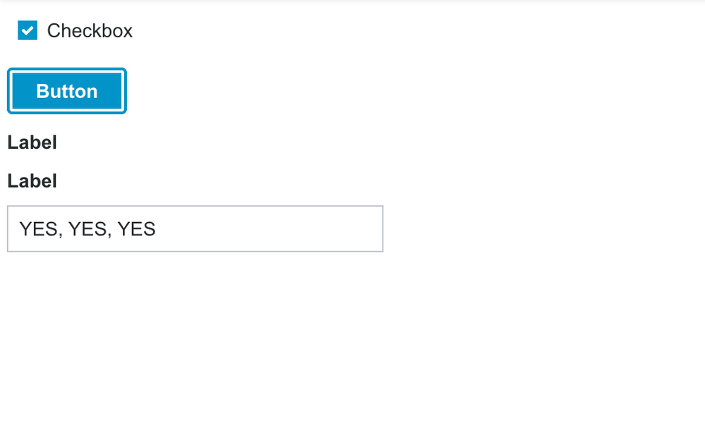

  11. Click View Mashup. Play around and see all the work you've done.
You maybe notice that both Label Widgets show or hide at the same time. To split when they will show or hide, update the code for one of the Label visibility Expressions to the following:
if(checked) {
    result = false;
} else {
    result = true;
Click here to view Part 2 of this guide.
