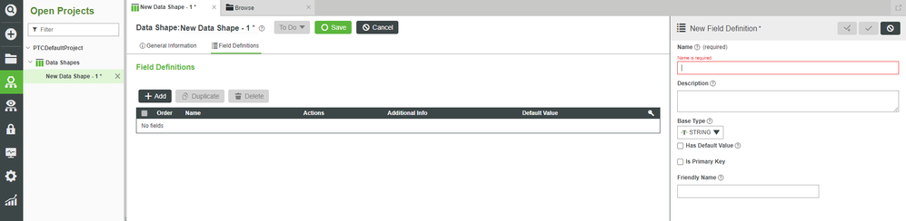

  5. At the top, click Field Definitions.
  6. At the top-left, click + Add.
  7. On the right-side slide-out, in the Name field, type month.
    • Note that you want to leave "Base Type" as the default of "STRING".
  8. Check Is Primary Key.
  9. Click the "check with a plus" button for Done and Add.

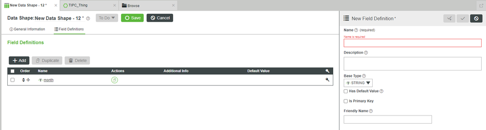

  10. In the Name field, type amount.
  11. Change Base Type, to NUMBER.
  12. Click the "check" button for Done.
  13. At the top, click Save

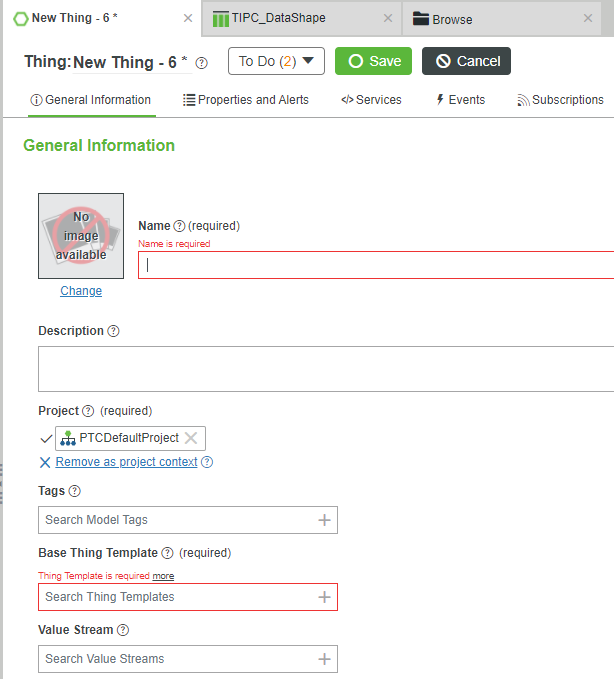

  1. Click Browse > Modeling > Things.
  2. Click + New.
  3. In the Name field, type TPWC_Thing.
  4. If Project is not already set, search for and select PTCDefaultProject.
  5. In the Base Thing Template field, search for and select GenericThing.
  6. At the top, click Save.

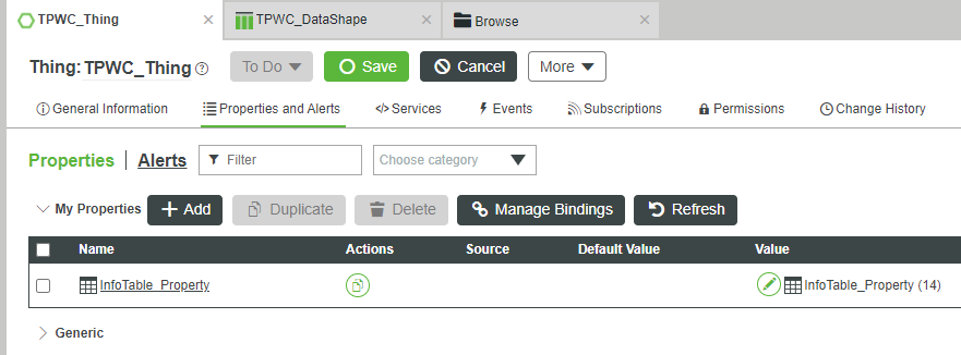

Add Info Table Property
Now that we have our Thing instantiated, we want to add an Info Table Property.
  1. At the top, click Properties and Alerts.
  2. Click + Add.
  3. On the right-side slide-out, in the Name field, type InfoTable_Property.
  4. Change Base Type to INFOTABLE.
  5. In the Data Shape field, search for and select TPWC_DataShape.
    • Note that the Data Shape field will not appear until you set Base Type to INFOTABLE.
  6. Check Persistent.
  7. At the top-right, click the "check" button for Done.
  8. At the top, click Save.

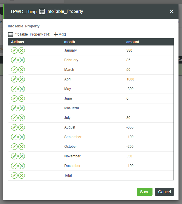

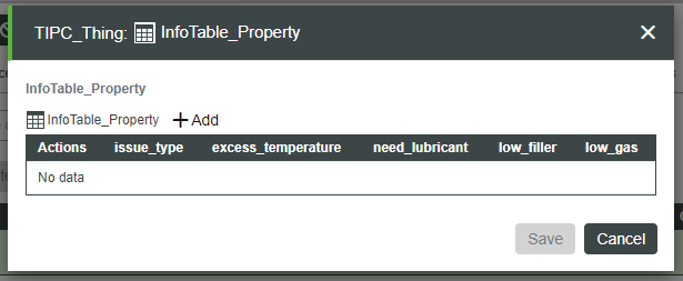

Set Value of Property
Now that we have a place in which to store spreadsheet-like values, we'll do so manually for testing.

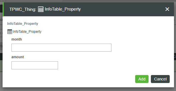

  1. On the InfoTable_Property row, under the Value column, click the "pencil" icon for Set value of property.
  2. On the pop-up, click + Add.
  3. Enter the following values in each field as per the table below:
    Field NameValue
    monthJanuary
    amount380
  4. Click Add.
  5. Repeat Steps 2-4 multiples times until all of the below values have been entered.
    • Note that amount should be left blank for both Mid-Term and Total.
    • Note that you may enter fewer than all the values listed below if so desired, though your final Waterfall Chart will not match the following screenshots.
      monthamount
      February85
      March50
      April1000
      May-300
      June0
      Mid-Term
      July30
      August-655
      September-100
      October-250
      November350
      December-100
      Total
  6. On the pop-up, click Save.
  7. At the top, click Save.

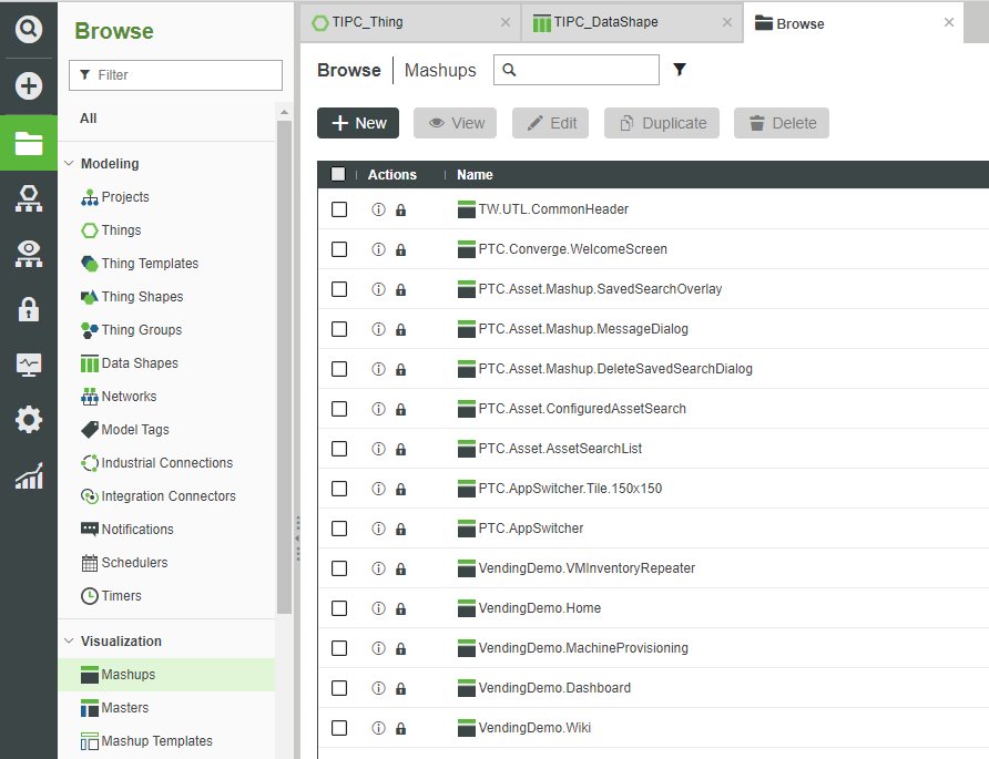

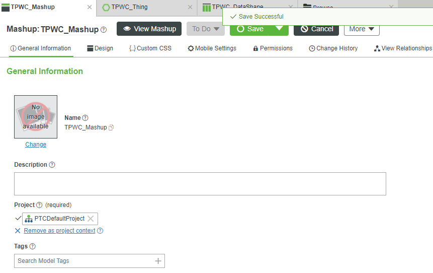

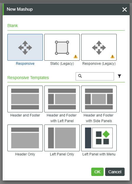

  1. Click Browse > Visualization > Mashups.
  2. Click + New.
  3. Leave the defaults and click OK.

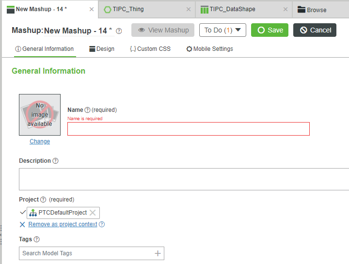

  4. In the Name field, type TPWC_Mashup.
  5. If Project is not already set, search for and select PTCDefaultProject.

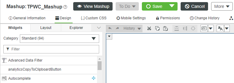

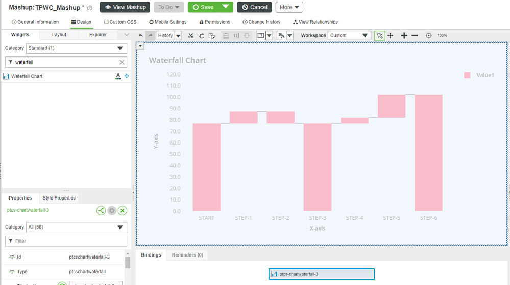

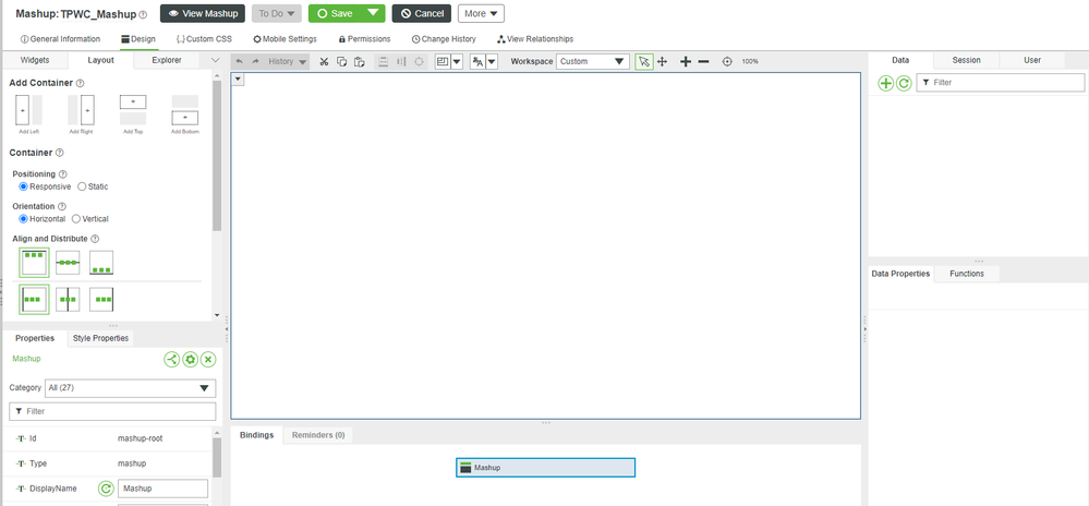

  7. At the top, click Design.
  8. At the top-left, click the Widgets tab.
  9. Drag-and-drop a Waterfall Chart Widget onto the central Canvas.
  10. At the top, click Save.
