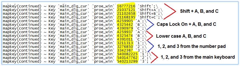

I am in the process of re-doing some of our mapkeys. It looks like in Creo 4 the mapkeys have gotten even more verbose than in Creo 3. Here is a thread on them in Creo 3:
https://community.ptc.com/t5/System-Administration/Creo-3-Mapkeys/td-p/166770
Now they look like this:
mapkey(continued) ~ Key `main_dlg_cur` `proe_win` 9 181 220 4259937 0 1421 922 1920 1200 \
mapkey(continued) 8262369 `A`;\
mapkey(continued) ~ Key `main_dlg_cur` `proe_win` 9 181 220 4325474 0 1421 922 1920 1200 \
mapkey(continued) 8262369 `B`;\
mapkey(continued) ~ Key `main_dlg_cur` `proe_win` 9 181 220 4391011 0 1421 922 1920 1200 \
mapkey(continued) 8262369 `C`;\
Has anyone deciphered if all of those extra codes are required? I tried deleting all except for the last 7 digit one but that didn't work. Is there an easier way to enter / edit text in a mapkey?
If not then I will probably resort to text from file just to keep the length of the mapkeys down and readable.

If you feel like manual editing, it seems like you can remove all the extra "common" numbers:
mapkey tom ~Activate `main_dlg_cur` `page_Annotate_control_btn` 1;\
mapkey(continued) ~ Command `ProCmdDtlInsFreeNote` ;@PAUSE_FOR_SCREEN_PICK;\
mapkey(continued) ~ Key `main_dlg_cur` `proe_win` 4259905 `A`;\
mapkey(continued) ~ Key `main_dlg_cur` `proe_win` 4325442 `B`;\
mapkey(continued) ~ Key `main_dlg_cur` `proe_win` 4390979 `C`;\
mapkey(continued) ~ Key `main_dlg_cur` `proe_win` 4259937 `A`;\
mapkey(continued) ~ Key `main_dlg_cur` `proe_win` 4325474 `B`;\
mapkey(continued) ~ Key `main_dlg_cur` `proe_win` 4391011 `C`;\
mapkey(continued) ~ Key `main_dlg_cur` `proe_win` 540082225 `1`;\
mapkey(continued) ~ Key `main_dlg_cur` `proe_win` 540147762 `2`;\
mapkey(continued) ~ Key `main_dlg_cur` `proe_win` 540213299 `3`;\
mapkey(continued) ~ Key `main_dlg_cur` `proe_win` 3211313 `1`;\
mapkey(continued) ~ Key `main_dlg_cur` `proe_win` 3276850 `2`;\
mapkey(continued) ~ Key `main_dlg_cur` `proe_win` 3342387 `3`;
Of course no guarantee this will continue to work with future version of Creo...

July 12, 2018
Yes, the codes are required.  The character displayed at the end is to help with readability.  It has no impact on the value actually used.  From my post here:
"Mapkeys are still editable, but the text they enter is not intuitive.  Each letter is represented by an 8 digit code.  This code is different for upper case, lower case, and where the number is entered (number pad or main keyboard area.)  The letter/number displayed after this code is NOT necessarily the character that will be entered.  (For example, the mapkey text will always show upper case characters even if the code is for entering a lower case character.  To change the text that is entered, you must change the 8 digit code.  Changing the displayed characters doesn’t do anything."
https://www.ptc.com/en/support/article?n=CS185955
https://community.ptc.com/t5/System-Administration/Text-edit-style-format-mapkey-in-Creo-3-0/m-p/290357
https://community.ptc.com/t5/Creo-Modeling-Questions/new-text-editor/m-p/239205#257971
