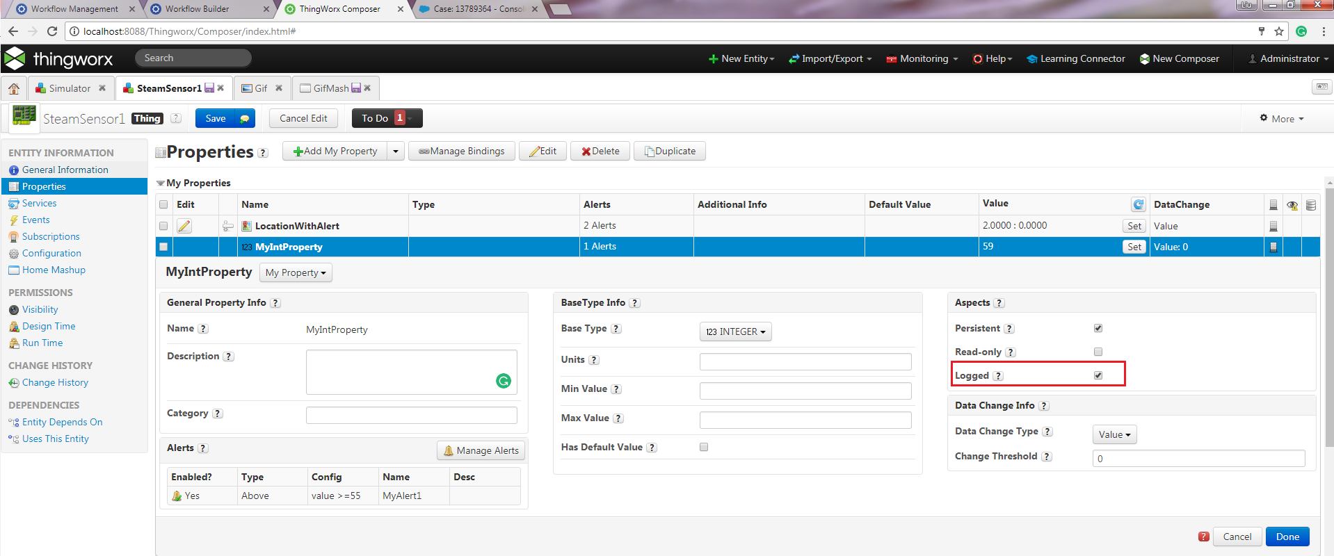

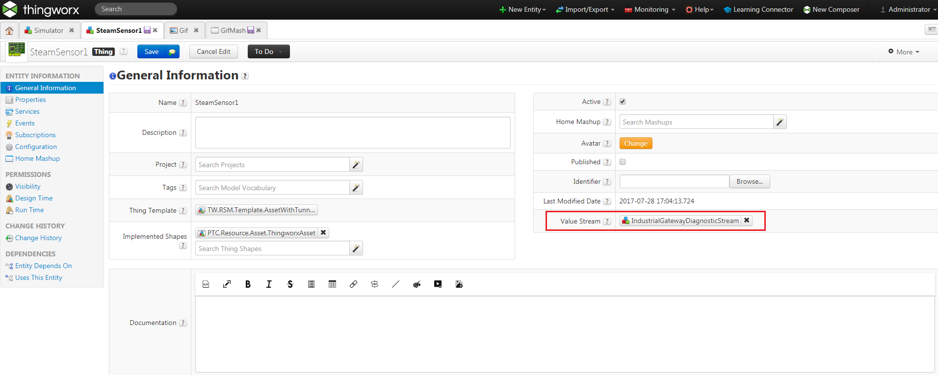

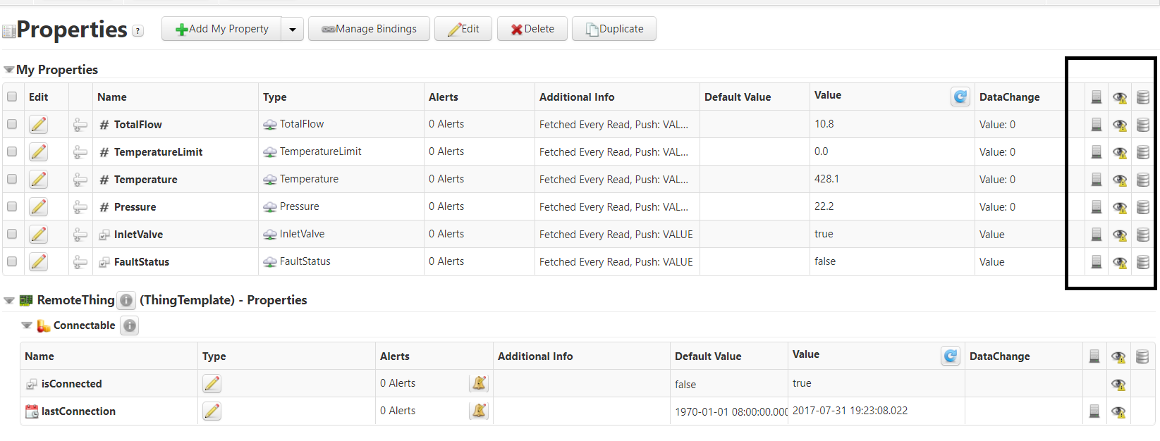

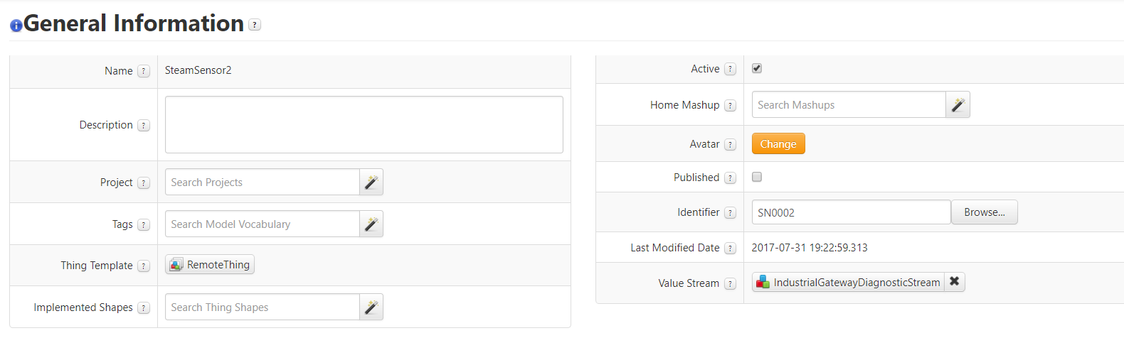

Hi Mahesh,
You can set your properties to be logged and bind a value stream to the thing. All data will be loggied in that value stream, which is saved on persistence provider (postgresql)
Run service QueryPropertyHistory, you can get all history data.

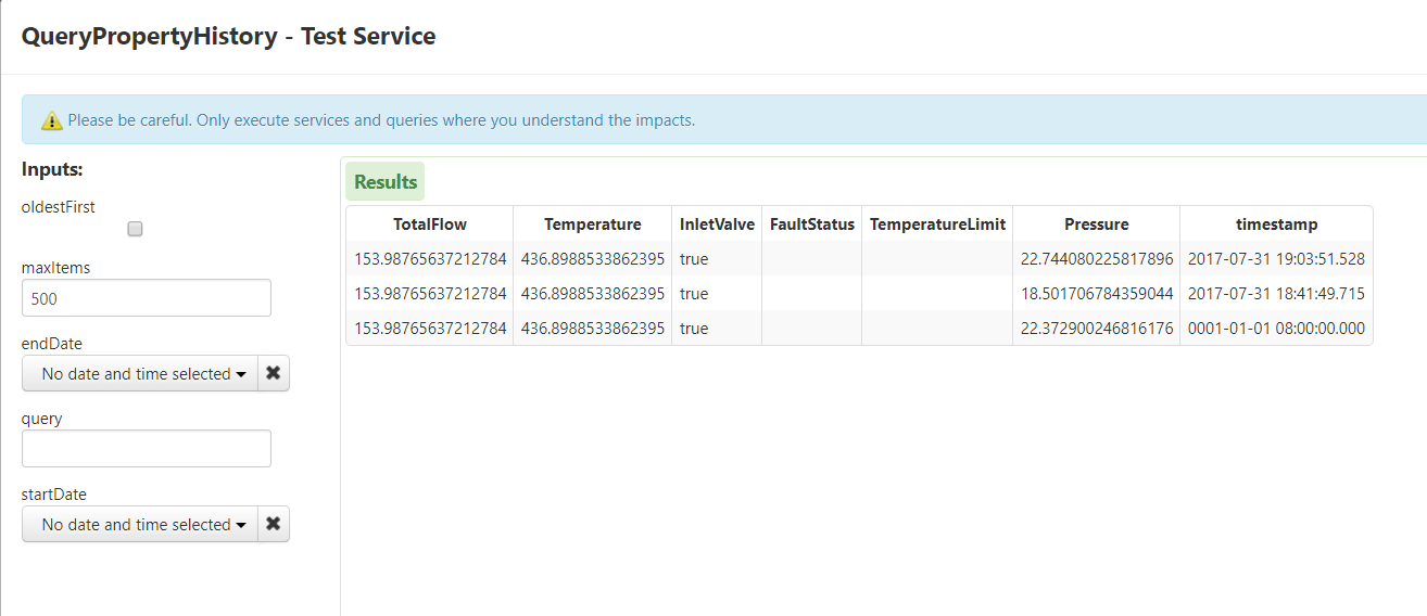

I have did the following steps
Now, when I start the .NET code and execute QueryPropertyHistory I get only 3 results. But .NET code send many records.

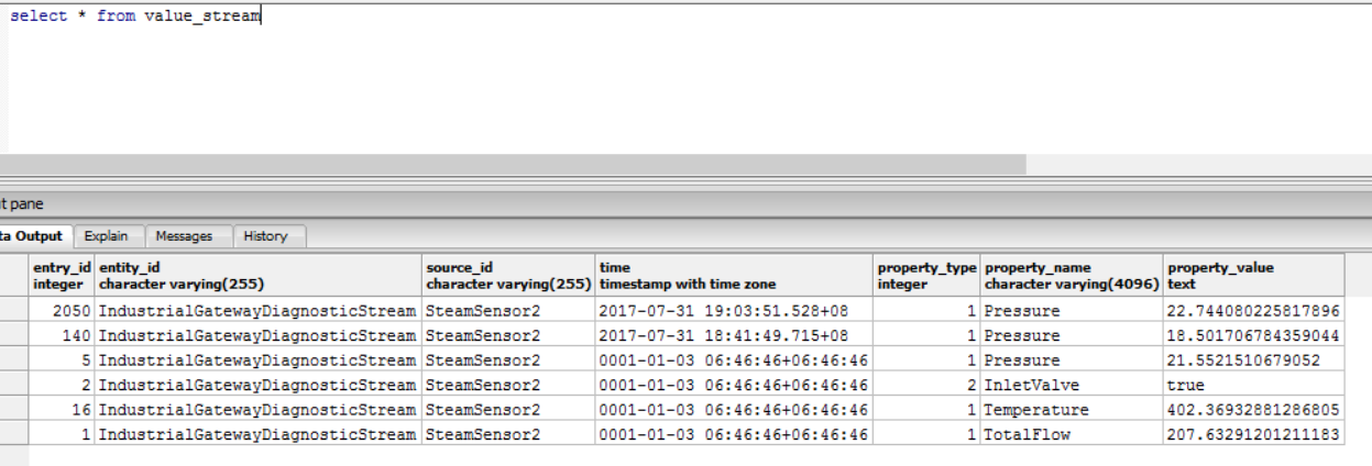

I also queries value_stream table in postgres. How can I retrieve all the records?

liliu5-Regular MemberAnswer
August 1, 2017
Hi Mashesh,
When you run "select * from value_stream", you actually get all saved data. If there are more data transfered from .net SDK, it means some data didn't transferred successfully.
